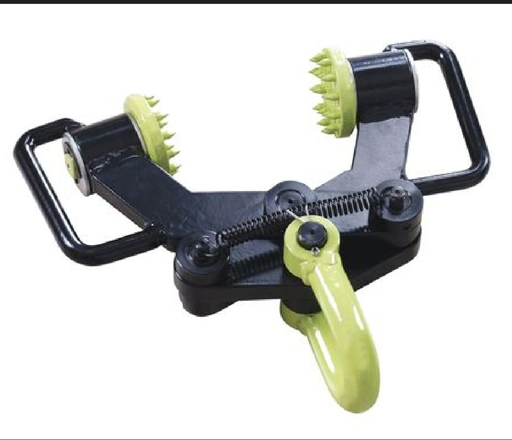

Ever tried one of these for small brush/trees?

I've looked at those type of devices but they are pricey. Honestly it's surprised me how small of a trunk I've been able to get my chain to pull out. Wrap the chain around the trunk twice, and lap over itself, so that it grabs better. My wife is usually on the tractor while I'm manning the chain, so that definitely makes it easier.

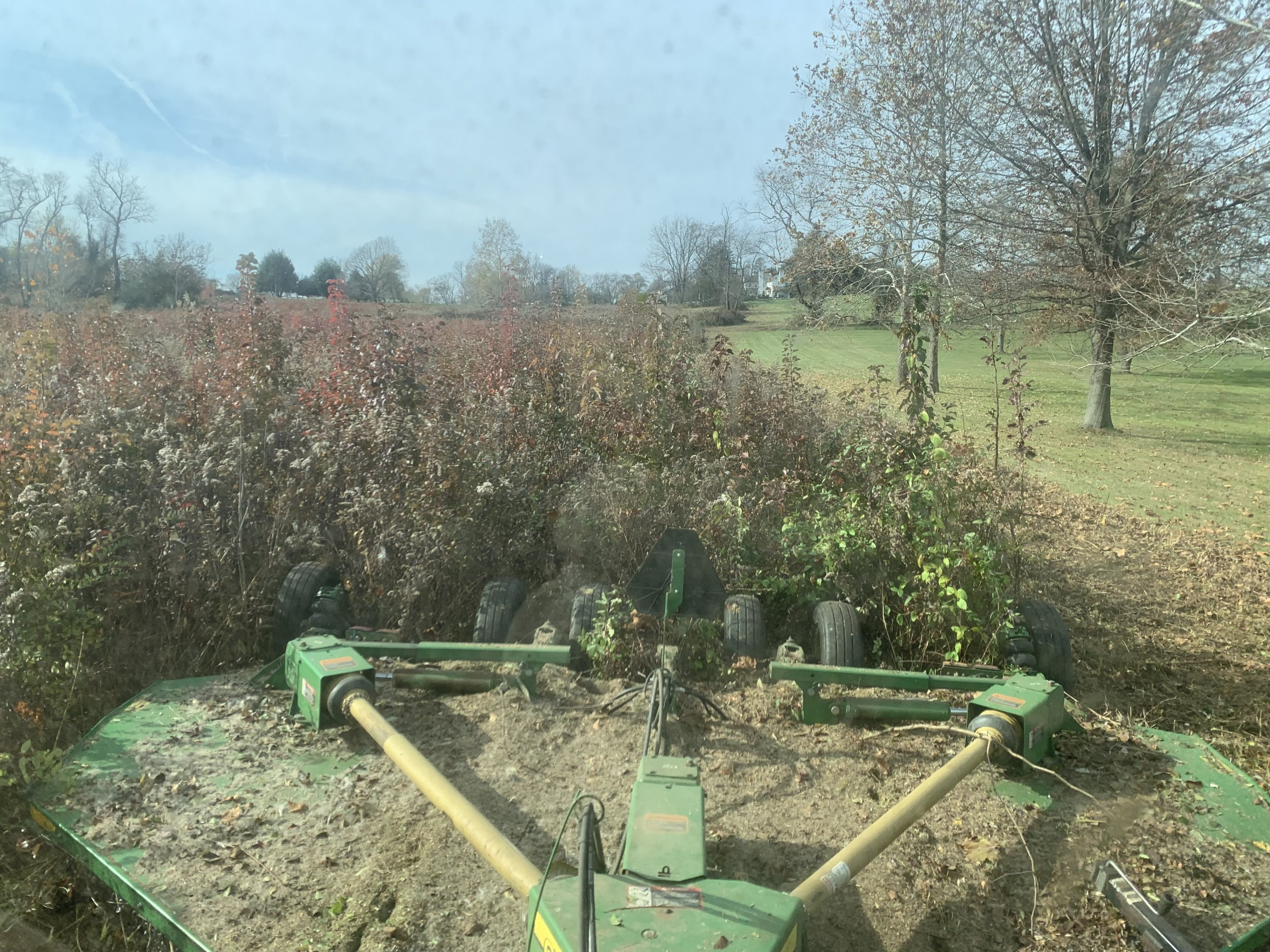

This has also worked well for me. I also use the scalping method where my bush hog is pretty much chopping dirt. Tough on blades, but they can be sharpened or replaced.
Here is a picture from 2021 where I cut thousands of 6’ pear trees down. After 3 well-timed cuttings in ‘21 & ‘22, they were 90% wiped out. There was no way to spray each individual little tree truck, unless you have an extra year to walk around with a spray bottle. :)

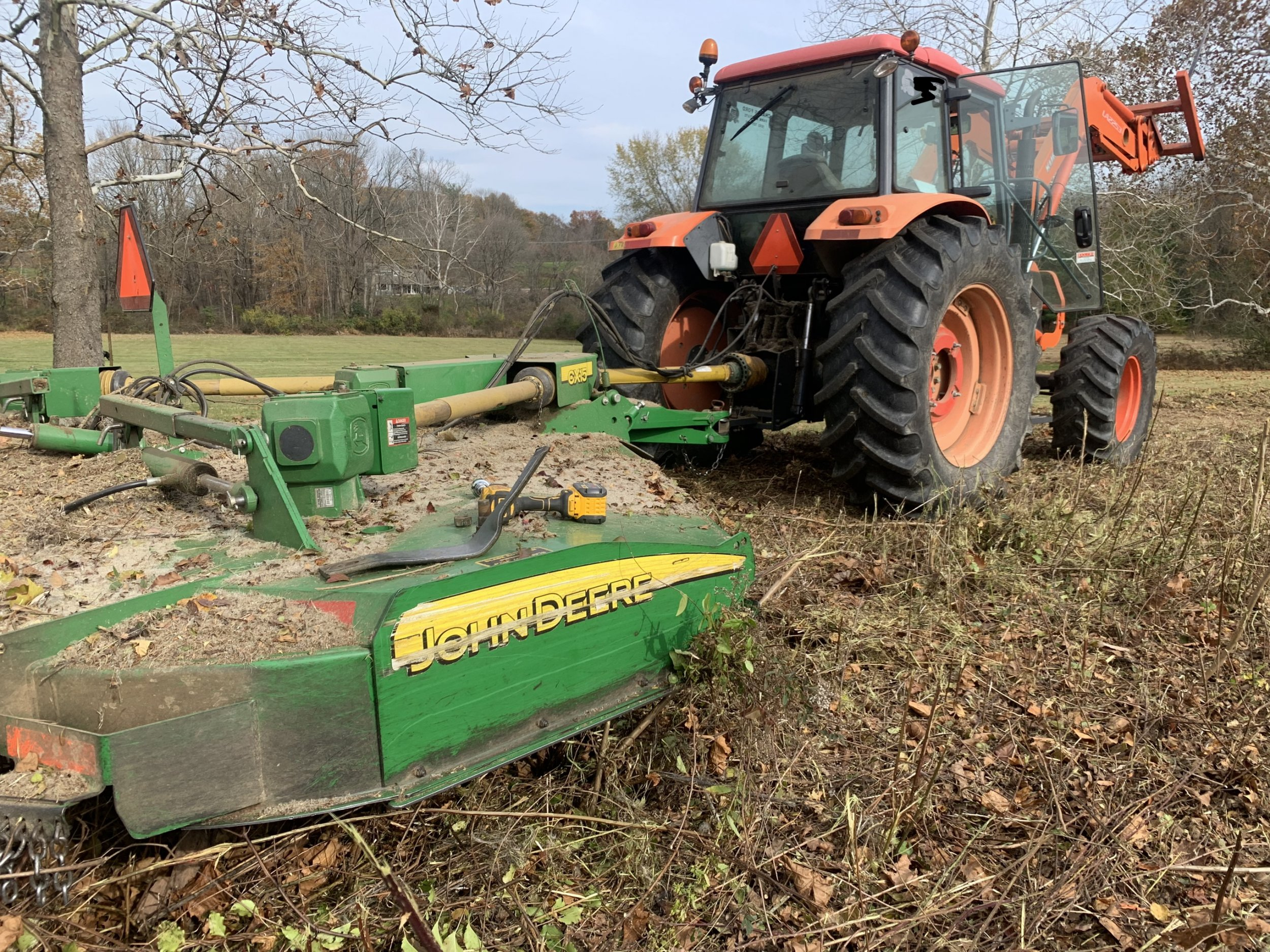

Hit a nasty boulder and bent a blade. Made a heck of a noise!

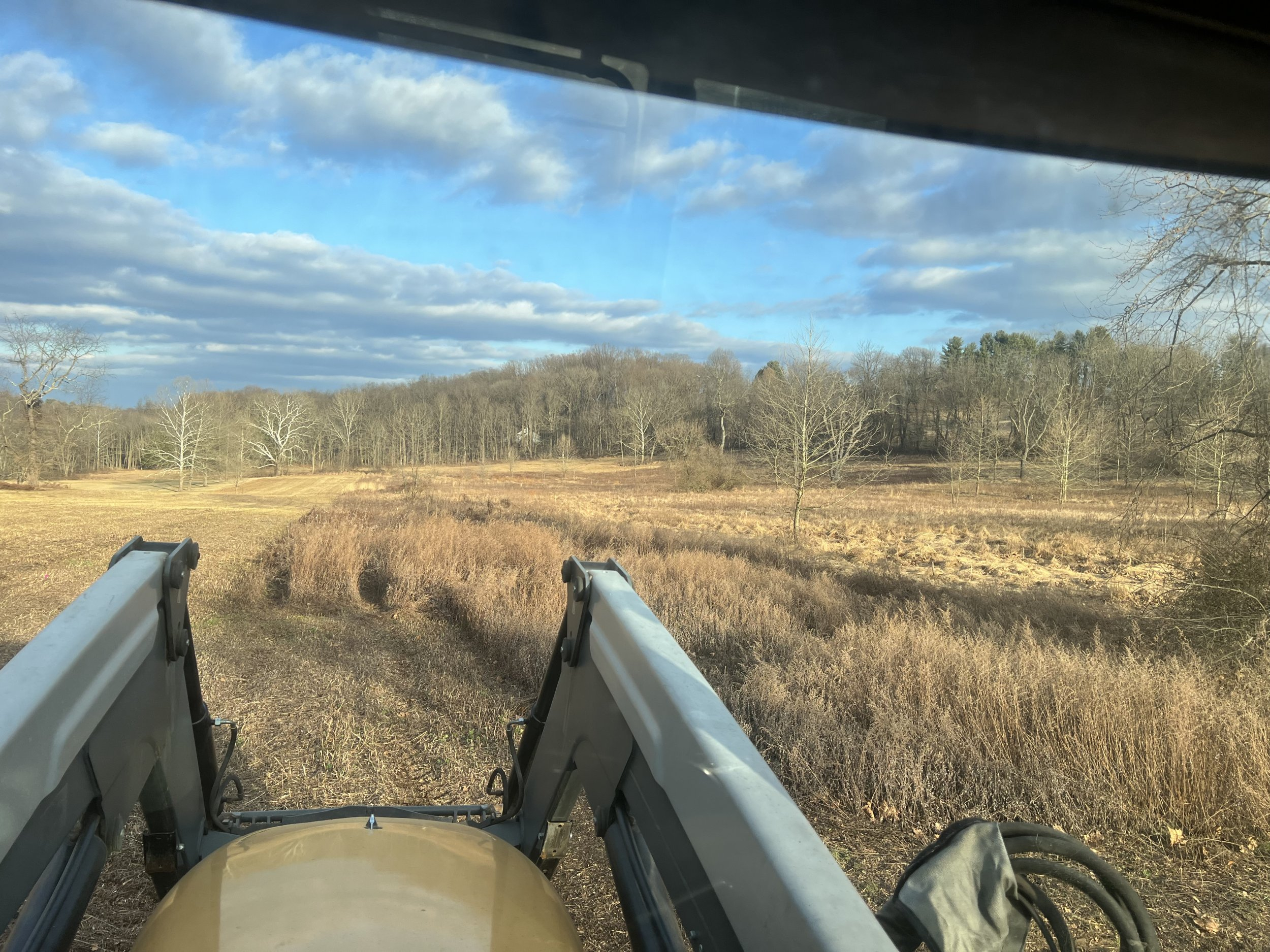

Now it’s pretty much just goldenrod :) lol
If the customer wanted to mow even more, it would turn back into grass.
They are just happy the callery pear invasion is pretty well over with.
I tend to think they would come again back if left go for a few years, so regular mowing is the only answer. If they increased the mowing to 4-5 times for a year or 2, grass would come back, but one of the group of owners likes goldenrod and wildflowers, so 2 mowings will probably allow that sort of growth. Looks very nice in late summer.
