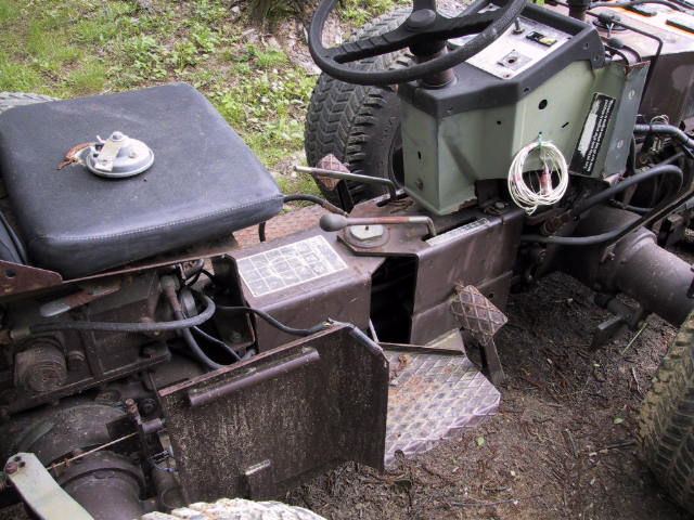

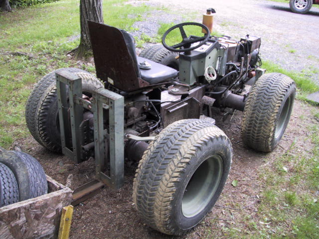

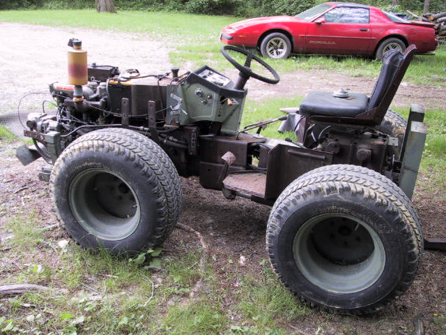

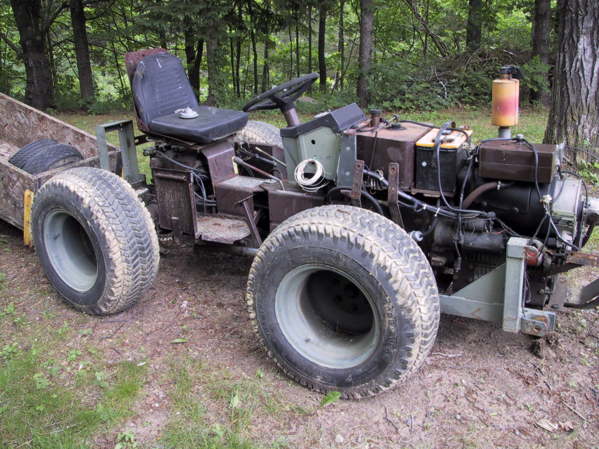

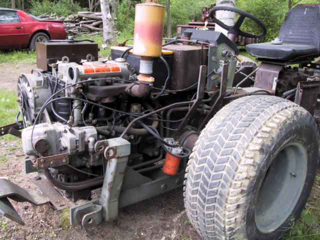

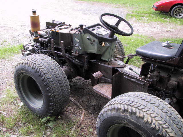

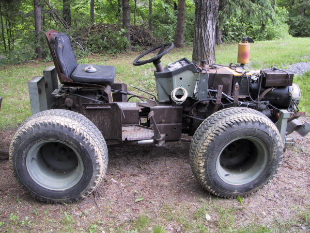

So this poor, unloved Pasquali followed me home. Says "D 38 Power Tug" on the dash. From what I have found, it was a military airplane tug. Hopefully it won't mind cutting grass and hauling maple sap.:D I'll try and document the process of getting it going again. It seems to have an injector hanging open, and a wheel seal is leaking, and parts are missing, and it seems to have been unloved. I'll see what I can do... :thumbsup:

Looks like a fun project , good luck ! She's lucky you took her in! :thumbsup:
/ New Pasquali owner #3
Ive got a 988 Pasquali, they run great, an air cooled diesel is the oddest thing but they are powerful. It looks odd without the sheetmetal on it. Theres a guy in NH that is the rep for USA for Pasqualis. He knows his stuff but it can take a LONG time getting parts from him.
Yes, it has the 3 cylinder Lombardini diesel. I've seen lots of duetz air cooled diesels, but this italian is the first i've seen. There is alot I haven't seen... :confused2: I have the fenders and hood and front headlight piece, but they are dented and rusty- savable, but unloved. Doesn't seem to be much use on the thing- note the uniform tire tread. Thanks for the replies!!

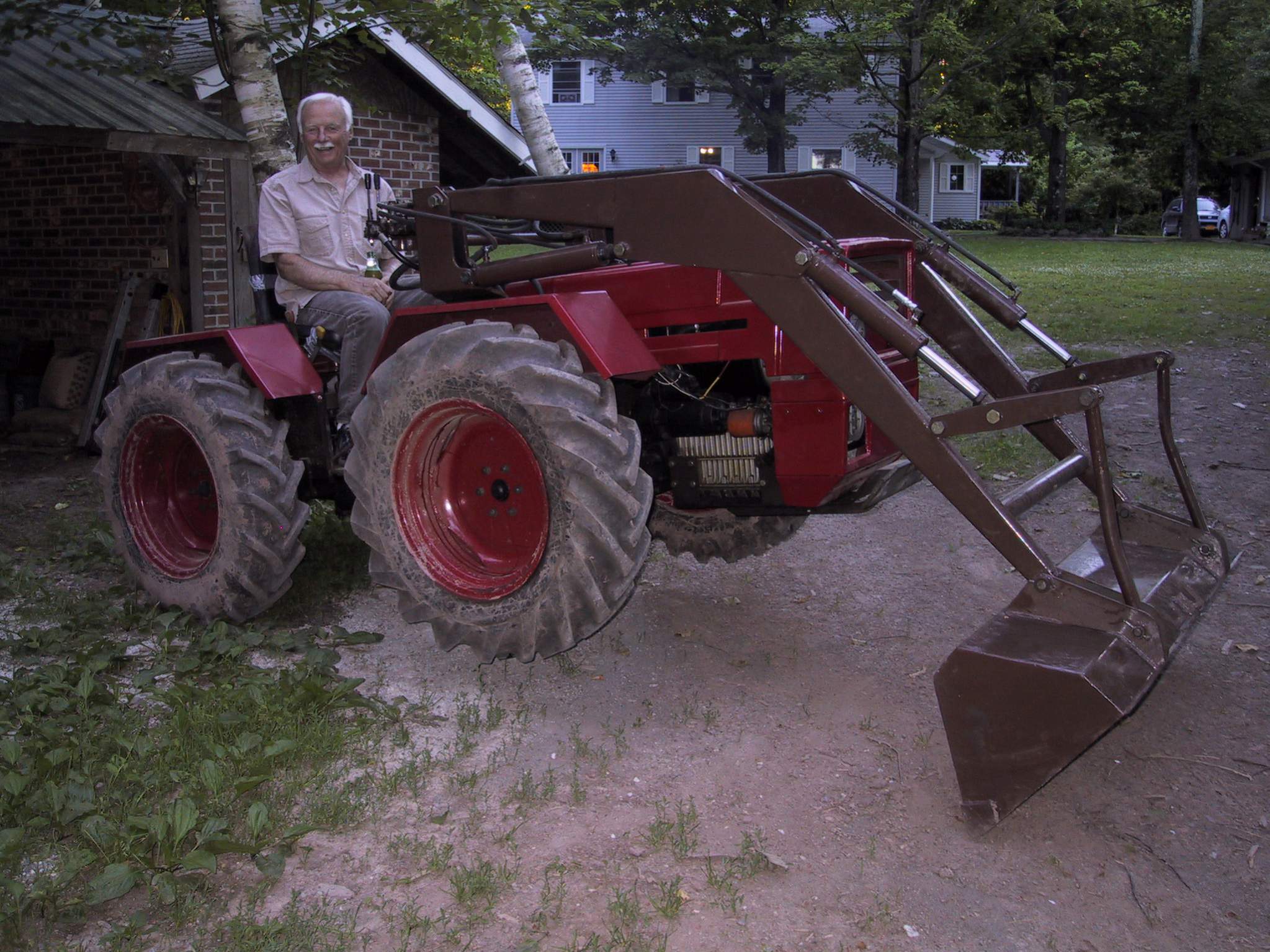

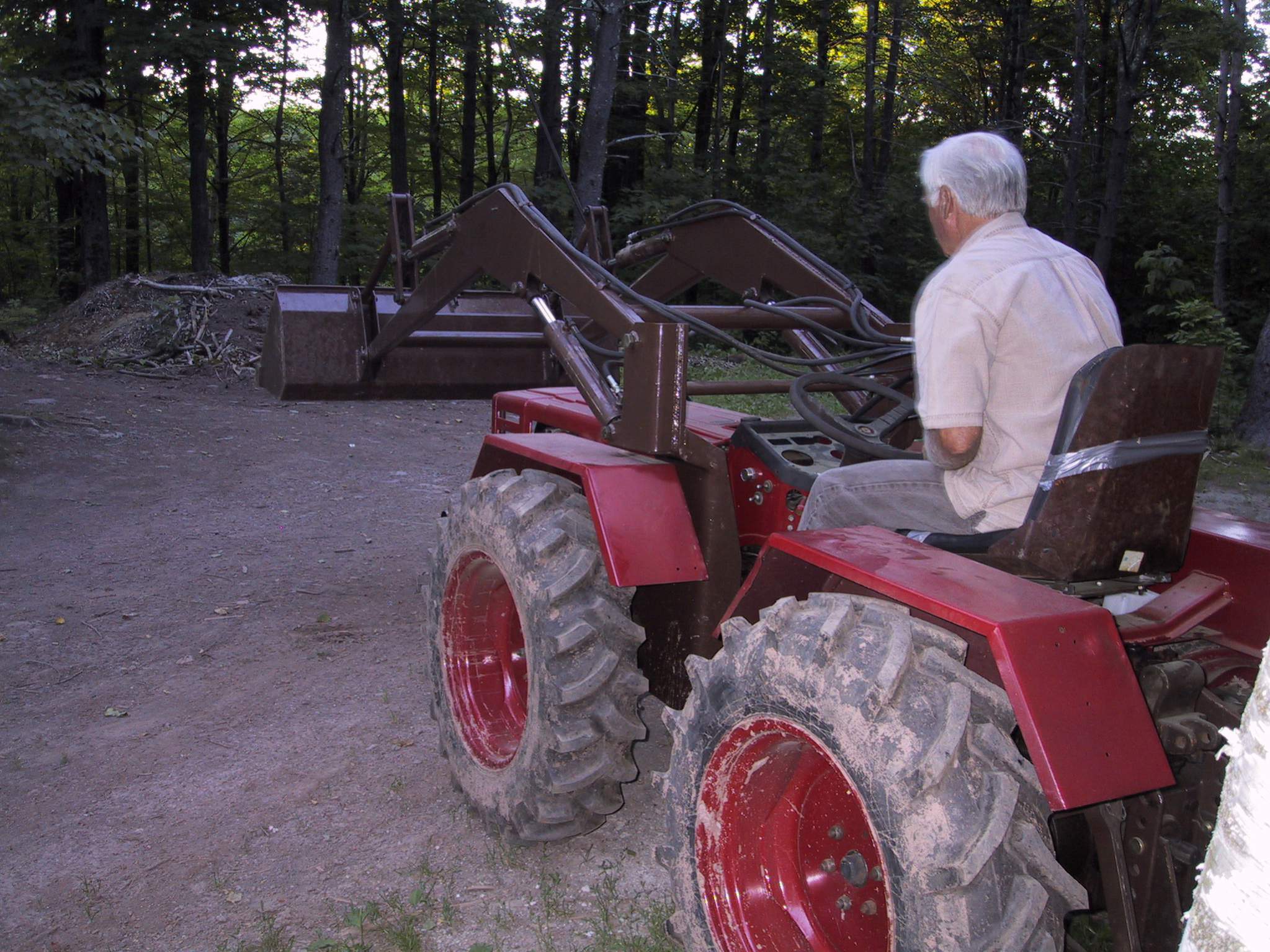

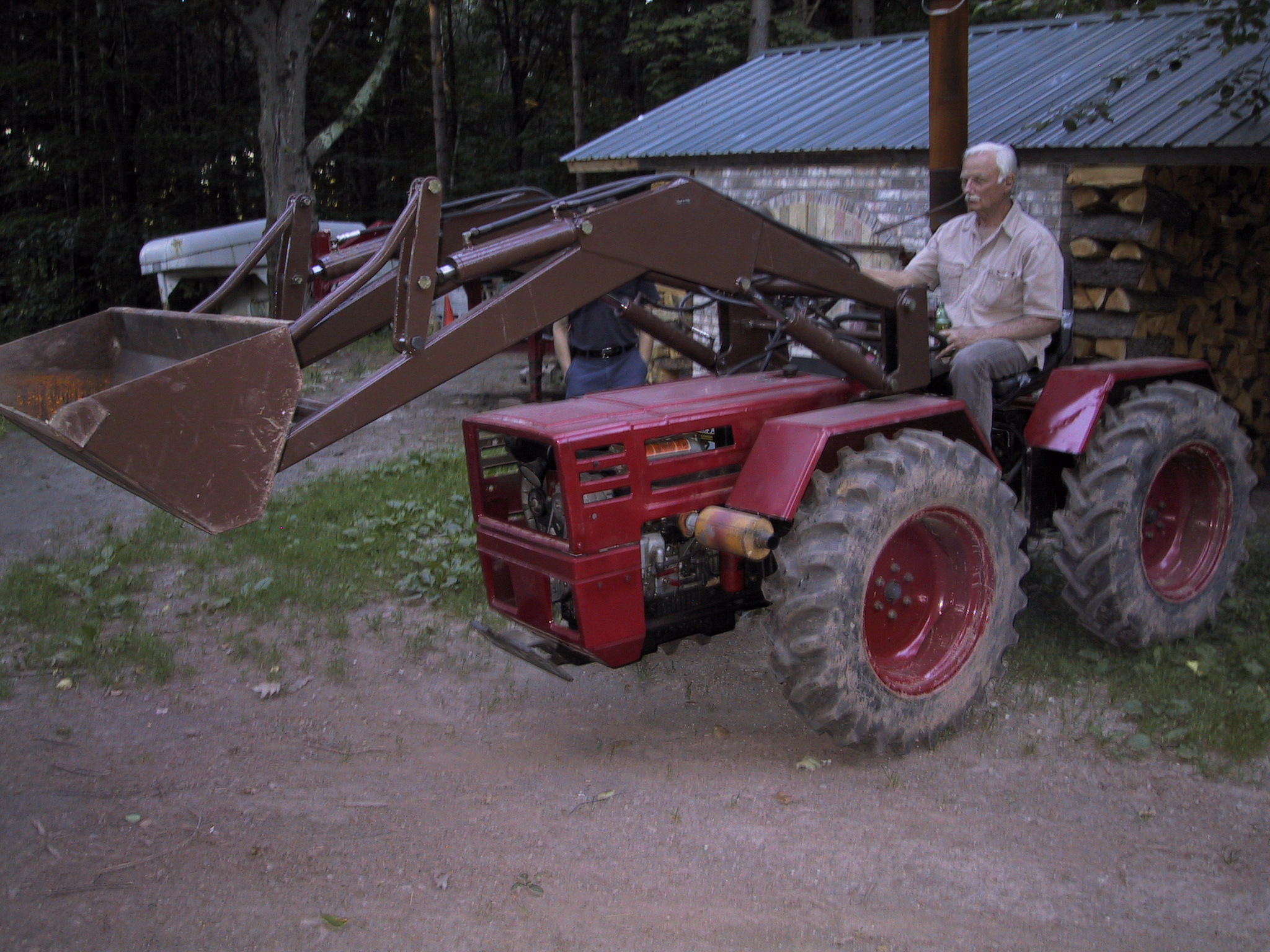

It has been a while, but progress has been made on our tractor! As the pictures show- it is ready for use!:cool2:
