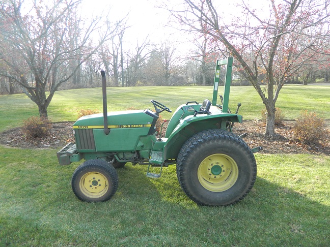

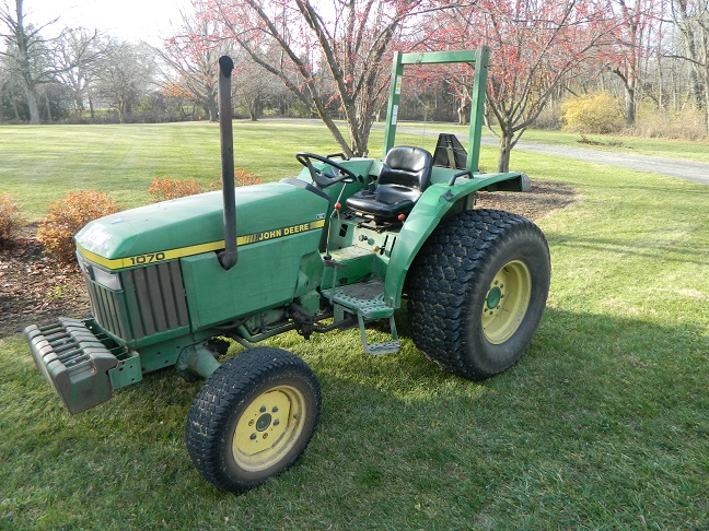

John Deere 1070
Wow. I've waited years for the opportunity to purchase a tractor. I really want a newer tractor with a hydro transmission, but my budget just doesn't support that. I've got just over 8 acres with about 5.5 of those in dense forest, along with a small stream and small pond. Maybe 0.5 acres in unmaintained grass...but it won't be unmaintained much longer as I also got a Woods 5ft brush cutter.
The tractor seems to run very well, even considering I believe it to have over 10,000 hours...I think it's a 1993 model year. It was used at a golf course for pulling a Lastec rough mower its entire life...that's been its only use since they bought it new. Ironically, I've spent hundreds of hours behind the wheel of a JD 1070 when I worked at a golf course throughout most of the 90's.
It needs lots of TLC, and I'm going to have to research the MFWD as it currently isn't functioning. Anyone have any experience troubleshooting the MFWD? Maybe it's just in the linkage as the lever isn't doing anything but going up and down at the moment...not engaging anything. I don't think it's been washed in a couple of years but luckily it has been stored inside most, if not all, of its life on a cement floor and acutally has very little rust.
I'm hoping to find a used loader, as that is really what I want a tractor for. I think the loader on the one at the golf course I worked at was a model 420. I know the model 80 also fits, any others? I just couldn't pass up this opportunity so hopefully a loader will surface some day. Hopefully I'll be able to tackle some of the issues in the near future and document them here. For now I need to change all fluids/filters and give it a good degreasing bath. I know everyone loves pics, so here are a couple right after I got it home.

Thanks for the warm welcomes and encouragement gentlemen. A tractor boneyard is exactly what I had in mind in regards to finding a loader for this tractor. A new one would be nice, but I just couldn't justify the cost. The tractor came with the operator's manual and parts manual, and another member already sent me a PDF of the tech manual...so I'm set as far as manuals go. I was looking at the tech manual a bit, and there is some great info on fixing some of the problems it has...main issues being sloppy steering and no MFWD. For the price I paid for the tractor I can afford to to fix the issues it has.
/ New Owner---JD 1070
Well, I was able to look at the MFWD as I pulled the tractor out to pressure wash it this morning. The diagnosis was pretty easy as to why it doesn't work...there is no drive shaft to the front axle. Hopefully the tractor was "high centered" at some point and the shaft was bent and simply removed instead of fixing it.

I did some preliminary testing and the gears in the front axle seem to work. I put the tractor in nuetral and when spinning the shaft by hand for the front axle the tractor moved forward. Likewise, when I disengage the MFWD with lever by the seat, the output shaft spins freely, and when I engage the lever the shaft only spins with movement of the rear wheels. I'm crossing my fingers that I only need the shaft and no internal parts are trashed.
