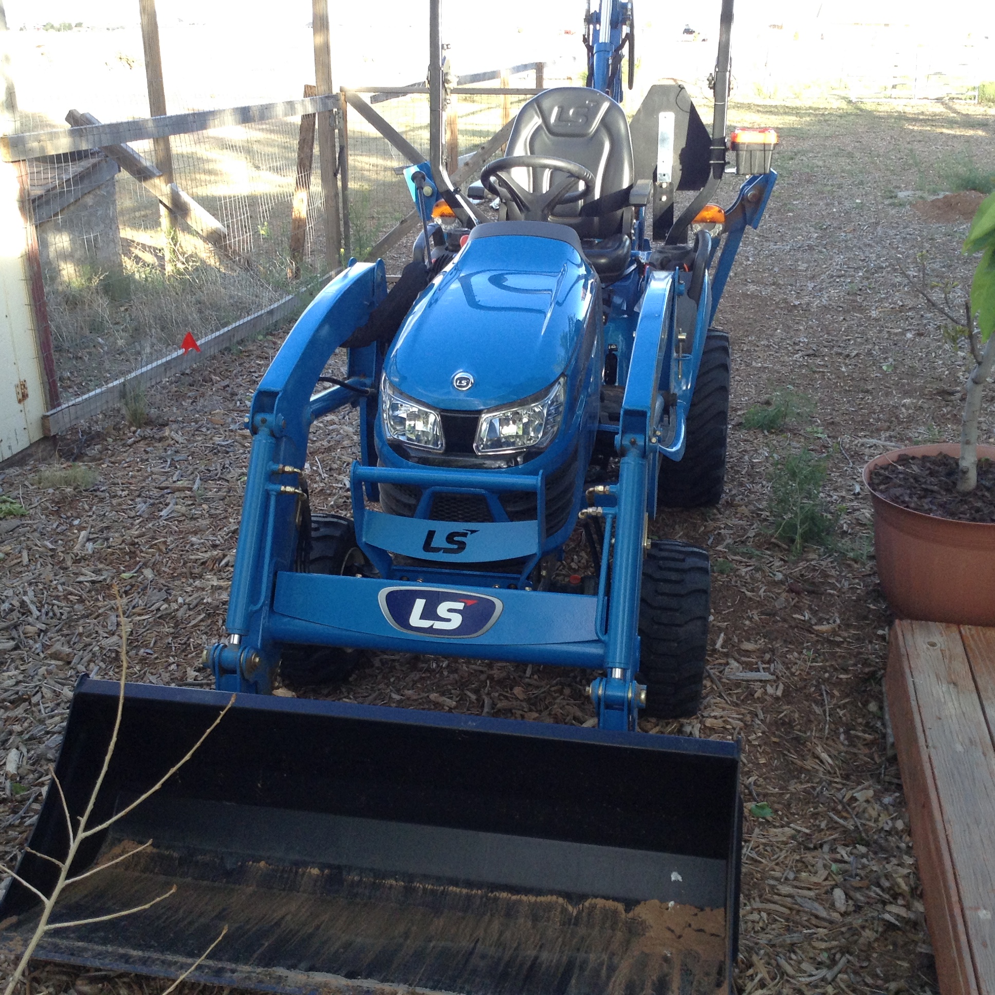

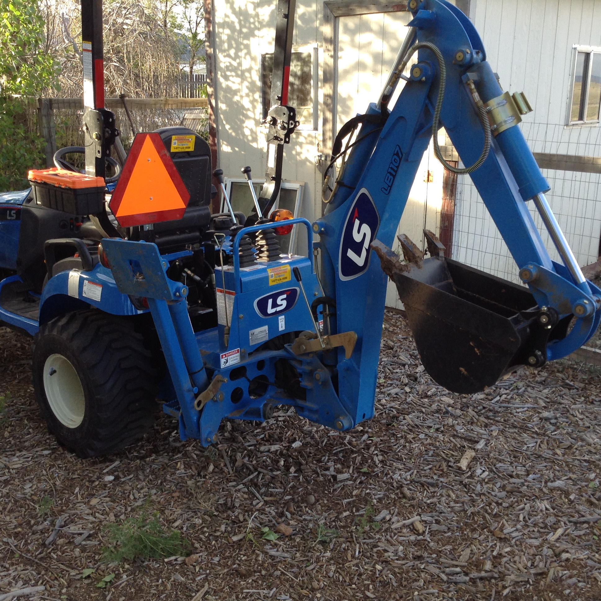

I am impressed by this new scut tractor. Already dug a hole for a new septic tank (6'deep, 6'wide, 10' long) w/o any difficulty in hard clay. Quick detach loader, quick detach backhoe, 4wd, 2 range hydro, the list goes on and on. If anyone was contemplating one of these new scuts, go for it! I posted the price in the LS pricing forum. :D

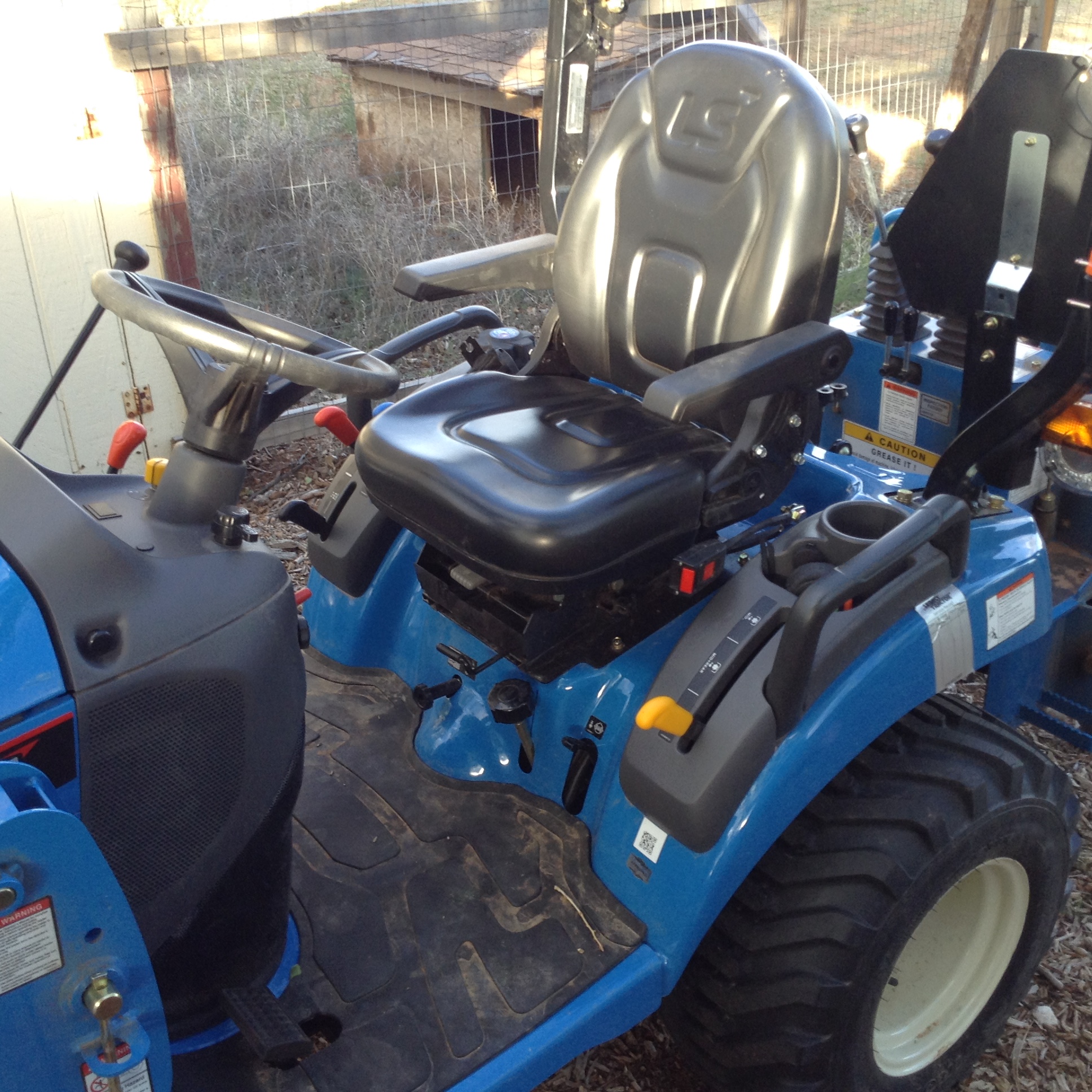

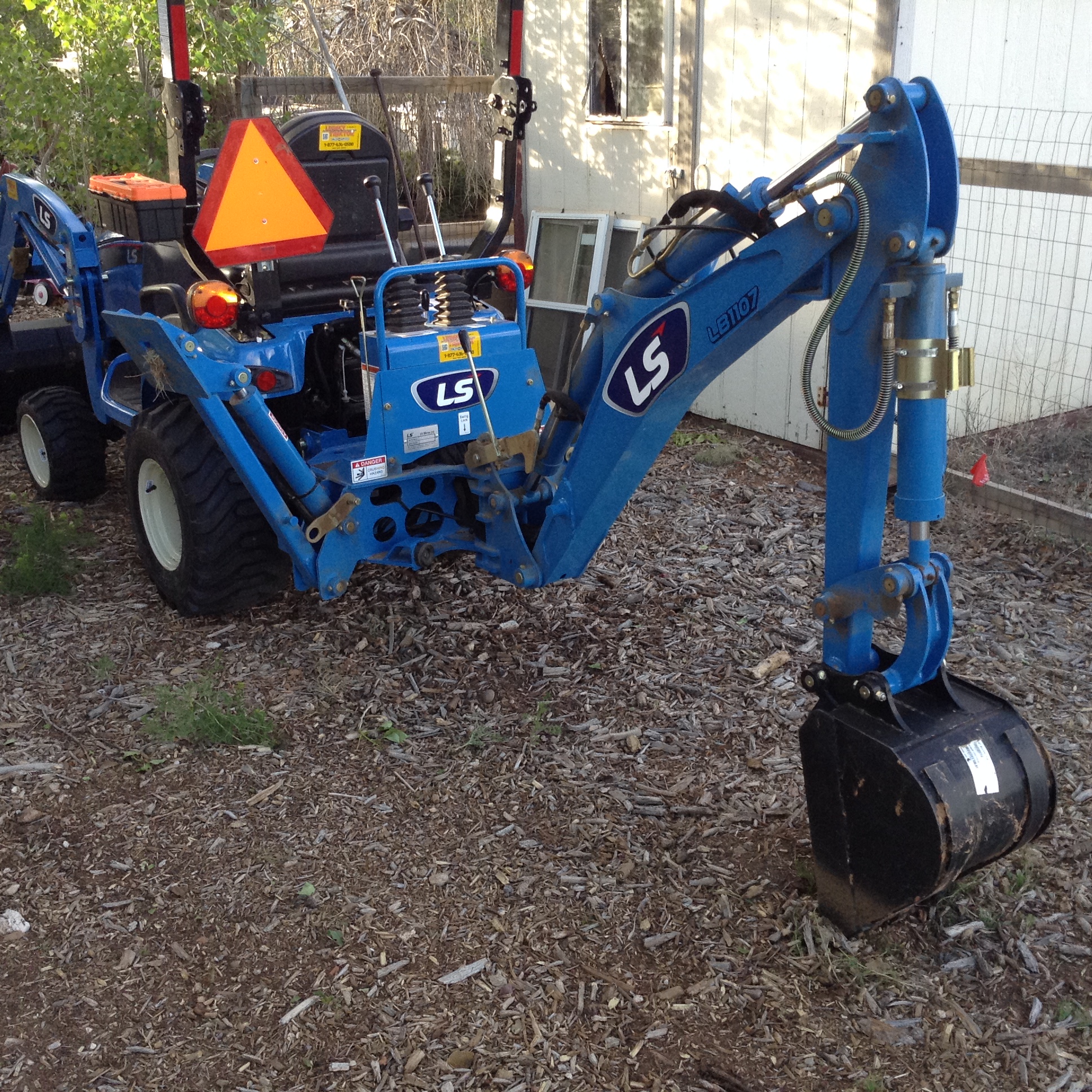

I did not get a mower with this beast. (I have another dedicated mower). So far just TLB and a post hole digger. Did get 12" BH bucket and larger 9" PH auger. If hindsight was wonderful, I would have definitely gotten the mower so I could have financed it at a reduced price. So far I have dug a hole with the backhoe that was 6'w, 6'd, and 10' long in hard clay without difficulty. I then moved the pile of dirt (and I mean PILE of dirt) and the loader made quick work of it! Plenty of power in 4wd low range. Here are some pics.

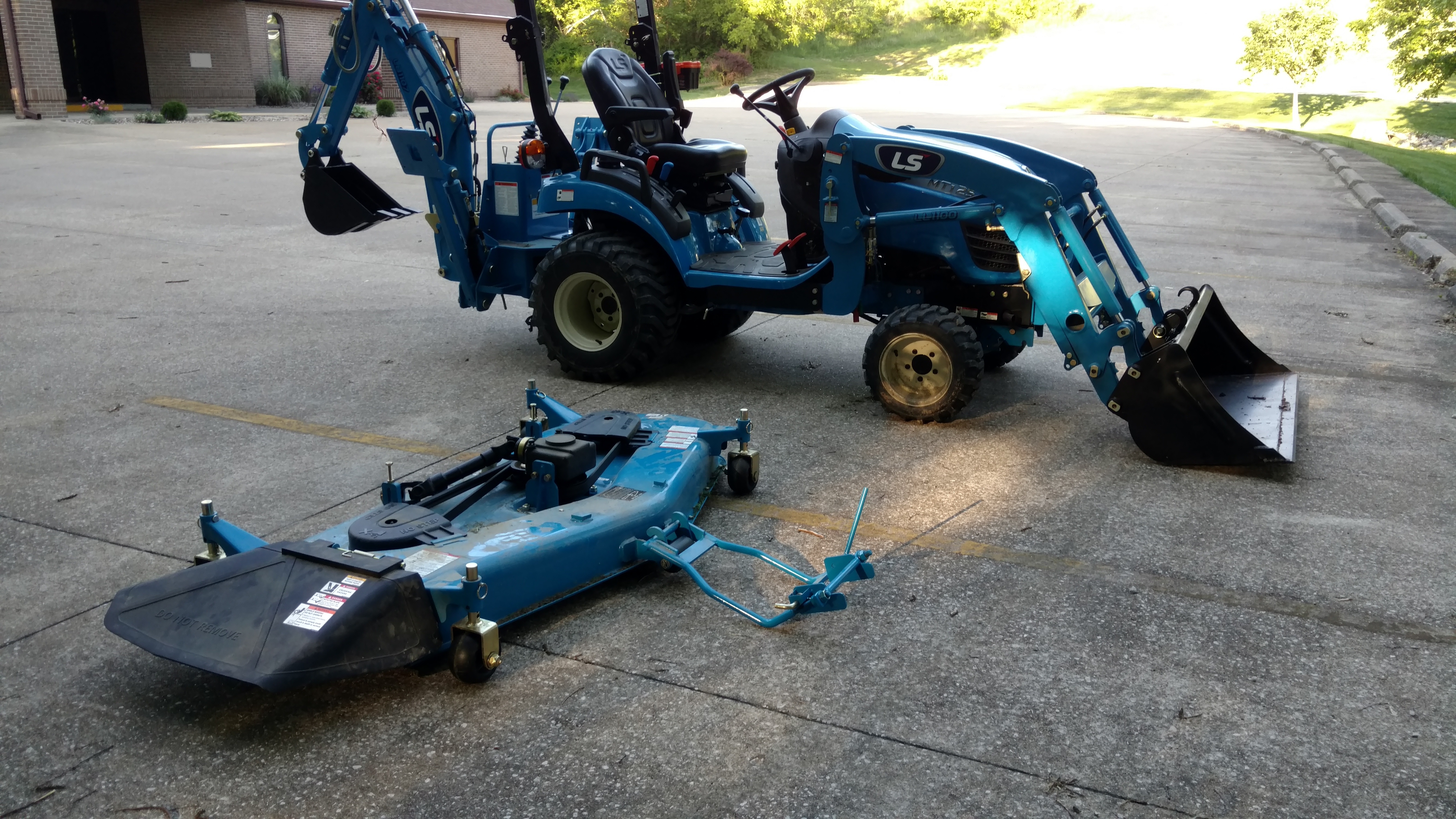

Have you removed the BH or FEL yet? I watched a video on the removal of the mower from a BX and this was similar. Now I will have to see about putting it back on.

Yes I have. The fel comes off real easy, just like a JD quich attach on the 1family series. The support legs on the loader arms makes it a piece of cake. The backhoe comes off just as easy, pull a couple of pins, the hoses and off it comes. I was reading here that people said you have to take off a tire to remove the hoe, but that is not true. It just takes a bit more time than the fel because you use the hydraulics to adjust the positioning more. Send some more pics when you get the time. I am still very impressed with this little tractor. I made a " sun shade" canopy using electrical conduit and shade cloth from HD, cost $35. Covers both the forward facing and BH seating position. I'm gonna try to post some pics under " build it yourself" this week. Enjoy that new toy!

I have found that taking the mower on and off is the most work. BH and FEL are very easy. The first time I took off the BH I did not put anything under it and it sank to the ground, but it was not a problem getting it back on as the hoses were long enough.

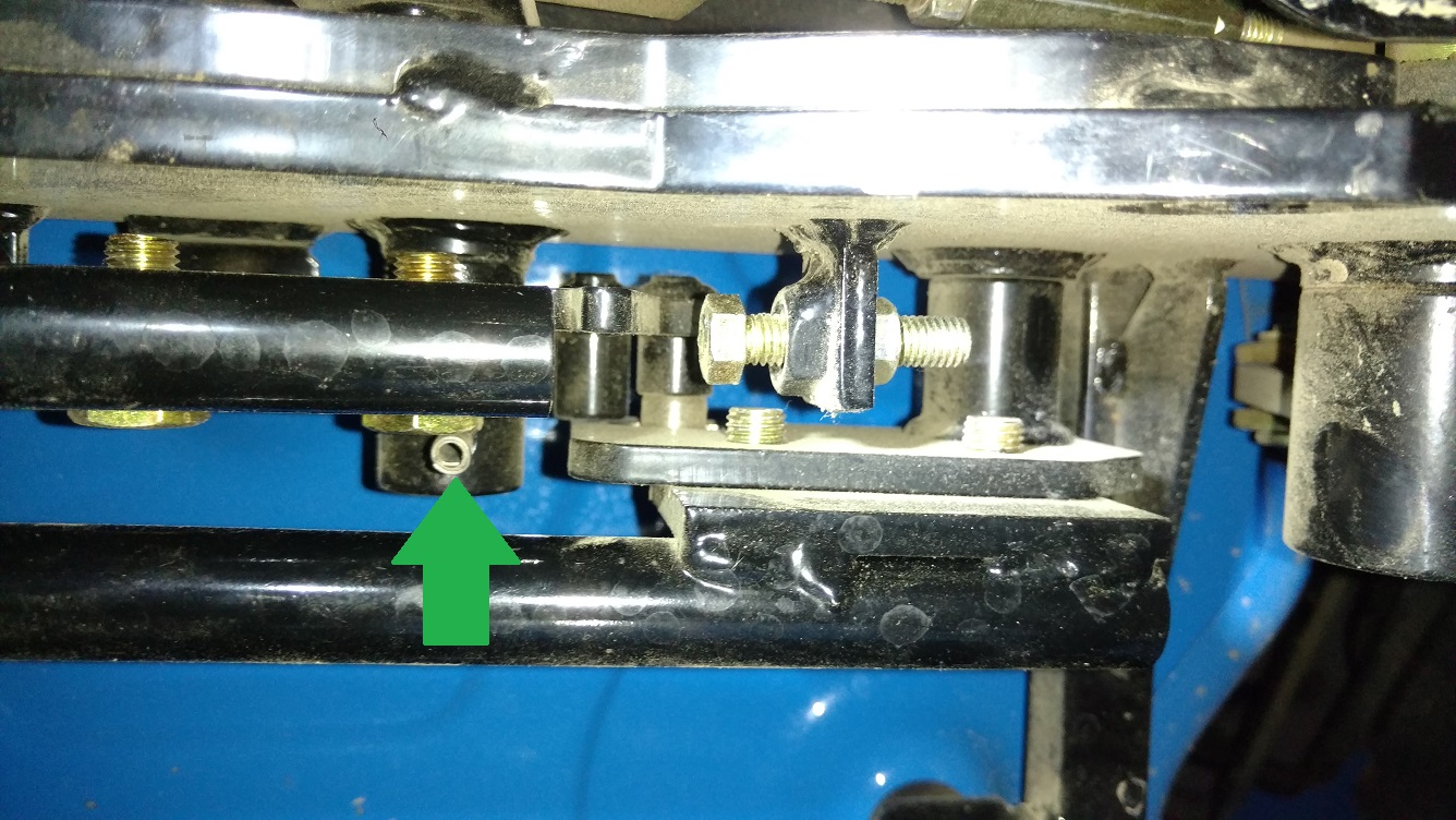

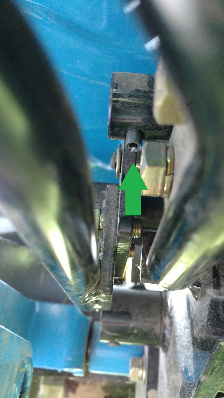

So my pedals actually went totally slack. They would not engage the drive at all. The mechanic came out and was not here for long.
It turns out that this pin in the linkage between the pedals and that connector rod had worked loose. I was not there to see the fix,
but I have before and after pictures. I think he just hammered it back in. Now the pedals actually engage the drive again and the tractor is back to normal and working hard again!
Before
/ New MT 125h owner! #16
Glad it was an easy fix.
If that pin goes all the way through that shaft, you can run a piece of wire through it and twist the two ends together on the side of the shaft to prevent the pin from coming out again.
