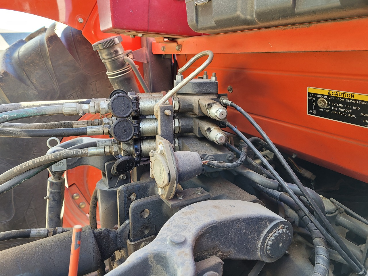

A couple thoughts.
The single valve that comes standard on the tractor is a self canceling valve. It requires significant force to set the lever in the self canceling mode. It feels similar to a detent. It's on both ends of the lever movement. If the lever isn't set into the self canceling detent hydraulic movement is minimal and seemingly powerless. The single standard equipment valve should be in the lower position of the stack.
The 2nd optional valve is normally a float valve. Detent/float on the lower/forward position of the lever.
The 3rd optional valve is normally a float valve. Detent/float on the lower/forward position of the lever.
Another option is a "flow control valve". It would be in the stack, in your case, between the 2nd and 3rd valves. It has a knob adjuster and does just what the name implies. It restricts the flow in the 3rd valve. If it is partially closed it will considerably slow flow. If almost completely closed will cause relief valve squealing. Will all have a dramatic affect on the function of the lever because you're pushing against an almost dead system.
I'm attaching a pic that might/might not be helpful.
Notice the difference in valve design between the bottom one which is self canceling and the next two up which are detent valves. This might help you confirm that yours are assembled in the right order. I added mine myself. In the instructions it was adamant about order of the stack.
Also notice I do not have a "flow control valve" between the top two valves.

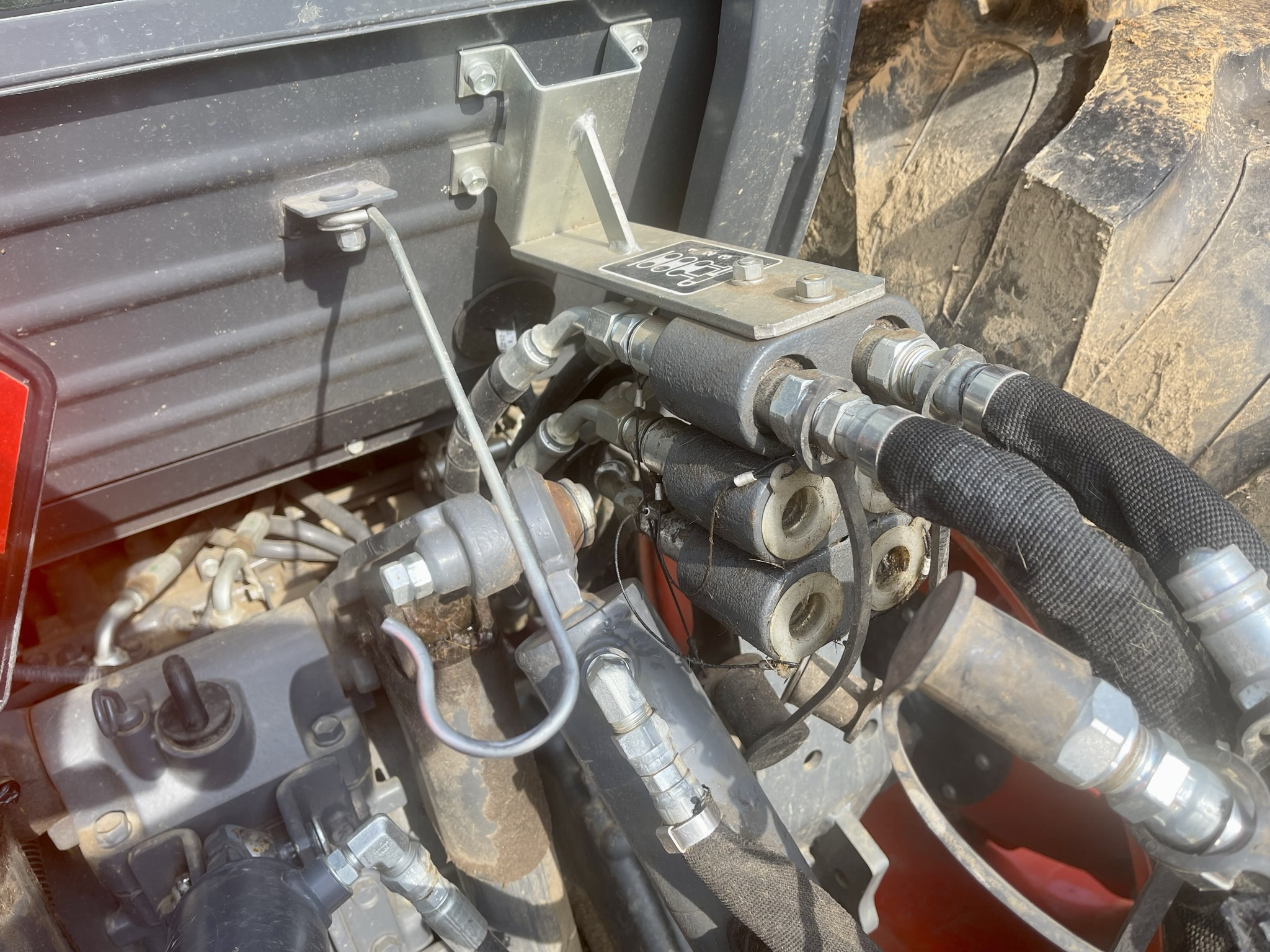

On the rear of the tractor the "stack" of valves and couplers that your levers are connected to.
Exactly, however, I also have a flow control valve under the top remote because I use the top remote to drive my grain leg (hydraulic motor) and my post pounder too. The flow control valve allows me to regulate the fluid flow and change the speed of the hydraulic motor on the gran leg and the cycle time of the post pounder. Kubota has a flow control valve but I believe it's a dealer installed item.

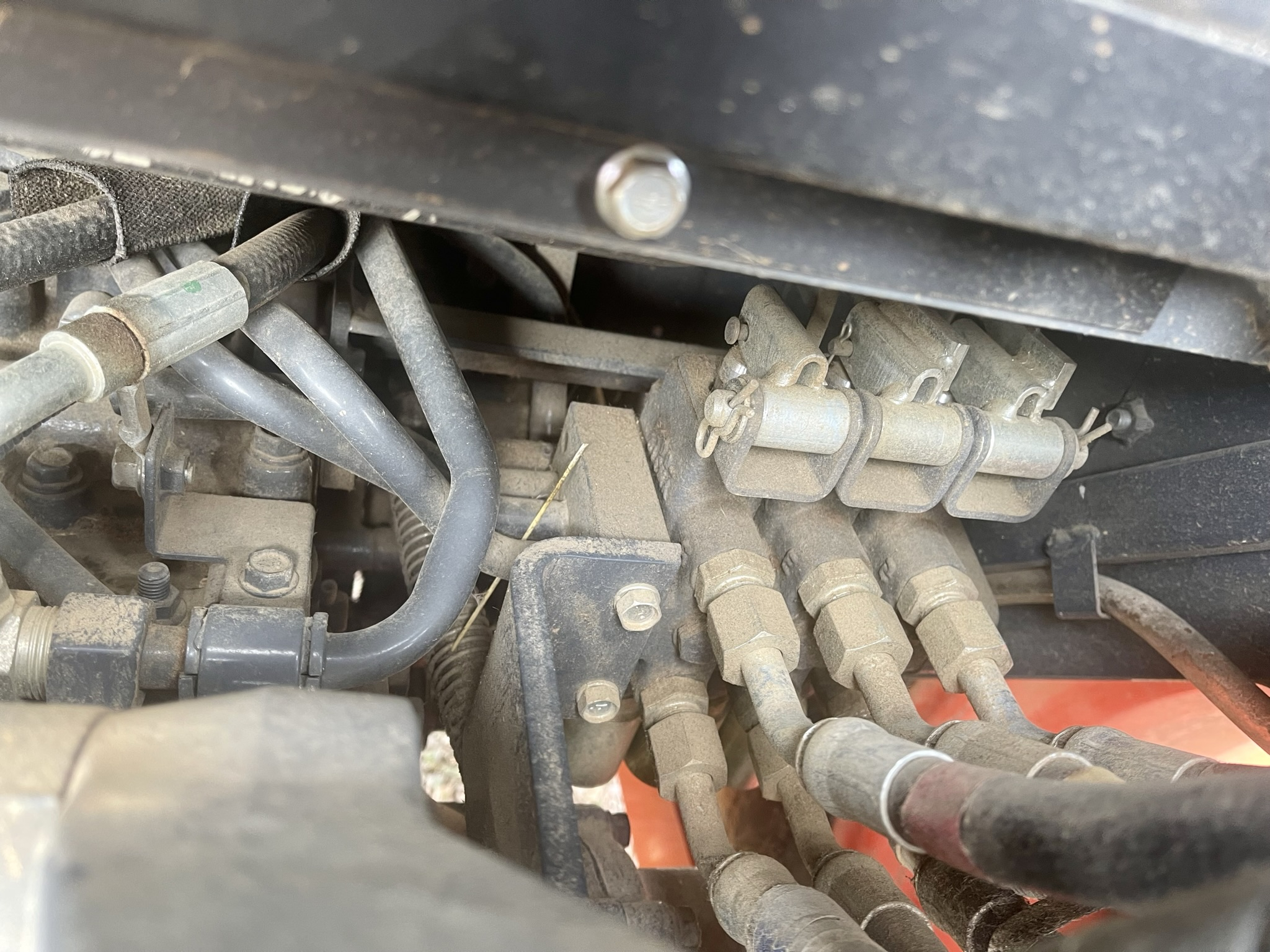

I have an L6060 (3.5 years old now) with 3/all float valves. All three valves have the float detent when pushing the lever forward. Each moves easily forward and reverse, and don't take much force to go into float mode either, but enough you don't accidentally float when you don't mean to (maybe once or twice ever for me).
Depending on how the tractor was acquired, valves could have been factory or dealer installed. In my example, I ordered with 3 floats. The dealer was able to transfer it from another dealer still in the shipping crate so I didn't have to wait on factory build. I tested it after getting home and found only remotes 2/3 were float and 1 was not. Dealer tech told me that's how it is and that you couldn't have a float in #1. I argued, and they took it back and replaced it. Kind of frustrating they didn't actually replace what was there, even though I paid extra for the floats, until I raised a stink about it.
Also, all three remotes leak down over time. I see it in my top and tilt kit, especially with heavy attachments. I can't leave the tilt cylinder connected with my 8' 3 point brushhog. It will drop down in 15-20 minutes or less. I can set the angle I want and disconnect (As you see in the picture below) and it holds fine. The dealer took it back, replaced a couple remotes and had the same issue. They tested another L6060 and saw the same thing. I never did get a fix other than disconnect.
The remotes on the Grand L are different than the M. The outlets are remote from the valves. Check and be sure hoses are connected correctly. You can fairly easily remove the plastic cover over the levers to see linkages and check those as well. (I put in a new radio, speakers, and powered subwoofer under the air ride seat, so i've taken those apart a few times, haha). Let me know if you need any other pictures or info, and I'll do my best to get what I can. :)
