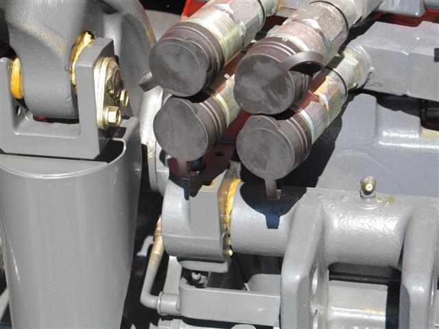

Up until now I couldn't really see the utility in 3 remotes. I am definitely interested in eventually setting up a top 'n' tilt system. Besides, I have always been into overkill. The more remotes, the better. In fact, I think I want MORE than 3 remotes!! I have checked out and researched some tractors. Now I think I will get a New Holland TJ530. I would get the optional megaflow hydraulics and optional rear remotes. Let's see. . .9 rear remotes, 94 GPM hydraulic flow rate, and 530 hp!! I think that should do it.;) Talk about overkill. That's one for you horsepower junkies!!
Seriously though, I would like 3 sets of remotes. The tractor I have been looking at on my Kubota dealers' lot only has 2. It's a Kubota M8540. I can see where a 3rd would be on the block. I just hope that this is an aftermarket option that can be added by the dealer and not a factory option. Anyone know? I may need to ask on the Kubota forum.

   / 3 Rear Remotes: Worth It?? #27
I can't imagine a tractor like that not being able to have more than 2 remotes that can be installed by the dealed. However, I do not know for certain.
