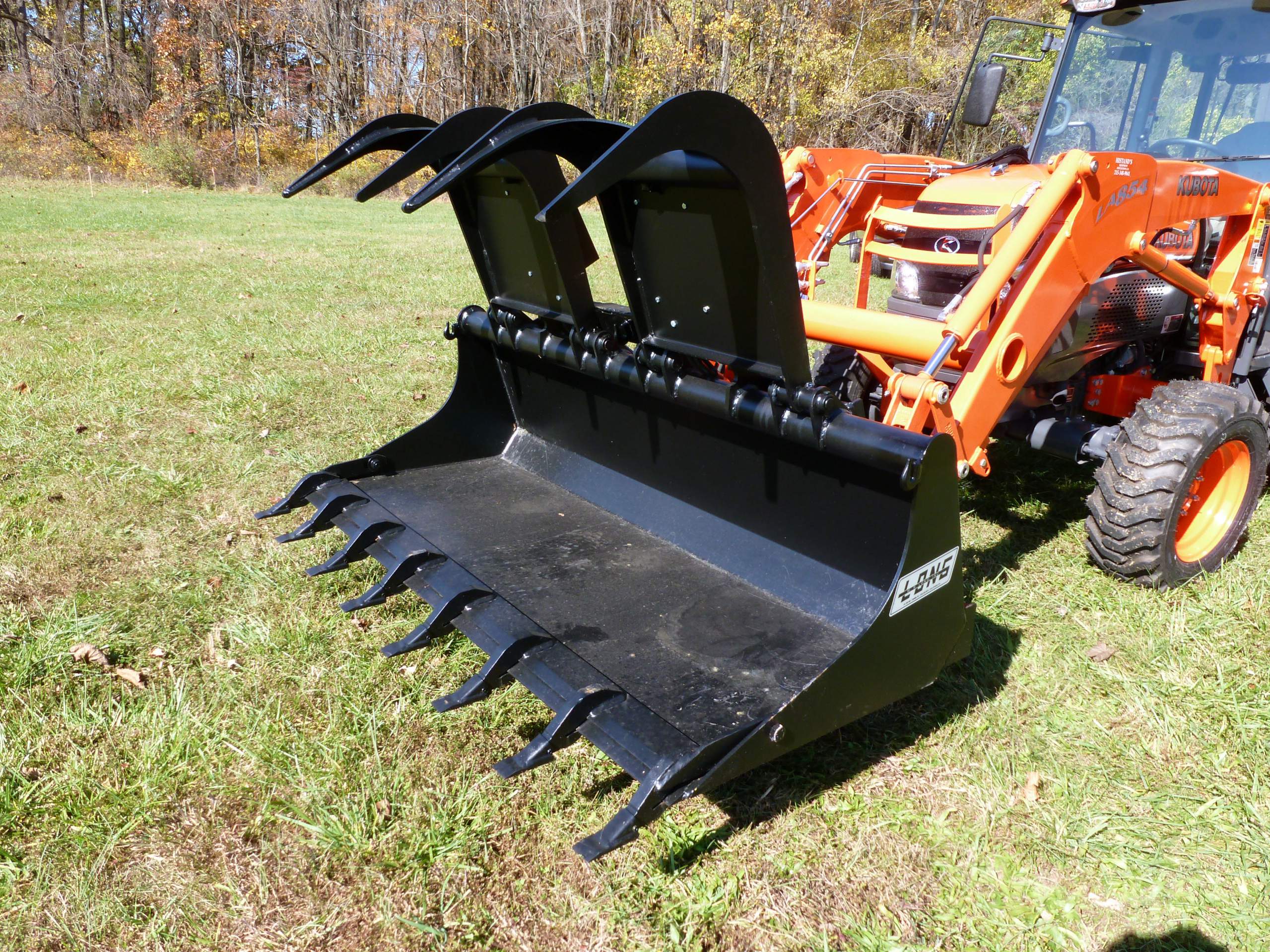

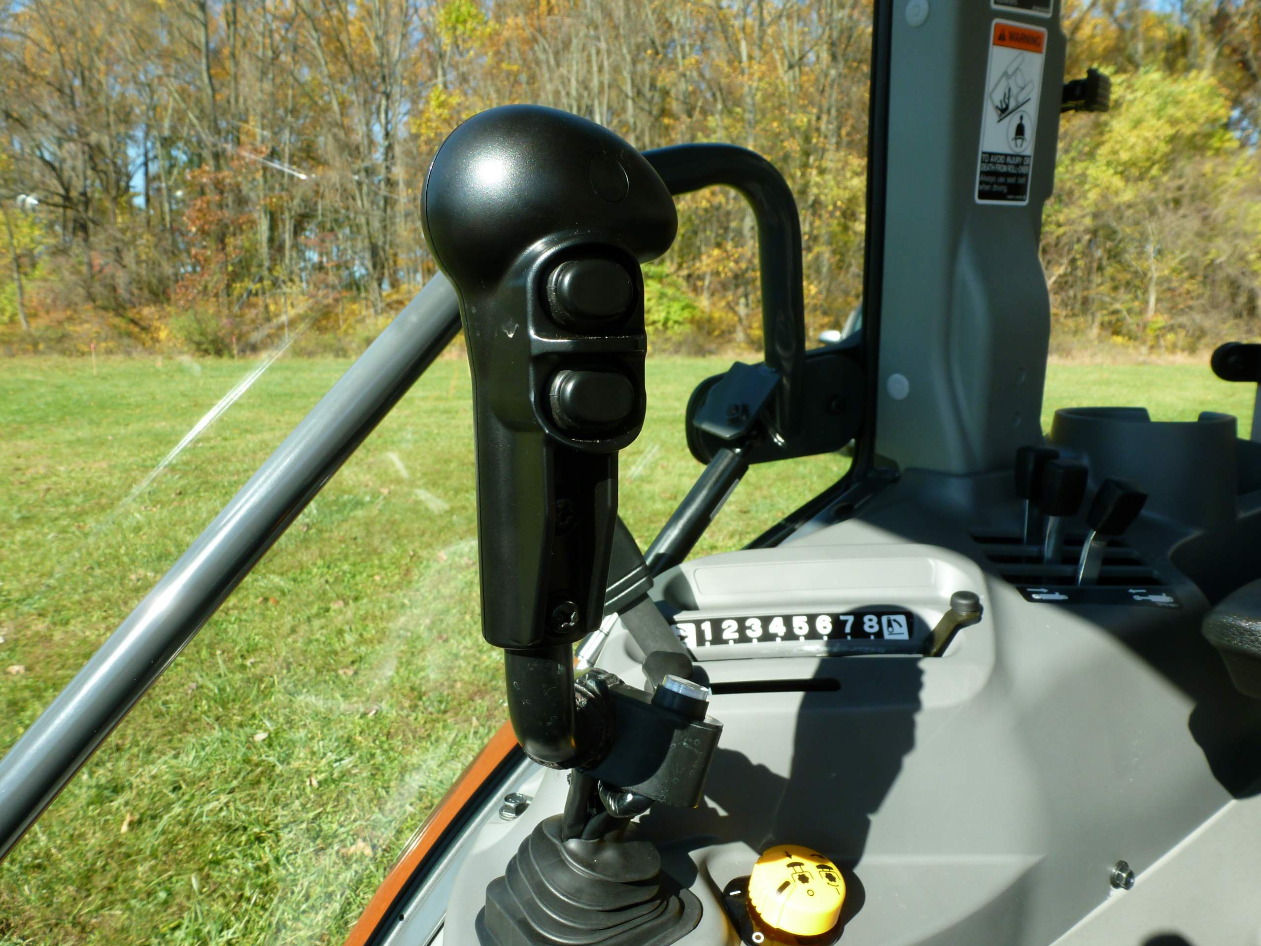

yes to the toothbar. They had one that came off with just two bolts, so I can remove it if needed, but for tree work, it was super helpful.
There is a little on/off lighted button below the two control buttons, and every once in a while, I popped some breaker because the light went out and it turned off.
just press the button again and continue. I'm wondering if/how this is related/connected to the relief valve in the FEL.

I'm sooooo envious...lovely control handle...dunno about the light...maybe something about it in a manual?? What turns off when the light goes out??
pretty sure it's just the grapple, but maybe not. Will experiment. One thing for sure, I've never heard any hissing pop off valve yet.

I'm assuming that the grapple hooks can be rather easily removed when not needed...this would remove a lot of weight out there, make picking up a load of gravel easier, and improve visibility ... just a thought...for when doing no grapple work but lots of FEL work.

Is that joy stick a Kubota factory installed one or a after market one
I have the Kubota third function(same as yours)that lighted button turns on/off the power to the grapple;has to be lit to operate the grapple.I found it is easy to bump this and shut off.
