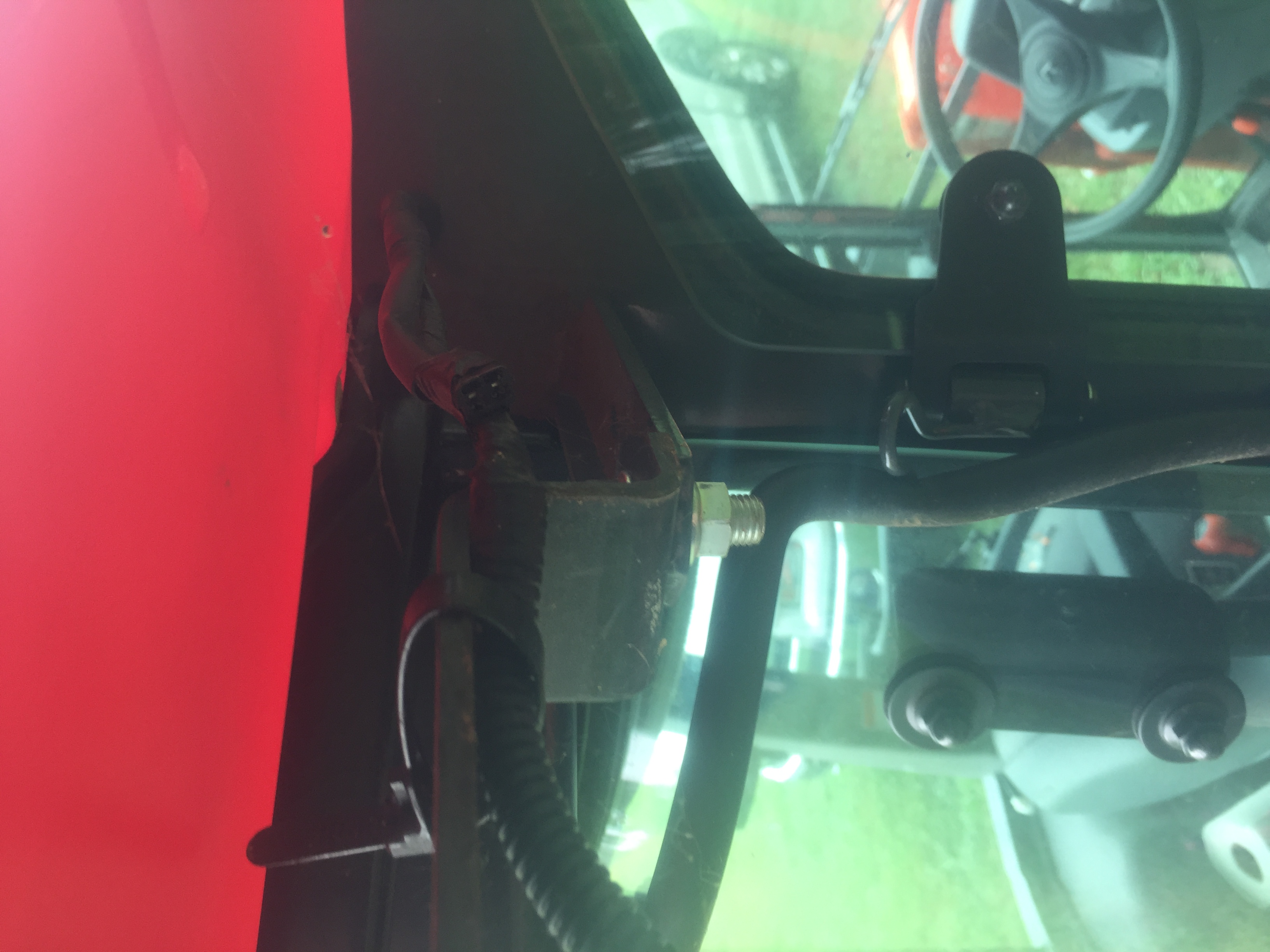

Madone did yours have these plugs ? D62AA817-CEFE-4945-A1B1-AF476F3F2E98.jpeg

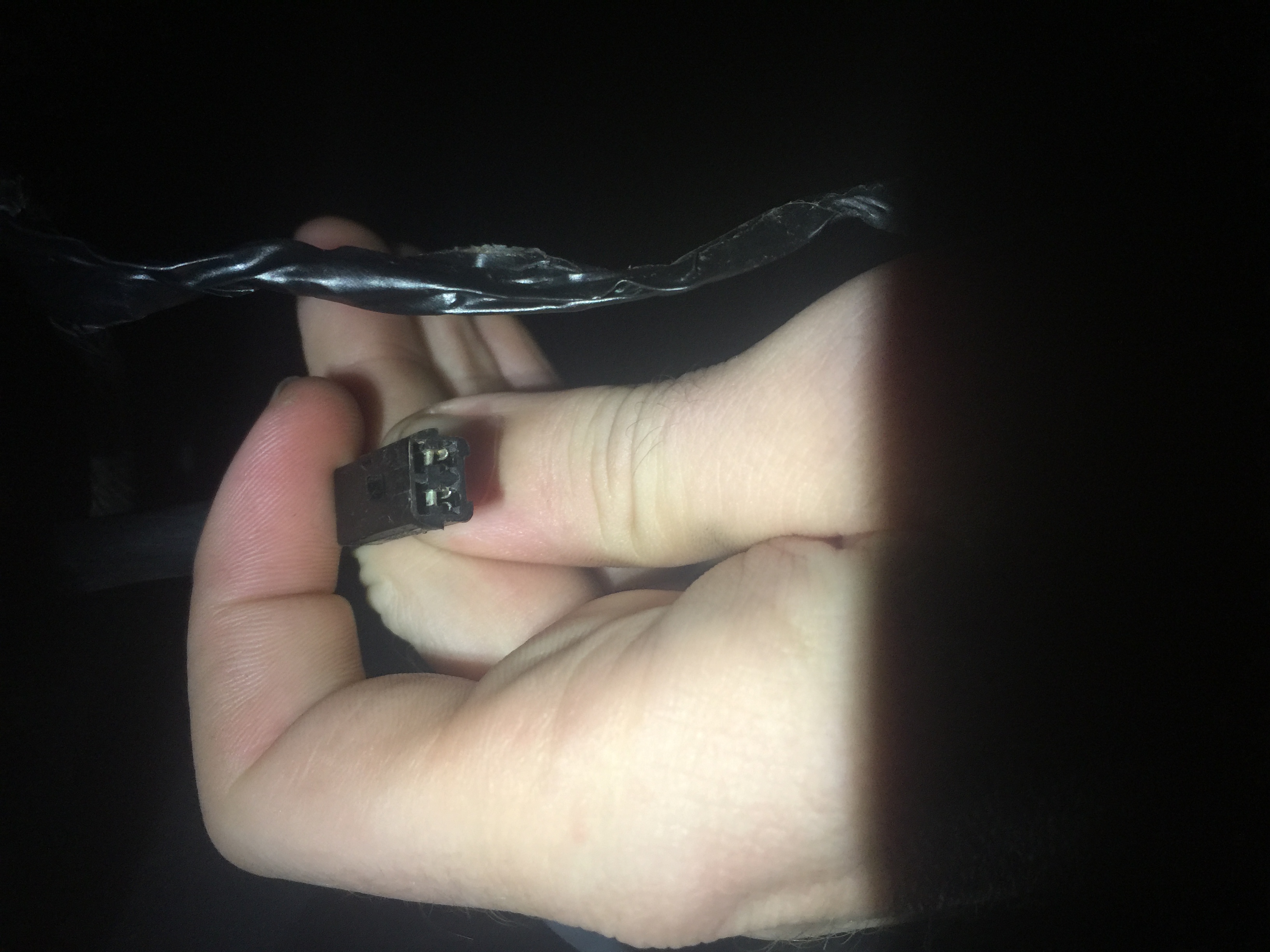

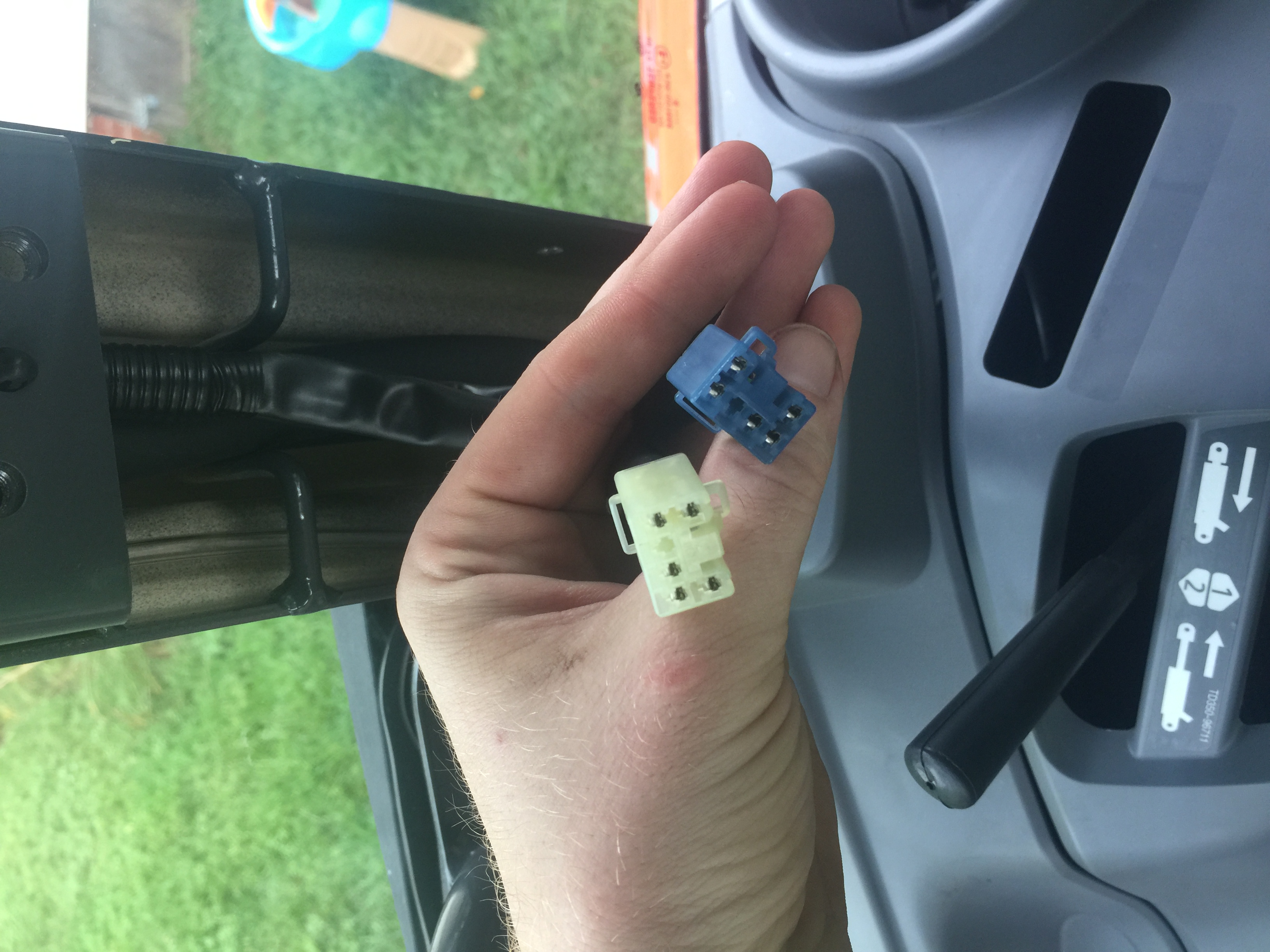

This is the end that comes out by the rear flasher. CBDCE09E-B629-4E83-AA3C-E0367F8C1FC5.jpeg98959DFC-53FE-461E-A188-D3AD22F8FF81.jpeg if anybody knows where to find the male end of the pigtail at a good price please let me know.

The GM speaker adapter by Metra 75-4568 plugs in the the rear work light harness. I did take a knife and pluck the ears off the side off the kubota female plug. Removed approximatly 1mm worth of plastic. I was ok with that. Then wired by Metra 75-4568 harness to my Led lights. I used the brakets that came with my led lights to attach the lights to the cab. I did a little grinding to removed some metal off the supplied bracket. I hope this helps someone save a few dollars compared to buying the work light kit from kubota.
