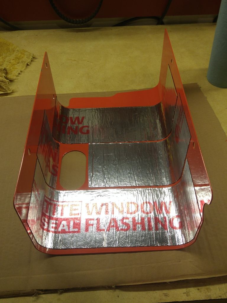

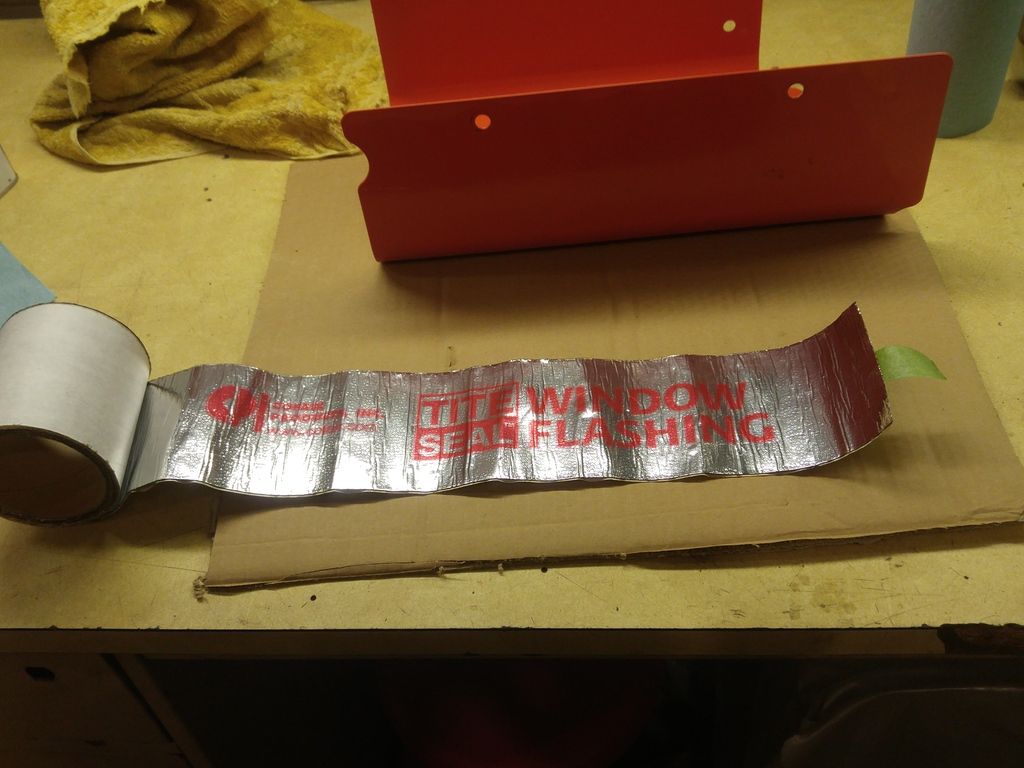

Another quick, low cost mod.....that didn't quite accomplish what I hoped.
The center hump cover is very gong-like when hit with a boot. Plus the whine of the HST is rather loud. So I added some peel-n-seal flashing tape to the underside. Idea was to quiet things down. It did work to a small degree, but this flashing is not near as heavy as the stuff used for audio applications. Might try another layer to see if furthers the cause. I know the reality is nothing will really help the whine...well perhaps a cab'd Grand L!
