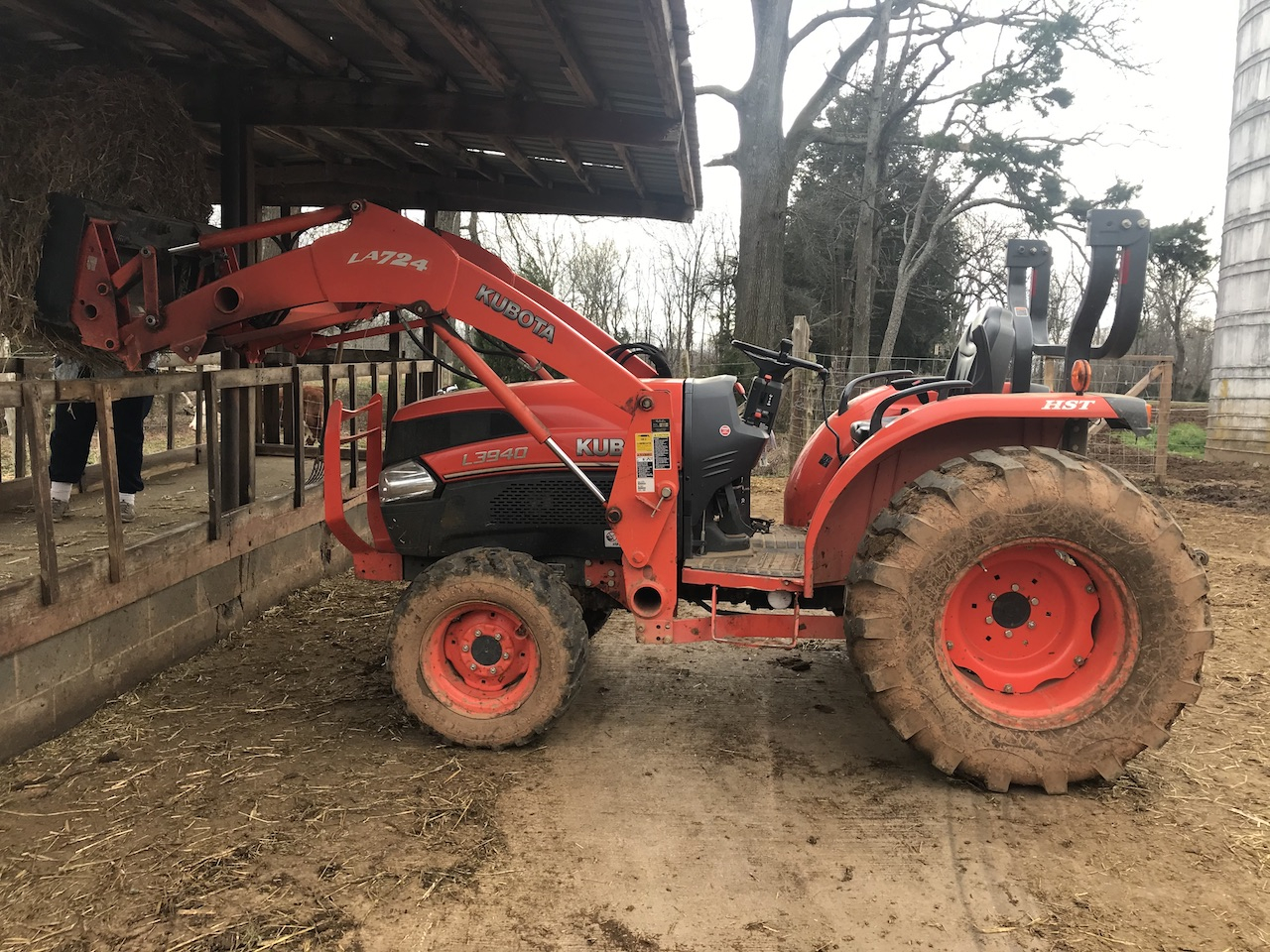

To each their own but a hair less than 2800 hours on this '10 L3940 and no repairs yet except a couple batteries, knock on wood.

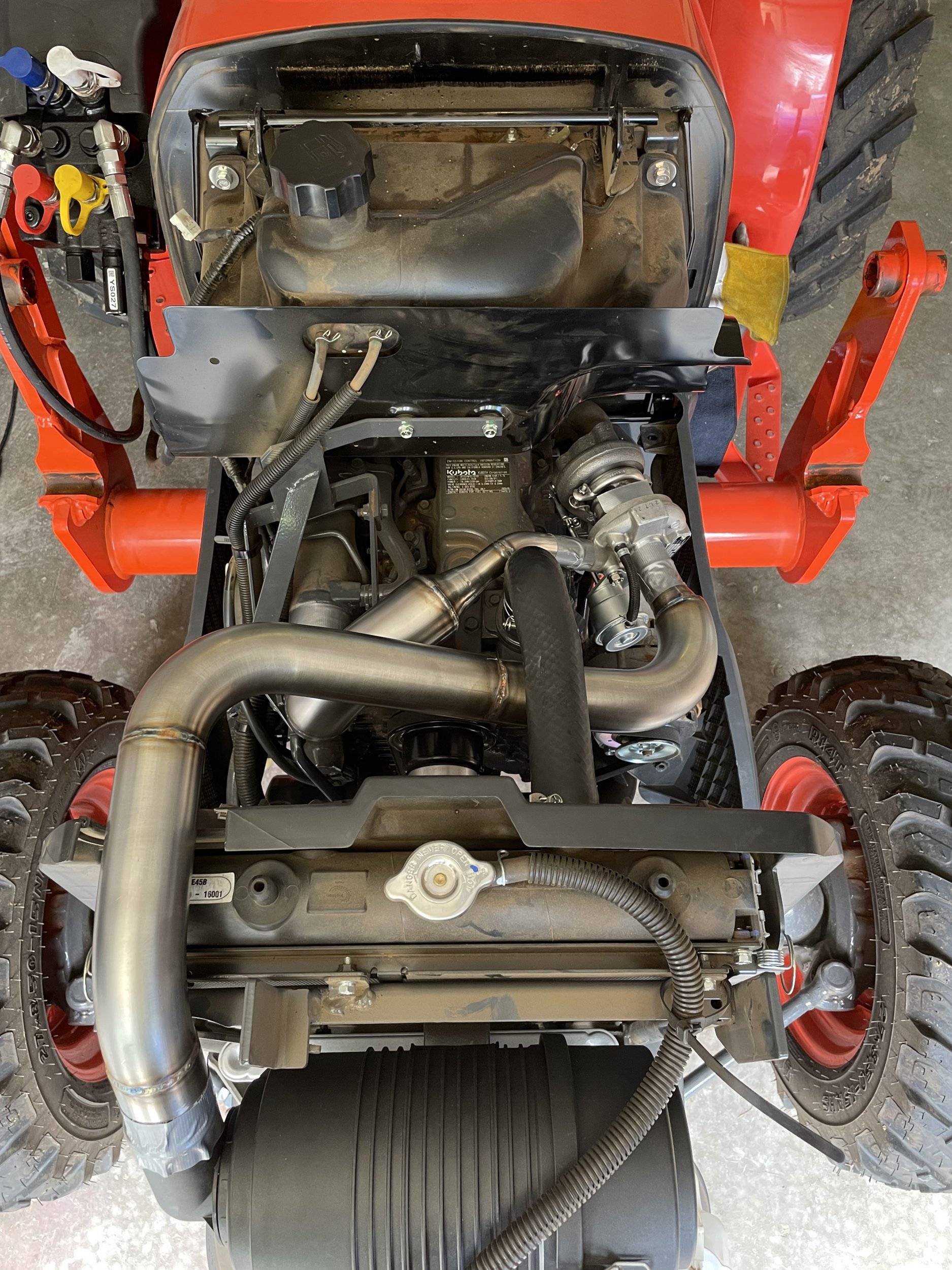

It has taken longer than expected to get the parts together and find the time for the project but…things are finally moving forward;
I should have everything finished and running by the end of the month.

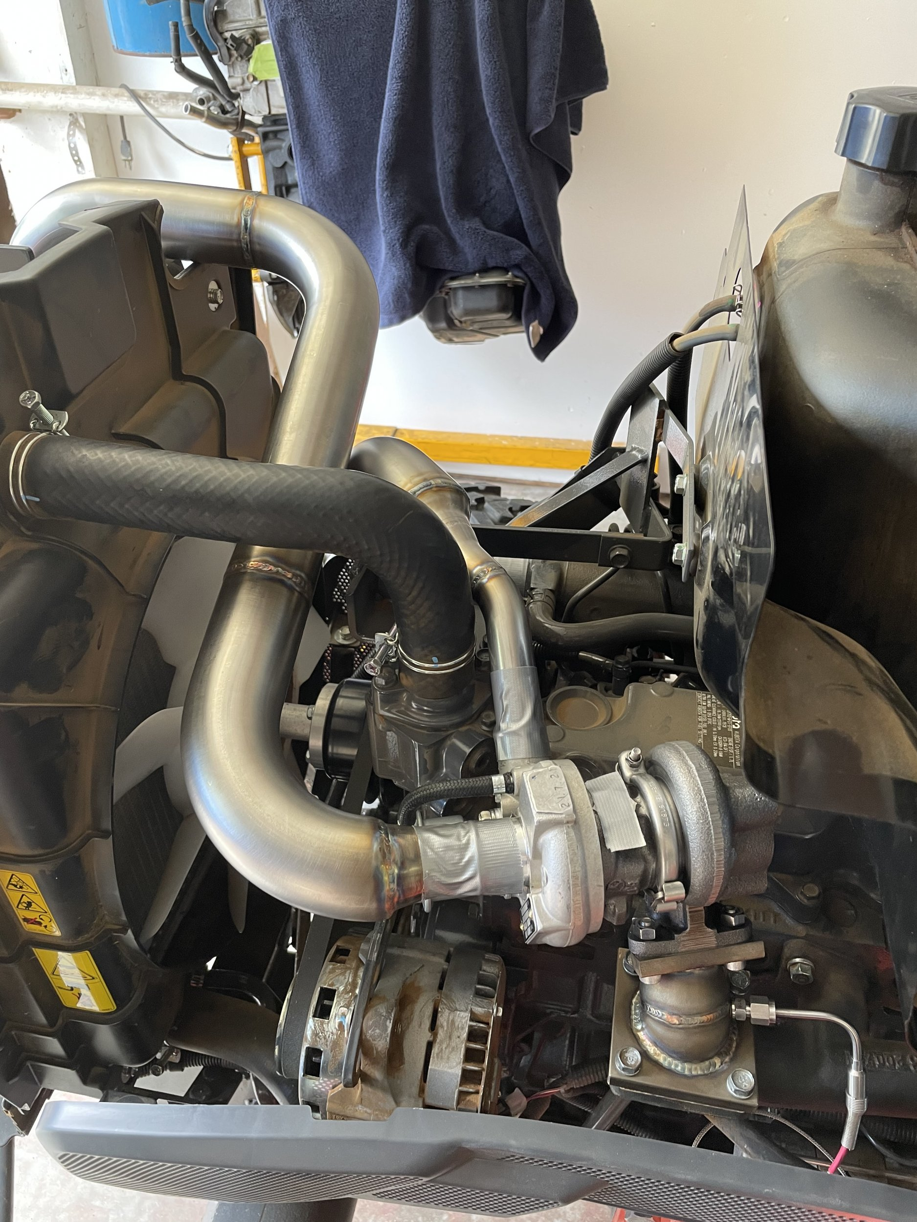

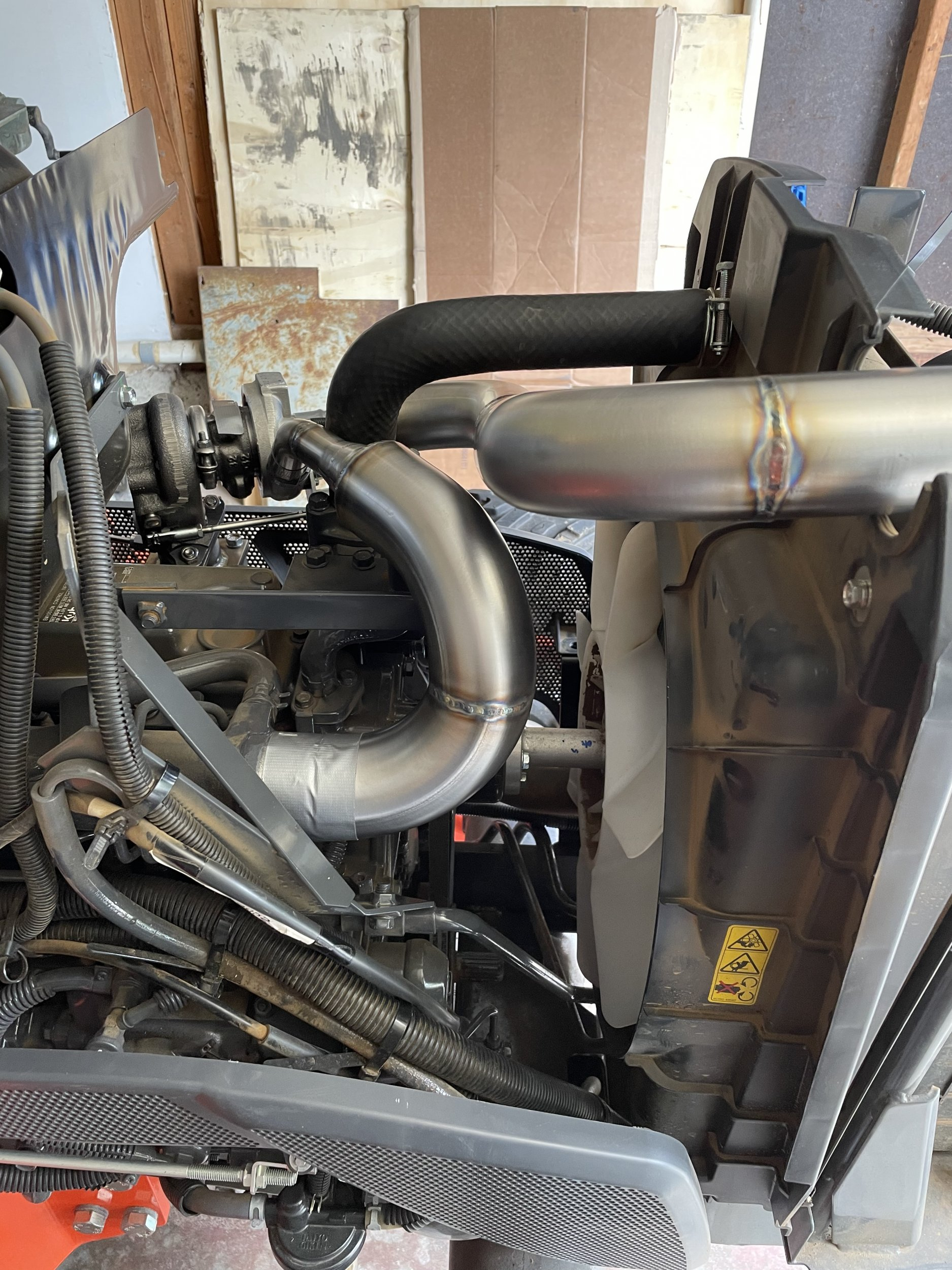

Got some more work done (Turbo intake pipe and charge pipe);
The silicone couplers and hose clamps should be here tomorrow so I can remove the duct tape, lol
The transition pipes are being made by hand and have been taking way more time than expected. If we make anymore, I’ll use pre-made transition pipes to save time. Plus, they’ll probably look better too.
Working on the downpipe now.

Looking good.
I'm sure you know this but don't forget to deal with the breather tube going to intake manifold. You may need to plug it at the intake manifold and reroute it to the intake side of the turbo.
