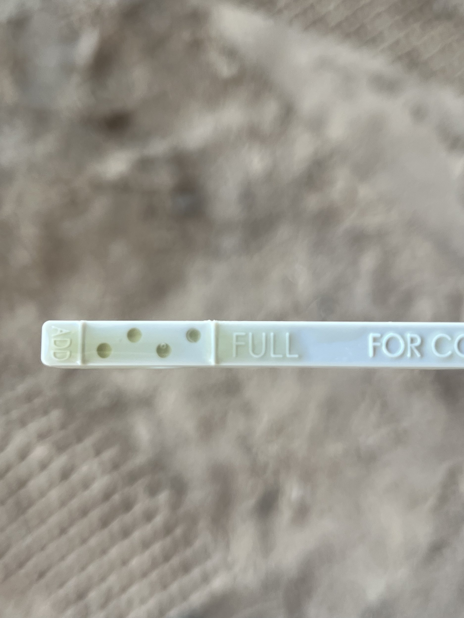

Okey Doke. . . It’s been an hour, so I went back and started it up. Big ‘old cloud of blue smoke. Let it run for 5 seconds till it quit. Turned it off. Started it again and got the same. Did it a third time and no smoke. Checked the oil, and it is over the full mark. oil goes up to the second L. Is this too much oil, and if so, would that cause the oil to be going into the cylinder so cause the smoke. I’m not very savvy on engIne mechanics. Here’s a pic.

Some engines require that the stick be screwed in, others not. I would do two things...
See what the manual says about sticking the oil
Make sure you have allowed the oil to settle (especially if not warmed up). This would make the level appear low though.
But yes, overfull oil will cause smoking

You’re Right. Manual said, put dip stick back in and do not screw the top on. Did that and oil level was fine.
I’ll keep peckin’ at it. Thanks guys.
