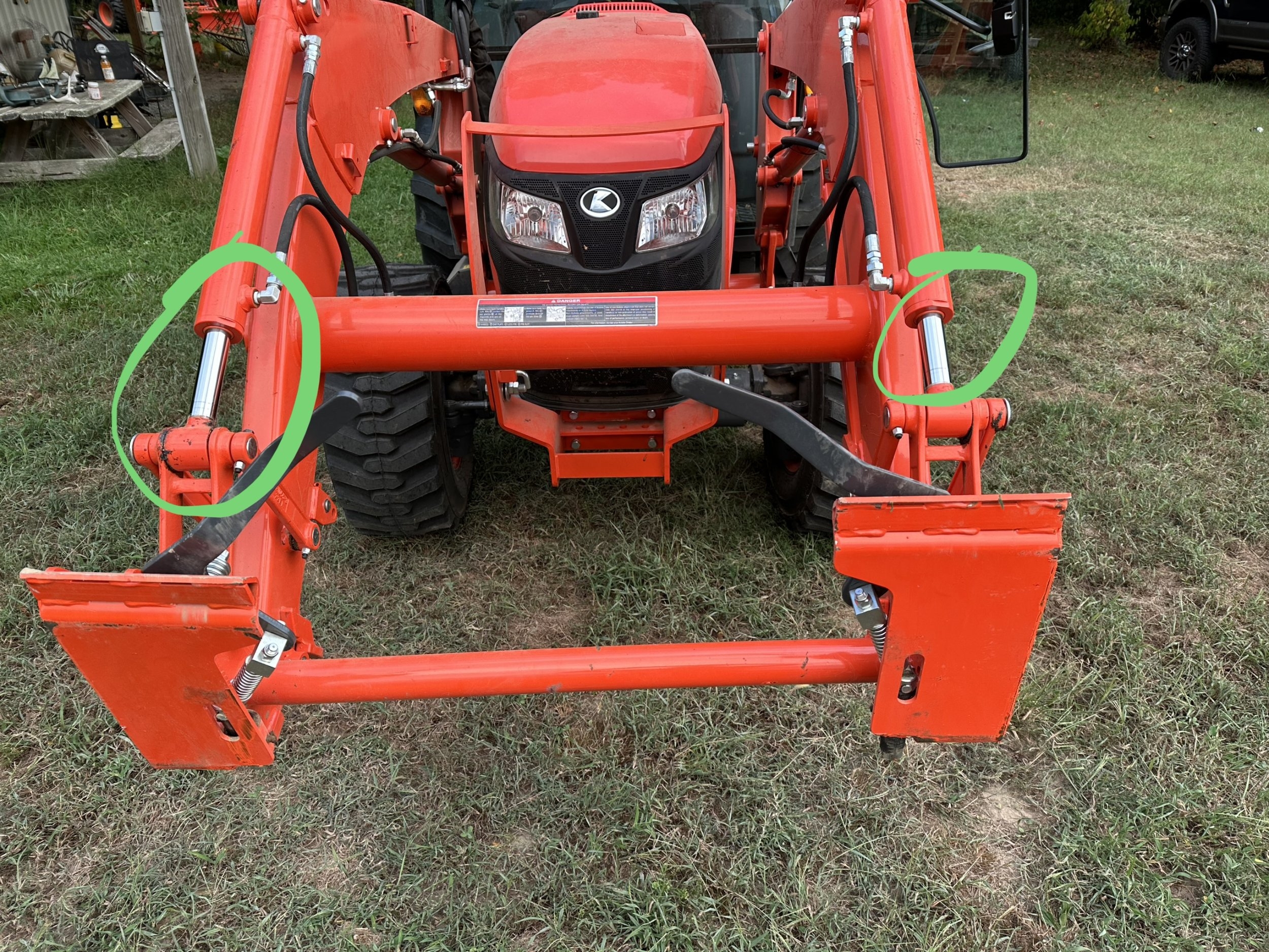

Brand new MX6000 with LA1065A Loader. Bucket came off on left side, seems the hydraulic on one side is not set the same as the other? Is there a fix for this? Need to get the bucket back on. Thanks

Agree with Gator6x4. The crosstube has twisted/bent on the coupler. Thst shpuld not hsppen....unless, you caught the rh edge under something solid and rolled it back. Just speculating.
   / New Kubota Loader Uneven #4
You can see the damage on the passenger side mount. Looks like someone lifted without having a good lockup and the driver side popped out. Was it delivered with a bucket or something mounted? Did it take a lot of force to release?

Probably, but may be better to replace it.

Exactly the driver side had popped out and I did not realize it.

The SSQA mount is bent to hell...looks like they ran it over in the parking lot lol. I would require a new one. They can bend this one back until they get a replacement in so you can use the FEL.

Looks like the quick hitch assembly (2 plates and connecting bar) got bent or was misaligned when they welded it up during manufacture. The dealer should replace it on warranty just based on your photos. While you wait for them to get a new one in you should be able to force the plates back into alignment by hydraulically going to full extend or retract position. When the first cylinder bottoms out the other should keep moving till it bottoms out temporarily straightening the assembly out. If you can figure out how to orient the bucket to mate with the plates in full retract or extend you should be able to get the bucket back on.

ScottyP: the cross bar pictured has been torqued & now uneven for reason you described. this has happened to me a few times when one side is unlocked, the other locked under load, twisting the tube. to correct depends on how bad it is. i made some adjustments & was able to correct the problem. Dealer gave me a quote of 1k to cut & replace the tube.
sounds like it happened @ dealership or factory, so it needs to be addressed @ dealership under warranty. if it is corrected w/o replacement, be aware the tube is slightly weakened & prone to the same problem again if one attachment lever is not locked down under load.
suggest securing both levers w/bungee cord once locked down,
another fix would be to cut the tube, reposition on level surface, & weld up. Personally, i'd let a professional welder do it. best of luck

Seems you bent your FEL mount, that will not be a warranty fix. You can either fix it yourself or pay someone. I would try to fix it myself. With the bucket off, put the right side mount against a big tree, curl out the FEL until the left side is even with the right. Then mount your bucket and weld any cracks you might have in the welds.

I have been in this situation. Stuck a hydraulic post hole digger in the ground and was yanking and doing things I shouldn't, to get it spinning and free. Anyways the auger motor was bolted to the side of the bucket and it put a lot of cantilever on the SSQA mount. It twisted bad enough for the bucket to come off.
My repair was to cut that cross tube in half, curl until the cylinders bottomed out and put a blank SSQA plate on the loader and locked it in. Then I welded the tube back together. It worked good for the SSQA bucket engagement, but honestly the kobota loader was twisted and never right again.

I'm not suggesting anyone try this but I wonder if you could at least partially straighten that FEL frame by reversing the hydraulic hoses on one of the curl cylinders? That way, one cylinder would push while the other pulls.
The hydraulics probably aren't strong enough to "untwist" the frame completely but it would be an interesting experiment.
