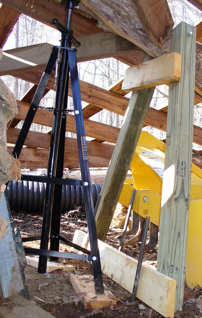

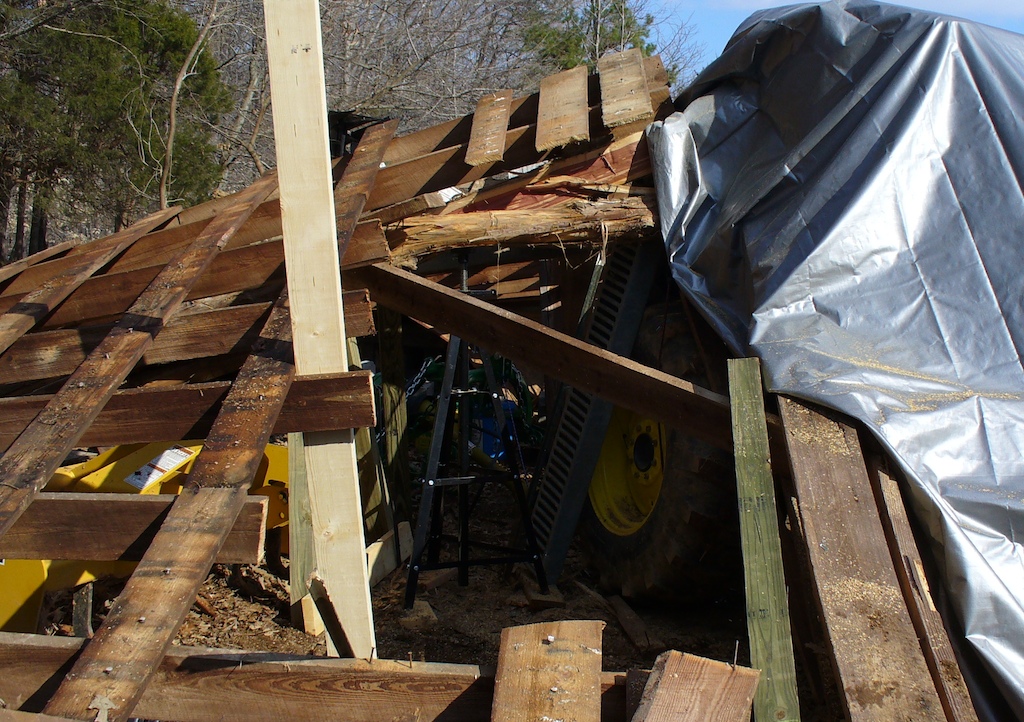

After placing some wood and metal supports, I got under the mess and used a jack to support the mail cedar post that was against the ROPS vertical post and supporting all the weight. Once that was in, I built an 'A' frame type support so the post couldn't shift.
Once that was done, I cut away the boards on the top on both side of the tractor to start relieving the weight. I also put in 2x6 support on each side (clear white boards) to hold up those sections once they were cut off the main post.

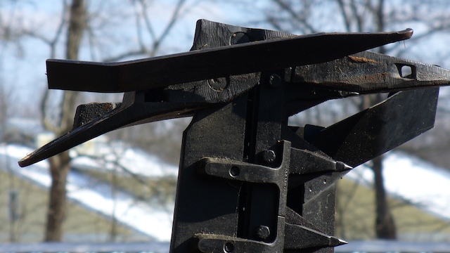

The sickle bar, which was also holding up some load, was free. A guide on it was bent, the rest looks OK.

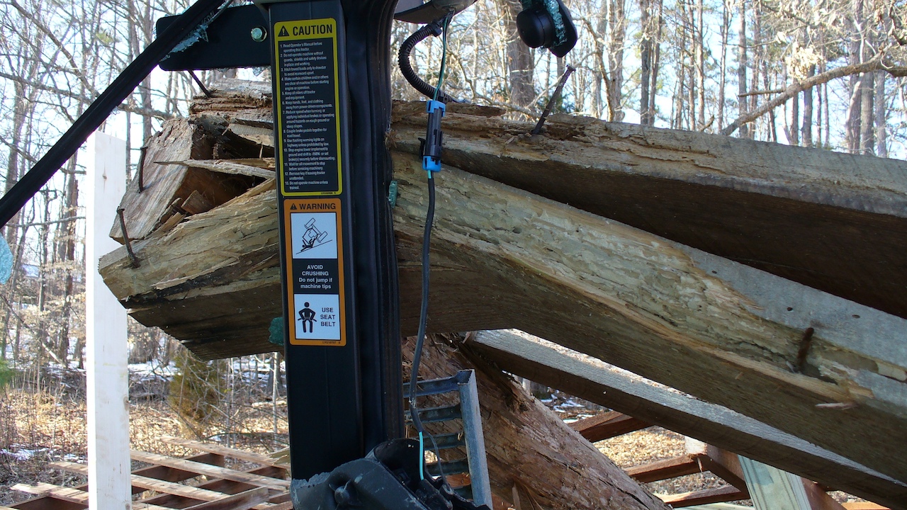

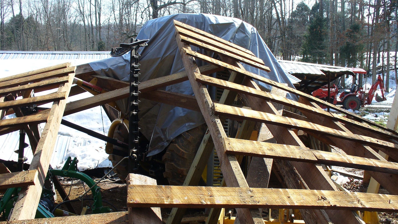

I finally got things down to the mail post and the beams balancing off of it on each side. All the cuts I made were very small, about 12 to 18 inches at a time. But then it was time to alternatly cut back the beams.
You can see how a beam attached to the post was resting against the vertical ROPS post, the beam was splintered. There was about 12 feet of beam just hanging in the air. The other side was on the ground.
