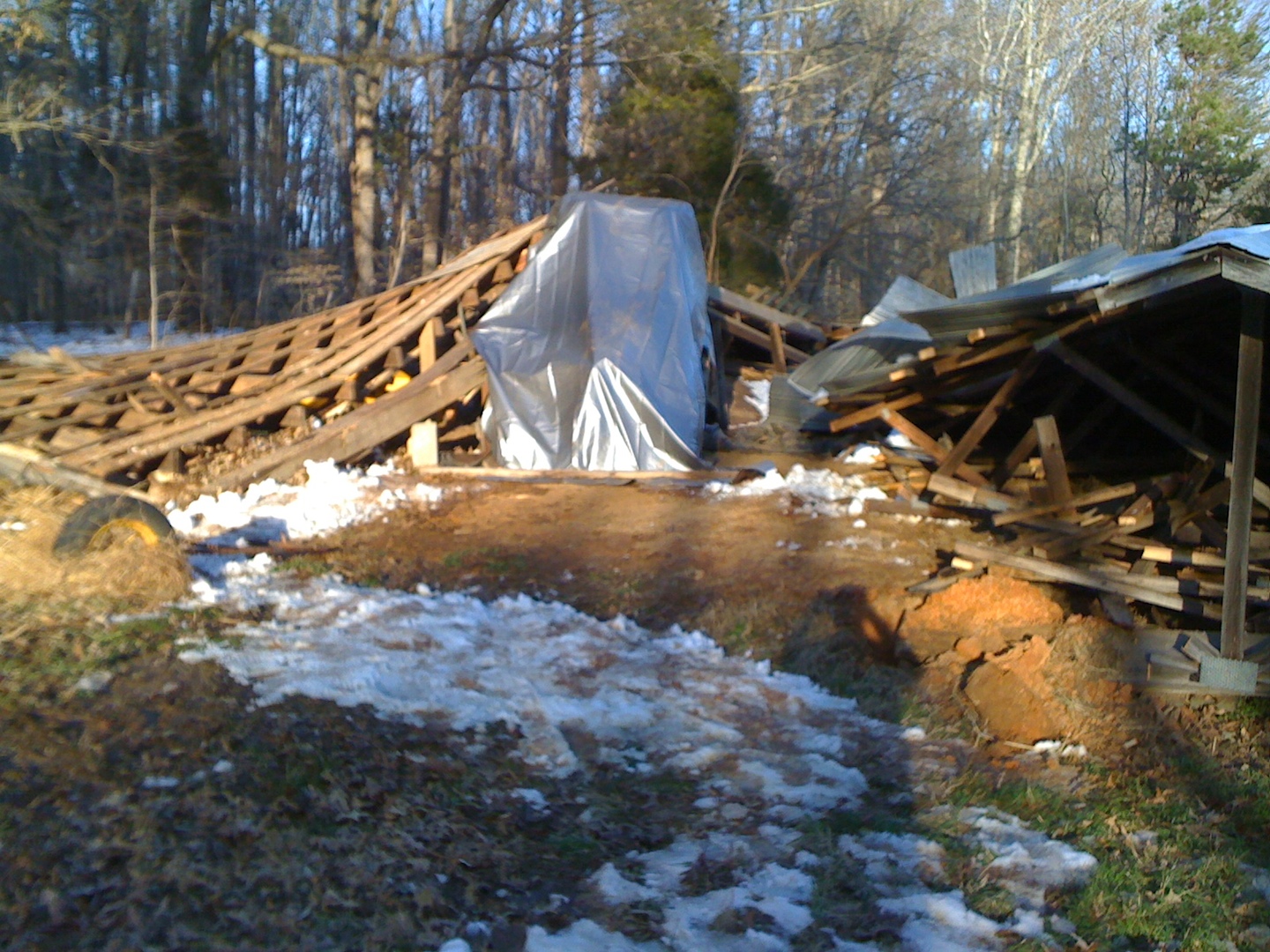

Today I finished pulling the tin off of the purlins, cut off the corner of the roof so the tractor could be pulled out, and tarped the tractor so there would be no damage from the rain tomorrow and at the end of the week.
Insurance co. said "OK to shoring up all the stuff leaning on the tractor", and said if something shifted in that process and there was more damage that would still be covered. Have claim number and contact, will speak with them tomorrow. Due to bad weather this last weekend, they are swamped with claims but still thought they would have an adjuster out here this week.

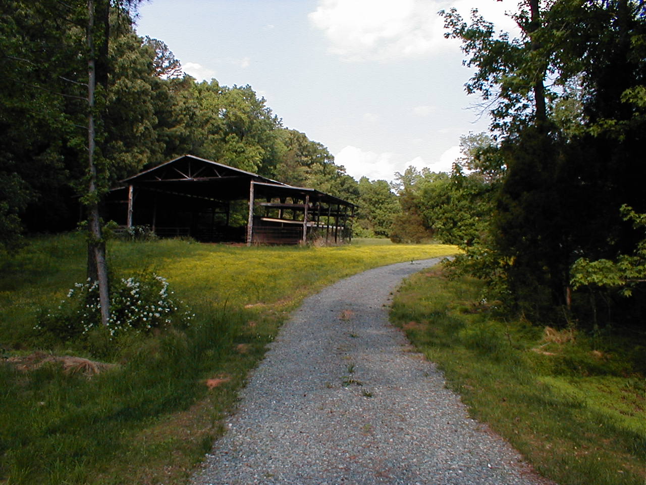

No pics of the inside pre-fail. Have one pix of the shed from a distance. The view is about where I had my "what the heck" moment as I drove in. It was an open pole shed so the strength of the poles was the key. That's why it "trapazoid-ed" down flat. Lesson to learn here is open sheds work best when they have 2 side (a corner) for better stability. It was on the land when we bought it.
As for snow guards, I'd say Not needed if you don't have gutters, and a good idea if you do. New not quite finished tractor garage doesn't have them, it dumped it's snow in one big pile. House has them, they are working great as the snow is staying on the roof and melting and the gutters are also still attached.
Next step after the adjuster is to figure out how in the world to shore up the 3 interconnected beams so I can start to cut my way towards the tractor. A 6 foot jack will be key, along with some cribbing and 'A' frame support. That will be a multi-person task for an afternoon, probably weekend after next. It is all stable and safe from the environment now.
