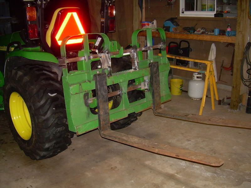

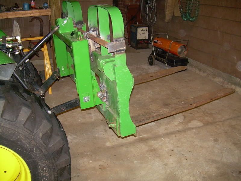

Great idea, these things are getting like Swiss Army knives, I got some good ideas looking at your work , maybe this will do some thing for you.
I almost finished this today, tried it a little and seems to work great, but after I finished it I started thinking I wonder if anyone makes an adaptor plate to go from I-match to JD front quick tach, I probably could have made one with a little more time and material, would have to start with some kind of box frame like yours, that way I could put any front accessory on the back, yours is the opposite now you can put any rear implement on the front.
I like things that have multipe uses.

thanks for posting, I saw your post about that the other day and made me start thinking, if i welded some brackets on the back of my frame i could put the frame on my 3point and use my forks on the rear as well!
