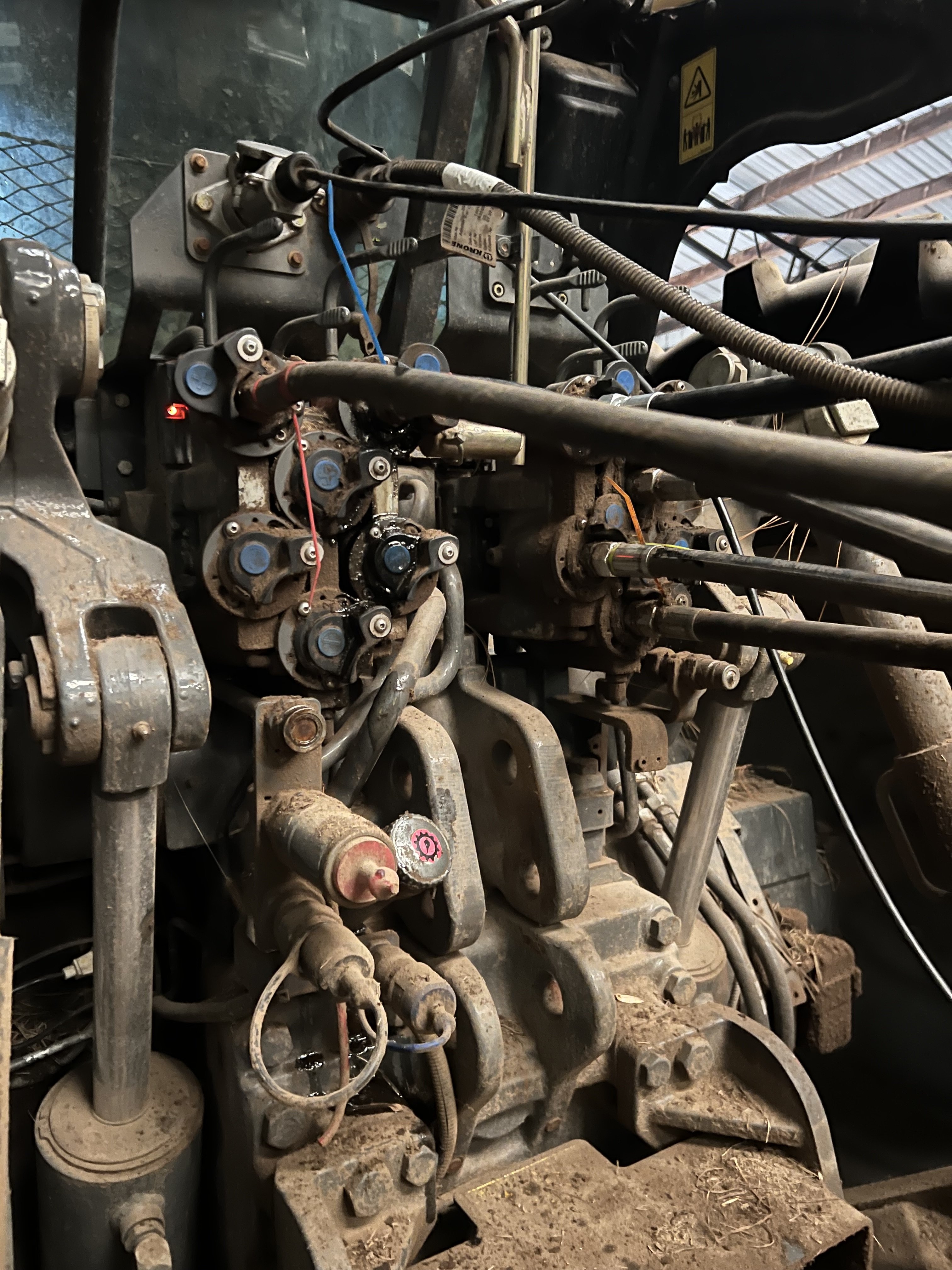

rScotty is right about the hydraulic remotes. Get as many as you can afford! I got two remotes and I wished I had gotten three. When I hookup my hydraulic side shift flail mower, I have to take off the hydraulic top arm because the flail takes two remotes. It sure would be easier to have that hydraulic top arm when hooking up and adjusting the trim of the mower than adjusting the manual top arm.

Yep, get three remotes when you purchase the machine. It costs a lot more to add them later. And the more, the better.
   / Struggling with MX5400 purchase — could get MX6000 for same price. What would you do? #45
The only reason it would cost more is if the customer’s tractor has to be picked up to add a third.
Otherwise the labor charge is exactly the same.
I would agree that two remotes are better than one but figure out first if you’re gonna need a third.

2 remotes is not enough. I encourage 3 or 4 sets.
You won’t regret this small expense on this large of a purchase.
My MT655E has 6 sets and with the electronic style remotes being prone to spool failure, it’s good to have a few extra sets of remotes. #6 is “out” on mine right now. $1,000 for a new solenoid. I can live with 5 sets lol
