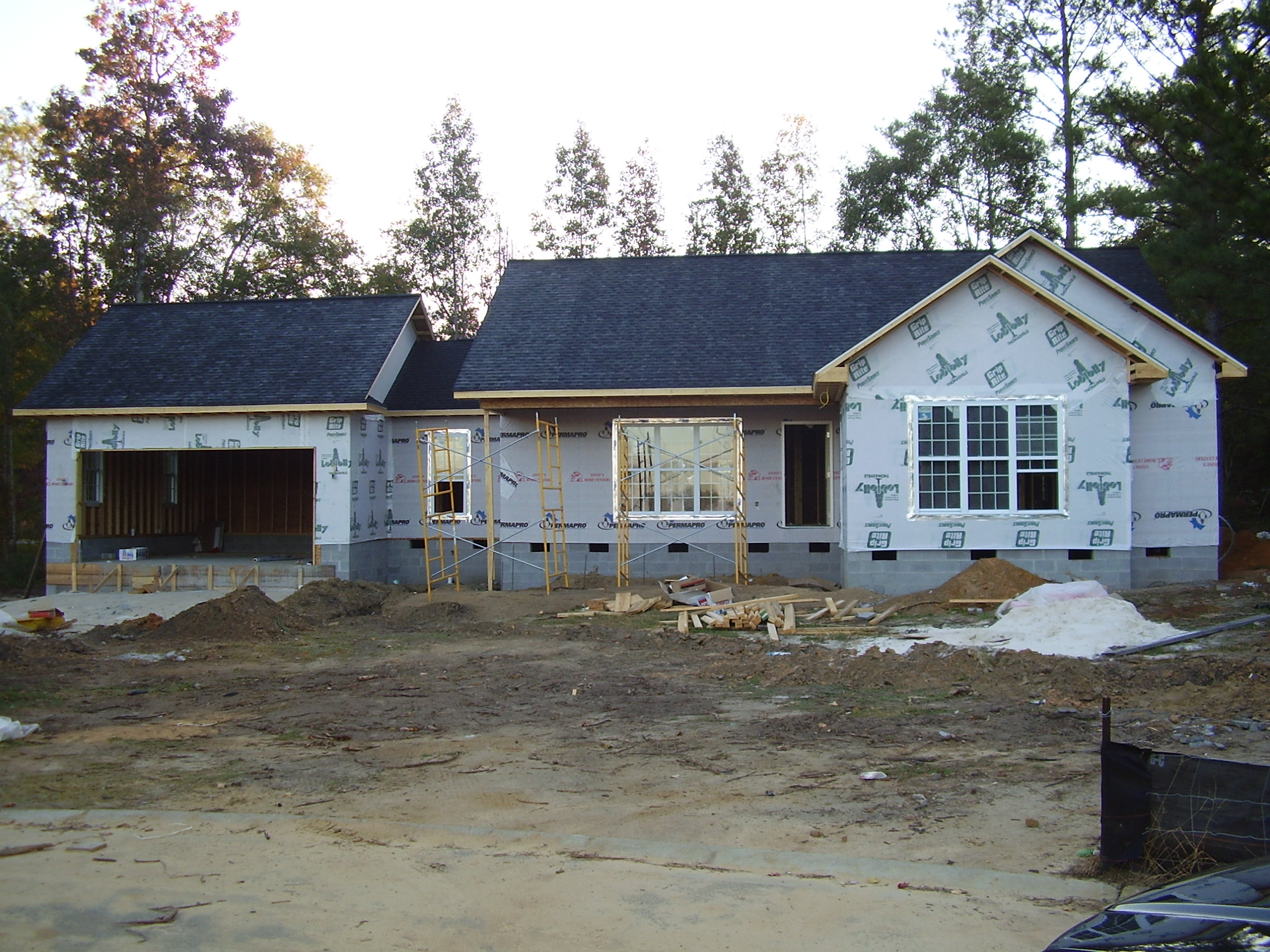

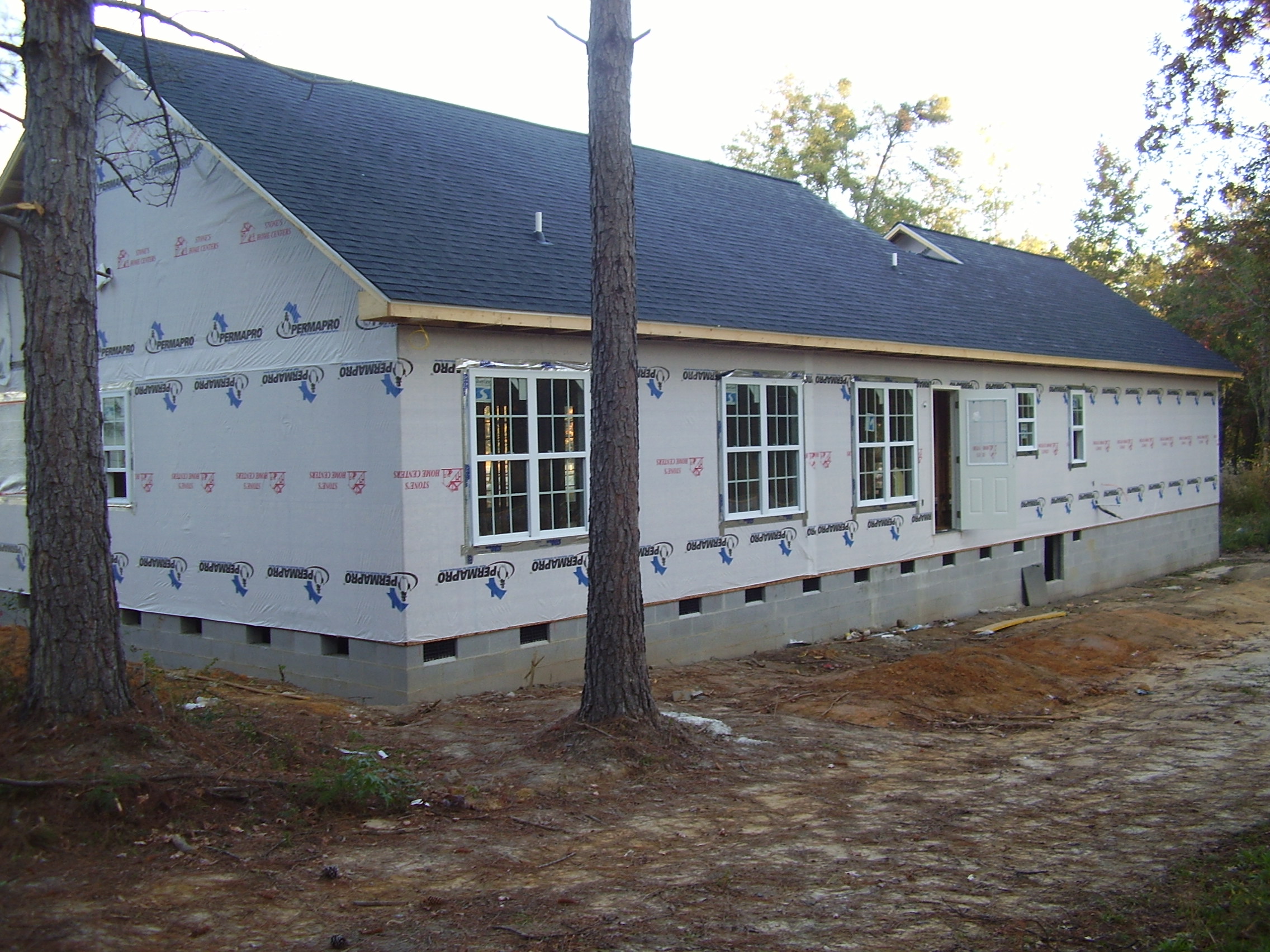

Well this thread is a little late being started but we are just now slowin down a little here at work. Me and my wife got married this past July and this is our first house. We have about six acres out in the coutnry but have decided not to build there just yet. This house will be in a subdivision but will be perfect for our current needs, probably will only be in it for two years. Completion date is scheduled for the end of January...first child due March 17th...these were taken this morning...enjoy!!

Interesting roof line.
How about some details. How many sq ft? Rooms? Any special details like an open kitchen?
From the pictures, it looks like you used plywood for your facia boards. In my area, I get allot of work replacing those due to rot. Once the pait cracks at the seams, the ends of the plywood get wet and begin to rot. Some people paint over it, but the paint will always crack there and it just gets worse. Soffits are OK being plywood, but facia will have issues in time. Of course, if it's standard practice and you are not planing on staying there, then it won't matter.

I like the change on the roof profile between the house and garage, really is something unique!

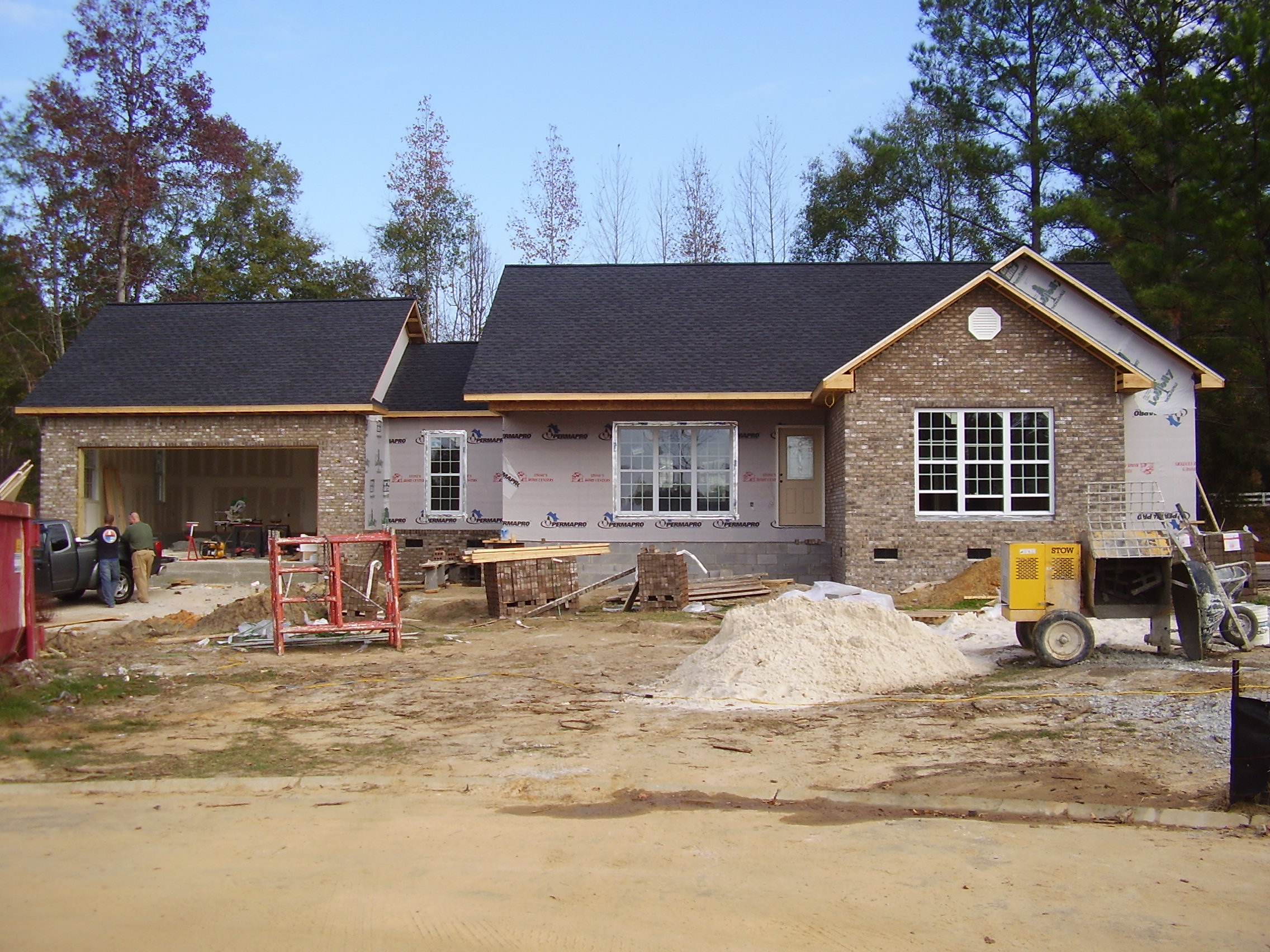

Just posting an updated photo, brick will be done Monday!

Looks nice. Are you doing brick on all 4 sides or just the front?

Please excuse my ignorance as I know nothing of house construction. I'm just wondering what the spaces in the block where the house meets the foundation are for.

Are you refering to the vent openings?
Homes with pier and beam foundations have an open crawl space under the floor. This area is vented to the outside and covered with a fine screen.

I see now, Thanks Eddie. I'm used to basements under everything here up north. I learned something today!

Brick looks great. I really like that color. What is it called?

Thanks for the kind words guys. We LOVE the brick, I can't recall at this time what it is called but I think it has just the right blend of shades with enough "white" not to look dark. The only parts of the house that are going to be brick is the main front gabble (running back to the front door), the garage gable, and the front/left/and right side foundation. We are going to use harde board on the rest of the extrior. Trim/paint/brick work will be done this week...

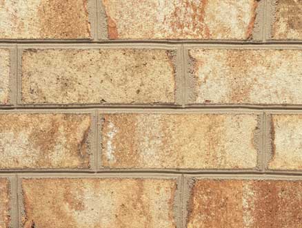

We love brick and are bricking ours as well. But we have grown tired of red, red and more red. Don't get me wrong. Love the colors, the accents with it, we just want something different. Going with St. Augustine by Hanson... pic attached... maybe...
