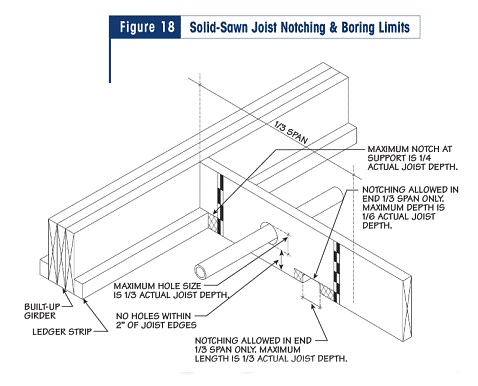

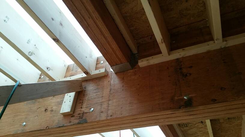

The 2x2 is a bearing surface. The bearing surface has to have enough wood fibre structure to prevent crushing.
The notch is within spec, so is the bearing surface.
It's the beam that the 2x2 is attached that has to hold the weight. The ability of the 2x2 to support and transfer weight to the beam is through the fasteners used to fasten the 2x2 to the beam.
Then you add the toe nails of the floor joists to the beam and consider the ability of those fastens to withstand shear forces.
I think the engineers, contractors, framers and inspectors probably have it figured out.
Again, just because we haven't seen it done.or done it, doesn't mean it is not as good or better than methods we have used.
Since I've never seen this done before, I will wait and see what the inspector says about it. What I'm positive is wrong is that they used nails to support the load. This will fail every inspection I've ever had. At the very least, there needs to be a lag bolt of some kind under each joist. In some parts of the country, bolts are required and lags are no longer allowed. I wouldn't even guess what size it needed to be, I would go to the blueprint, or give the inspector a call and ask him to come out and take a look right away.

Five pages on a ledger, LOL. fwiw almost every basement framed with dimensional lumber around here uses the same method for the center beam.
As far as the lack of a header above one opening.. It looks like there is going to a change in the roofing direction? So likely no need for a header since there be nothing above there for a header to support. I'd rather have room for insulation then an unnecessary header.
Looks like the framing crew knows what they are doing for their area. And are doing a fine job.

Justin, I flipped a house built in the early '70s that had the same ledger board set up with a 2X2 run and toe nailing or end nailing. It was holding fine in 2005 as when it was built. I think as others have pointed out there are different methods in different areas. Just wanted to tell you I've seen the same done before throughout that house and I couldn't find a single issue.

I appreciate the insight- seems like a pretty standard practice out here. I'm guessing that local codes really dictate the differences in construction.

I noticed today that they installed a joist hanger under the main support beam in the living room.

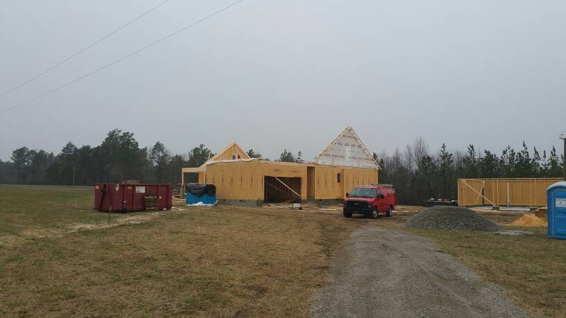

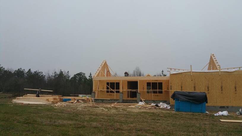

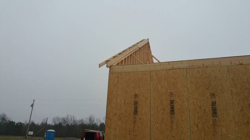

The framers were out again today. They have started to frame the roof trusses. Here are some pictures of the work....

Not happy with how they did the gable ends for your roof. In time, they will begin to sag. The deck sheeting is all that will hold them in place. Here is a link that shows how it should be done. https://www.pinterest.com/pin/529102656196748258/
Does this method suggest the gabled truss will be "shorter" than the other trusses to accommodate the outriggers?
