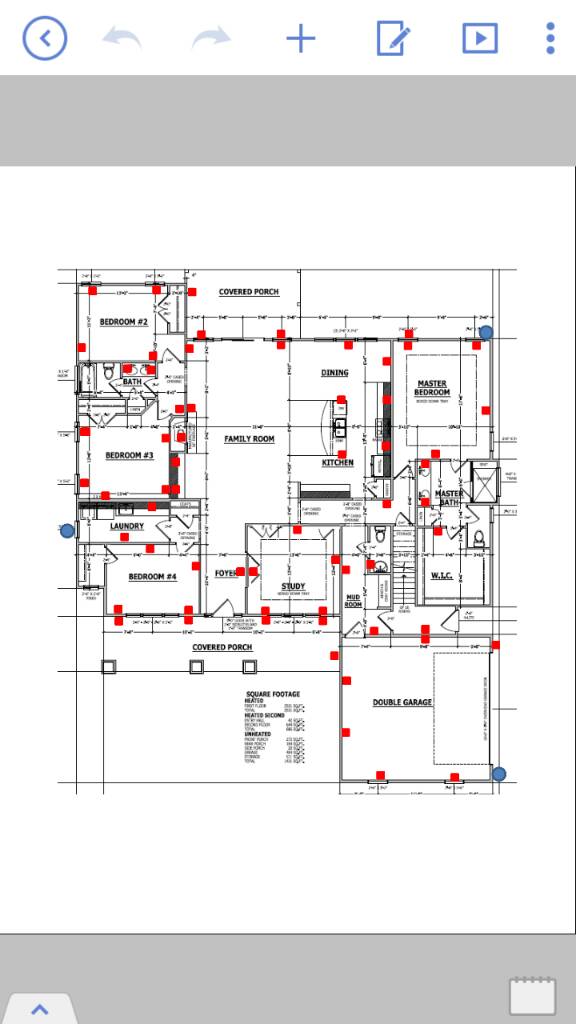

The wife and I did a rough layout of where we want electric outlets. The big question is how to get outlets in the living room. I believe floor outlets are the only option. We will likely have wood floors. Is there any subtle way to install in floor outlets? Everything I've seen looks a little tacky.
The wife says that outlets aren't necessary, but I just dot agree. I need to have my computer and phone charging while I'm in the lazy boy!!

#244
Red dots represent outlets and blue circles are water spigots.
   / New House Build in the Country!!! #245
Add a outlet in the center ceiling in the garage for electric garage door opener.
   / New House Build in the Country!!! #246
Master bedroom you missed a wall. NEC says receptacles must be no more than 6 feet from a doorway and no more than 12 feet apart along a wall.
   / New House Build in the Country!!! #247
Consider moving the water spigot from the left side of the garage to the right to make the plumbing run more economical. As it is it is quite a distance from any other plumbing. Might not be a big deal where you are at but in Michigan, there would be an issue of keeping that line from freezing. But where you are, probably not a problem.
   / New House Build in the Country!!! #248
Regarding outlets in the living room floor, I've seen some nice brass outlet covers that you can cover the entire outlet, flush with the floor. But if you don't have furniture placed nearby, it can be awkward in practice to use. It would be a tough call for me whether to do it or not. For me it would depend on a good furniture plan. But furniture placement changes. When in doubt, the wife wins.

   / New House Build in the Country!!! #249
I think he was just marking outlets he wanted in addition to what code requires. Maybe I am wrong but that's how I read it.

#250
Nope -you are spot on. We didn't mark areas that would require plugs by necessity. Builder is already going to install outlets to code - this is just to make sure that we get extra outlets where it makes sense for us.
