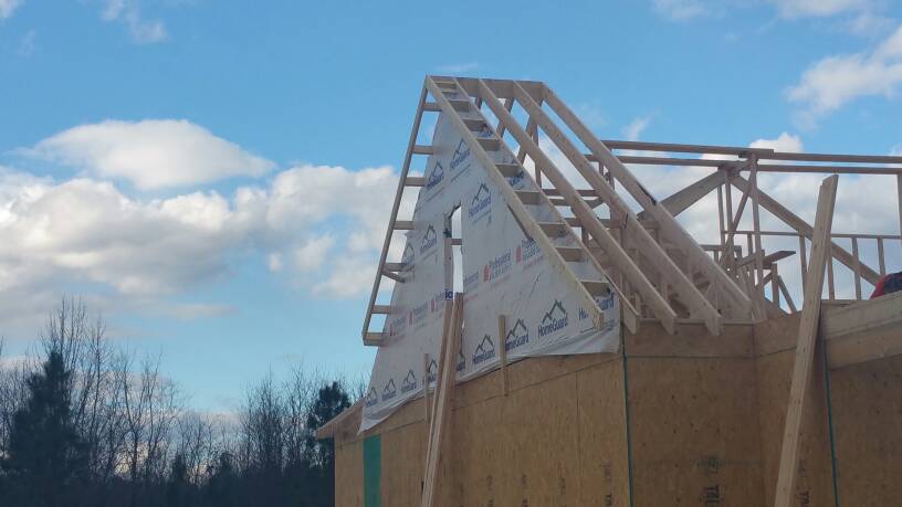

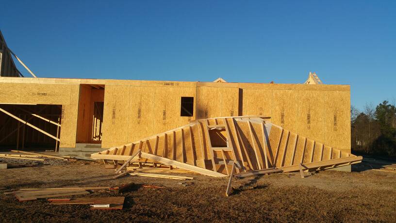

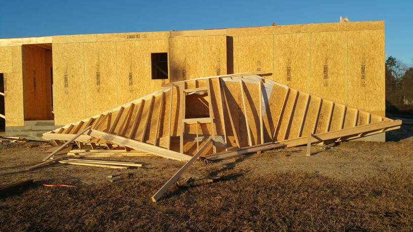

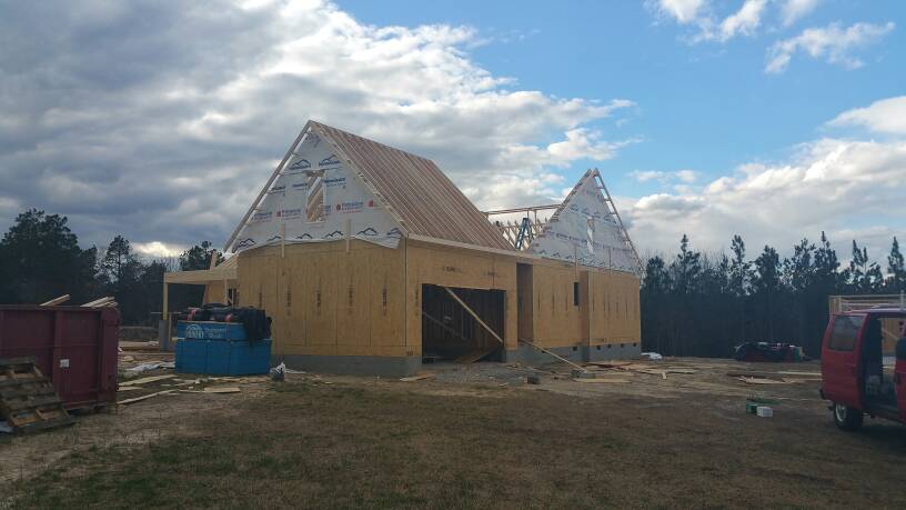

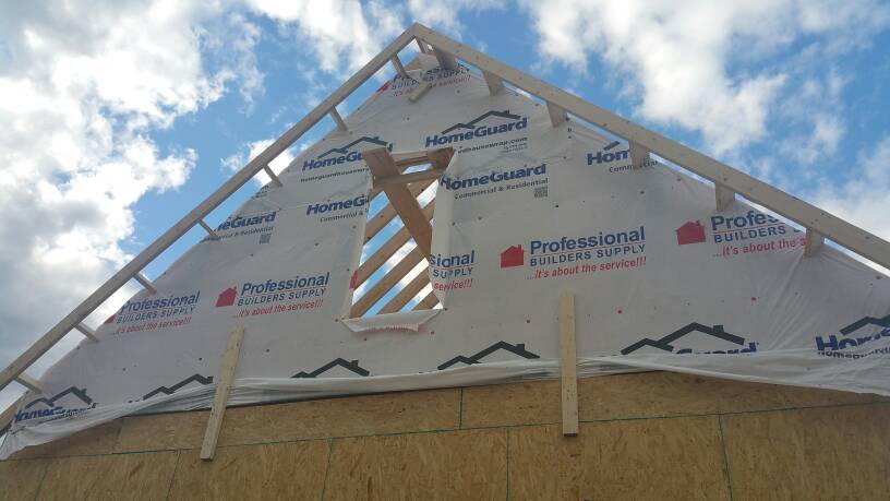

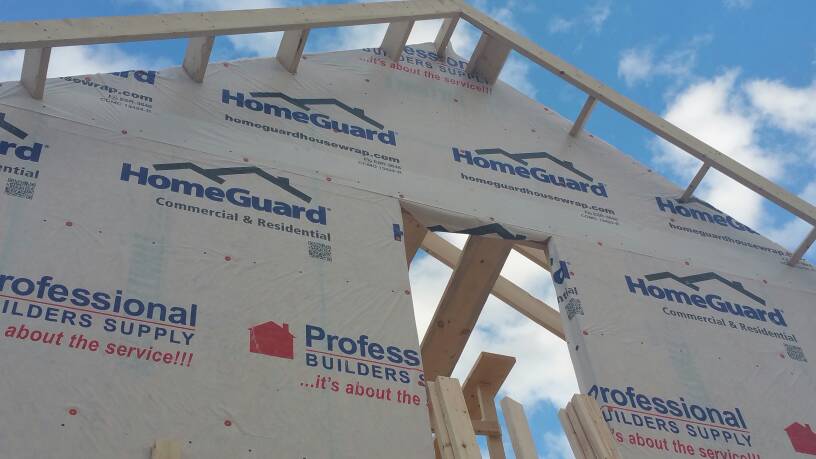

Well it stormed pretty good last night. We lost one of the roof ends - looks like the framers will have some extra work this AM...

Make sure that they rebuild from scratch, not prop up the damaged parts. It is Your house and you want it done right. Twisted broken lumber is trash.
But, put in more faucets outside than you think you should. Much easier than running through a fence you built later. And extra outlets heep plenty!

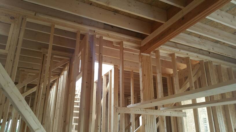

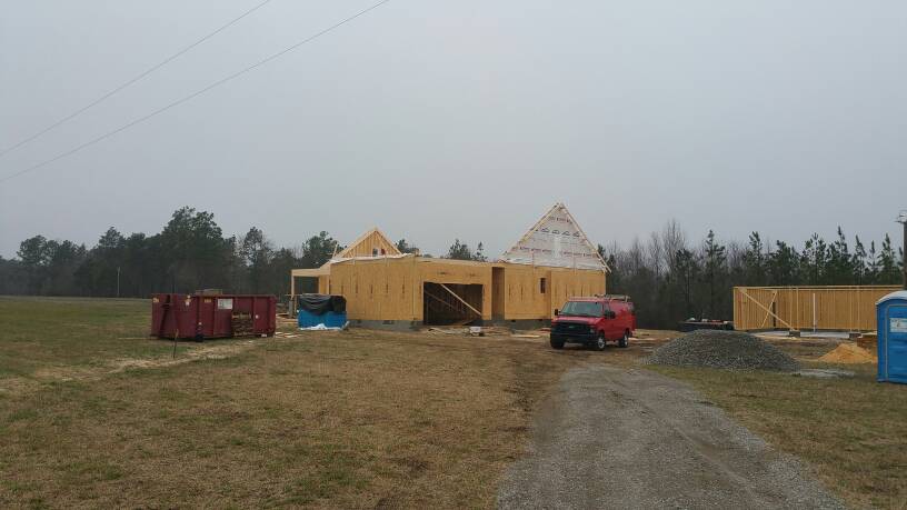

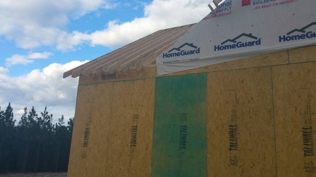

We had one step backwards with the storm, but today the framers have made some good progress...uploadfromtaptalk1456438660437.jpguploadfromtaptalk1456438668338.jpguploadfromtaptalk1456438676559.jpguploadfromtaptalk1456438684881.jpguploadfromtaptalk1456438694844.jpguploadfromtaptalk1456438704951.jpguploadfromtaptalk1456438710841.jpg
