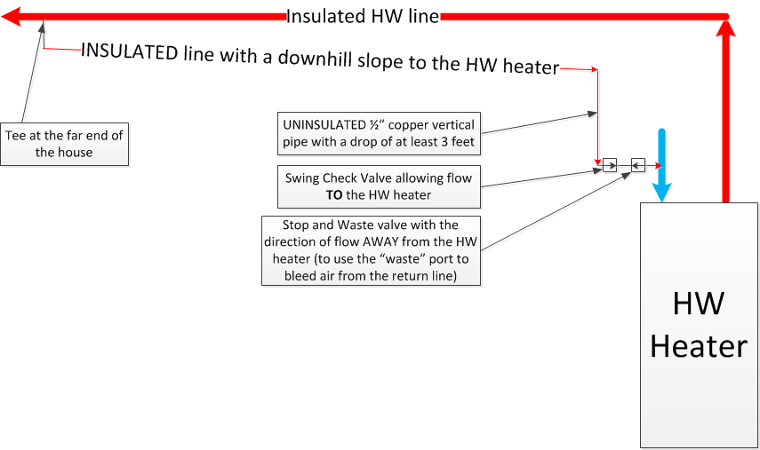

I setup a thermosyphon loop on our hot water heater which keeps the water at the end of the loop (~50' away via 3/4" copper) toasty warm.
It took ~$20 in parts and some thinking to make it work, but it didn't require a pump or any electronics and only has one moving part (a swing check valve).
It will only work if the hot water heater is below the hot water lines. I based it on a diagram that the furnace guy wrote on a box :D.

Below is how my system is configured:

I fail to see how the system you show would have any chance of working. The water pressure within all of those pipes is essentually equal and therefore not capable of opening any check valve allowing flow one way.
/ New Home - Recirculating Hot Water #12
Hence the swing check valve. It has a flapper that swings open and shut (NOT spring loaded) so the water drifting past (as it cools down in the uninsulated pipe) will open it but it cant flow backwards.
That was the thing that the furnace guy stressed, it MUST be a swing check valve or the system will NOT work.
It works very well for us.

^^This is the type of system tha is being promoted for our new home. A plumber / friend told me this was the real deal. IF we have a circulating problem....then we could always add a circulating pump (doubtfull as our water heater is at the low point in our loop). Also the pump could be put on a timer to save electric. We will have our bathrooms, kitchen, and two laundry areas served by the hot water loop.....so this system sounds like a winner for our needs. Those instantaneous heaters may be good for sink purposes.....but I think the maintainence issues could be a problem over the long pull (?).

I am still doubtfull about any valve working as there is zero pressure differential or in other words nothing to make the valve open and close. Perhaps even without any swing valve the cooler water would settle in the return line and head back towards the water heater. Perhaps this does work but many times what people think does not meet scientific reality. I would like to know why this isn't common knowledge in the plumbing industry as you have an almost perpetual motion machine.
/ New Home - Recirculating Hot Water #18
If you look at the valve, the flapper just swings back and forth. When I brought it home, it just rattled around
Well, cold water falls, as water cools off, it drifts down the pipe and into the cold water input. I can feel the temperature differential on that vertical copper water pipe, MUCH cooler at the bottom than at the top.
The furnace guy has been working with boilers and furnaces since he was ~10 (according to his stories anyways) and really knows his stuff. He was the first person who could look at my system (wood boiler tied in with oil boiler) and tell me something that I didn't already know about it. If anyone in the area wants his number, I would be happy to pass it on.

When I remodeled our house a couple of years ago, the plumber added a thermosiphon line for the master bath. It is on the second floor on the opposite end of the house from the hot water heater in the basement. When you turn on the shower, you have hot water in less than 5 seconds. No pump, works like a charm. This is nothing new. I'm sure people have been installing these for over 50 years.
/ New Home - Recirculating Hot Water #20
Piped properly, the gravity return or thermosiphon piping arrangement will work and alot of plumber install them. The check vavle is more to prevent the hot water from flowing backwards and allowing the piping to get warmer on the return side and causing the system to stop flowing. Many plumbers will not plan ahead far enough to install a working system or the owner / general contractor makes changes that will not allow the system to function properly. Pipe routing is critical.
