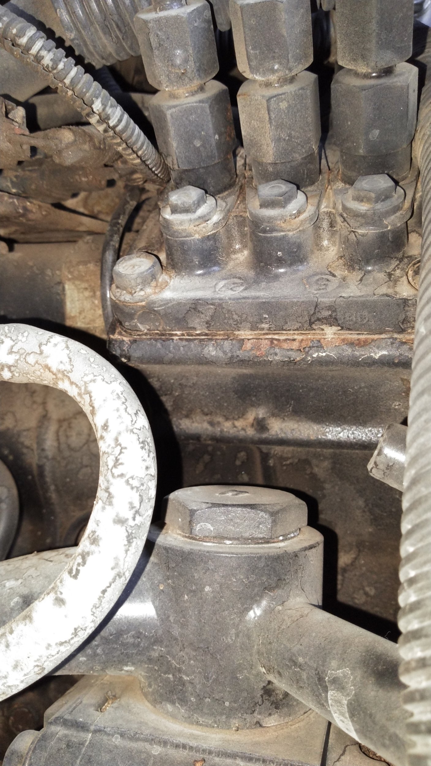

Our 2015 New Holland Workmaster 33 has a Shibaura N843T-F-24 engine. I Looked for the the throttle lever on the injector pump and can not find one. Is it inboard where I can't see it? Any Suggestions
   / New Holland Boomer 37 in DPF Shutdown Mode #48
Your photo is too close to point out where the lever is. Basically, when standing beside the tractor right behind the front wheel. Look at the bottom right hand corner of the injection pump where it meets the timing gear assembly. There is a small inspection plate covering up the throttle lever. Remove the cover and you will see the linkage underneath there. Just loosen the bolts that prevent you from being able to adjust the throttle. There is one for RPM up limit, and one to set idle. Just make sure you do not let the engine run higher than 2,500 rpm or you risk engine damage.
I will get a couple pictures so you can see what I am talking about.
   / New Holland Boomer 37 in DPF Shutdown Mode #50
Thanks found it. Which one is for the upper limit? Maybe the forward one? Lower limit? how many turns did you back themoff from the lock down position or did you remove them completely?
