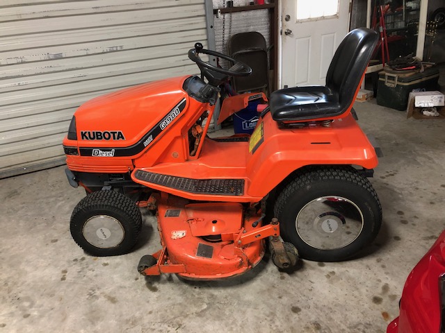

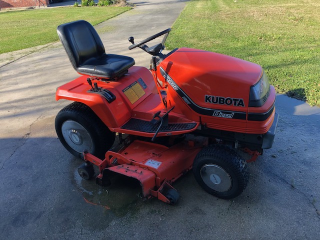

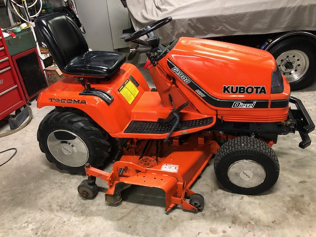

Hi everyone. So I just swapped my 1998 Gas EZGO golf cart for this Kubota G1900 with 605 Hrs. It has the 54" deck.
I have a few questions about it.
1. Is there any source for free download of a owner's manual ?
2. Yesterday the temp gauge worked and the Fuel did not, Today it is opposite. I assume a bad connection, I have already checked the fuses they are good.
3. Oil filter ? Is the Kubota one needed or is the price the same for a AM ?
4. Deck comes off easy ? Looking at it it does not seem to bad.
5. Did all of these come with fuel cut solenoids ? This has a make shift lever attached to the throttle linkage to kill the motor
So my plan is I have 2,5 acres and I have a 60" Exmark. I plan to use the Kubota for yard work and a backup for the ZTR.
I plant to remove deck, clean it rust extend it, check spindle bearing condition and then change all fluids.
Any tips or pointers appreciated.
I will try to attach some pics.

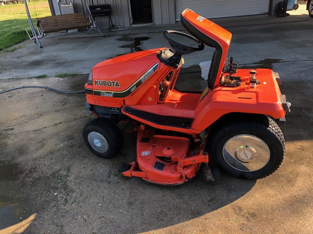

All refresehed up now.
