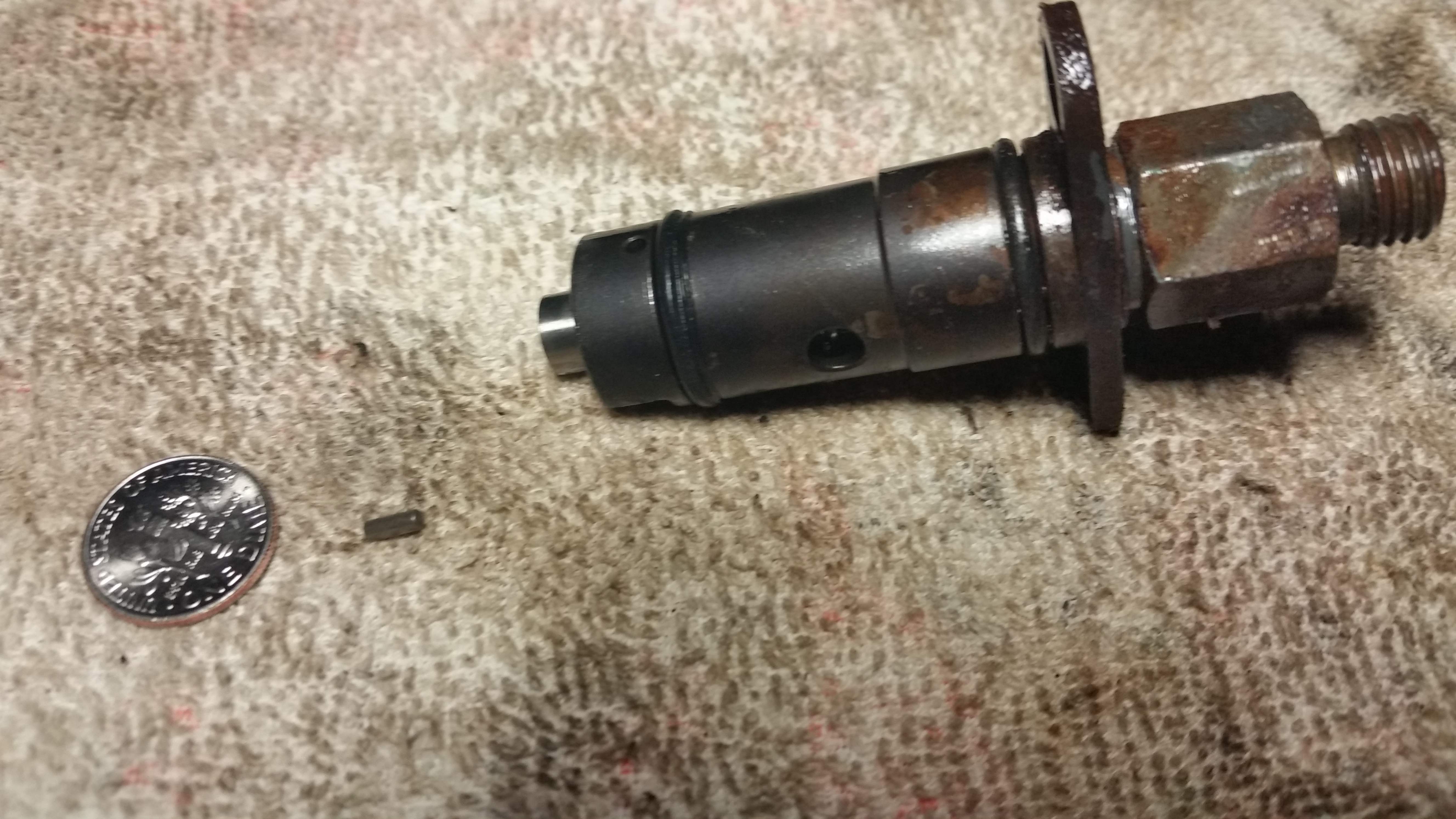

Make some progress on my new G1900. Found the hot wire from the battery to the regulator had got hot, arc'd and melted the connector to the regulator. The male side of the connection was broke off and sparking and getting very hot as even the insulation on each side was burnt. I hard wired this around the connector for now. She still overcharges to the tune of 15.5 volts at mid throttle. I suspect all the high amp and intermitten contact blew the regulator. So I will order up a new one to replace it. Looks like a fun job to get to where its mounted. I solved the fuel leaks, replacing the 2 O rings on each injector element and putting them back into the pump body in the exact position they came out along with a new electric fuel pump to replace the original one that was dead. Once she was back together and running, I swapped my bar tires in for the worn and worthless turf tires. New front tires are planned, probably Verderstien 5 rib or Goodyear tri rib. Turfs are no fun to clean of packed mud after a plowing even. Now if only I could find the factory 3 point hitch!! Guess I will put a Johnny bucket products electric lift sleeve hitch on her. But if you have the complete cat 0 3pt hitch to sell, please let me know. Something to move snow is also on my need list. Baby steps, warmer weather will gain much more progress of restoring this old girl. Mike

Make some progress on my new G1900. ...................zip..................... I solved the fuel leaks, replacing the 2 O rings on each injector element and putting them back into the pump body in the exact position they came out .............zip............... Mike
Are you talking about these O-rings in the delivery valves?
If you are, I have the same issue in my V1304 4-cylinder engine in my F3060 mower.
As far as I understand, in this type of injection pump the amount of fuel delivery is adjusted by slightly rotating the delivery valve, before locking it in place (please correct me if there is more to it?).
Have you operated the engine much since after the O-ring replacement - if so, any issues with fuel delivery IE. visible excess smoke or other issues?
I could easily remove the pump and send to Diesel injection pump shop, but just trying to keep down the cost!
Any help or positive suggestions will be appreciated.

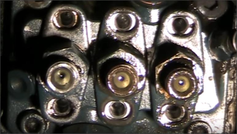

These are not photos of my engine, just something I found online:
20151002_223401.jpg D722 delivery valve O-rings.jpg Snap 2017-11-19 at 09.02.47.jpg

Yep, those are the leaking O rings. I just picked up a cheap metric set of O rings at Harbor Freight and swapped them out carefully one at a time, making sure each unit went back in exactly in the same position it was originally in. The light twist movement they have controls flow rate to balance the pump. With those and a new overflow line from the rear injector to the pump body, the leaks are gone. Today I took the dash apart, tightened up loose connectors, fitted a plastic sleeve over the stop pins on the fuel and temp as the needles wanted to "stick" to them. I also cleaned everything up and polished the plastic lense for the dash. Now both my gauges work as they should. I ran her up to PTO rpm for the first time today and brought the mower deck up to speed. not to bad, bearings are decent for another year or two. I will go thru and regrease everything before we get to mowing season. Next up is to remove the deck, so I can remove the drive shaft to replace the worn rear yoke on the hydro pump its rattling and wore out, U joint is new but the yoke itself is shot. That part isnt gonna be cheap, but its needed before things fly apart or more damage is done.
