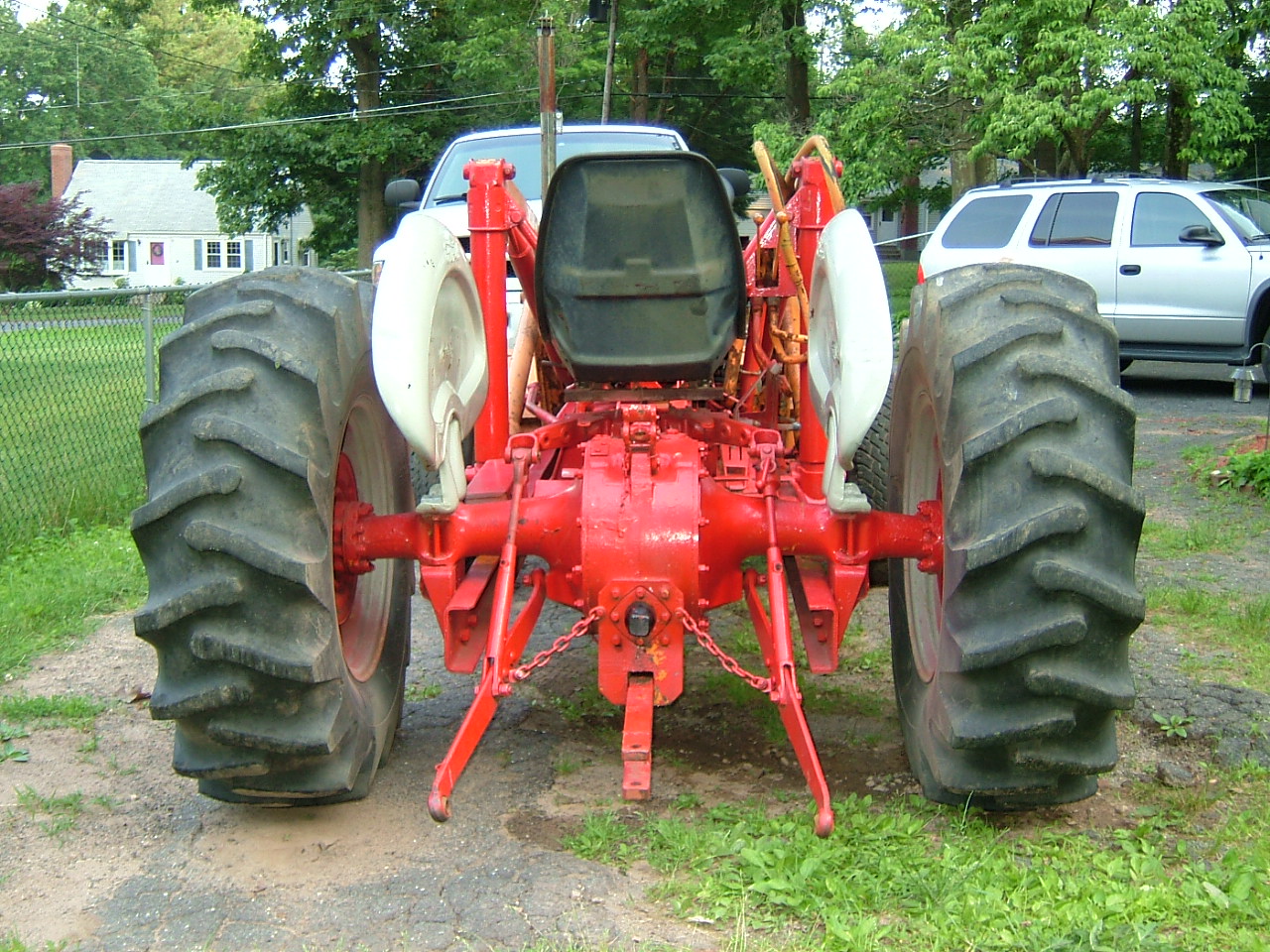

Soundguy, it looks to be orignal tranny, paint layers match up. Where could i find this "insert"? I have the parts and repair manuals that came with it, found the model #(871) stamping but cannot read the serial # yet. You all have been very helpfull !!
Nice looking tractor. I think you have a good basic unit there, from the looks of it.

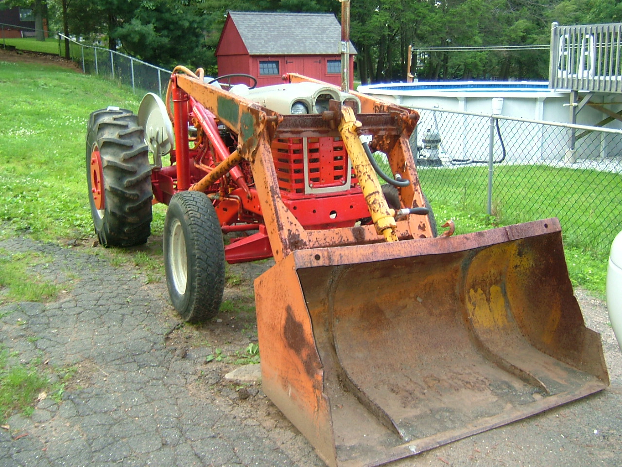

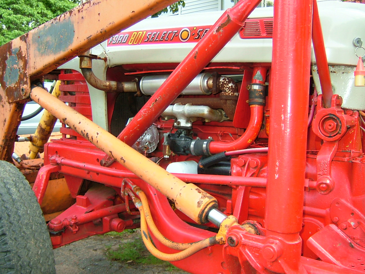

Tractor looks good, but I would be concerned about the "hatchet" job on the loader. Someone converted the loader from two tilt cylinders to one. The amateur looking job looks bad and could possibly be unsafe. I would be very careful when using or better yet look for a different loader.
The tractor looks like it could be an industrial model with the HD front end and yellow paint under the red.

Lets see a pic of the front end.

Im currently looking for 2 cylinders to make it right, pics of front end on 2nd page ok?
