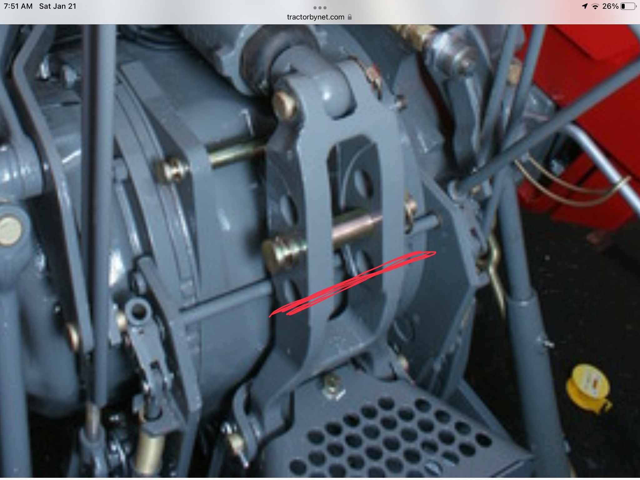

Also, besides the draft handle all the way down
The draft lever needs to be in the down position for minimum sensitivity. I use this feature all the time using a grader box. I just don’t understand why this is so hard for everyone to figure this out.
AND the top link should be in the lowest, least sensitive position hole on the 3pt top link attach point
Actually, the backhoe manual suggests using the top link hole which is closest to the draft control spring (which would be the most sensitive position). I wondered about this part of recommendation for a while. Why would they want the top link in closest to the draft spring, which would cause the backhoe to bounce more (as it forces the draft control spring back and forth).
Finally, after doing quite a bit of online reading, I discovered that a potential weak part of the whole setup is the top link bracket on the tractor. If you read online, sometimes the top link bracket on the tractor fails under the stress of the backhoe. I think they want the hole closest to the draft spring used because in many cases this is the most robust place on the tractor top link. Perhaps more importantly, the draft spring acts like a "shock absorber" for the backhoe to prevent breaking tractor castings which fasten to the other end of the tractor top link bracket.
I looked pretty hard at my tractor and agreed with the manual that the holes closest to the draft spring in the top link bracket is the best place to use. Even if that part breaks, it's easily replaceable, whereas if a casting on the tractor rear differential breaks, that would be very bad.

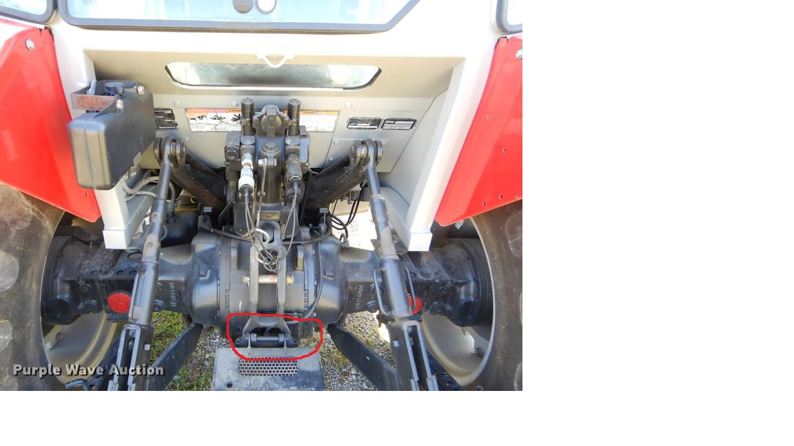

I really wrestled with which holes in the tractor top link bracket to use for the for the backhoe attachment. The manual clearly states to use the pair of holes closest to the draft spring, which in the case of Massey tractors, would be the top pair of holes in the bracket.
However, using the top holes will give more spring action, thus more movement, which is undesirable from an operator point of view. But I think the backhoe manufacturer surmised that the pair of holes closest to the draft spring is the most rugged place in the top link bracket to pin the backhoe vs. the castings which hold the lower portion of the tractor top link bracket. The castings on a Massey tractor don't look that rugged to me.
I don't know if you can tell from this picture, but the lower portion of the top link bracket has two castings inside the ears of the lower portion of the top link bracket. Those two castings hold the lower portion of the top link bracket on the tractor. They don't look super strong to me. I think your tractor you pictured earlier is a bit different?
I've chosen the top pair of holes because if the guts inside the draft spring break, it's the easiest to replace, vs the casting on the tractor which holds the lower portion of the top link bracket on the tractor.
I'm still not 100% sure I like pinning the backhoe to the very top pair of holes, but it does make some sense.
