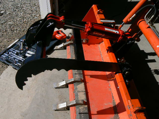

I recently purchased a grapple from Andy Tatro and a WR Long electric valve kit from Carver Equipment. I used the thread below for help with installing the grapple and cut the spaces into the lip of my bucket so the grapple arms can extend down further. I also notched a piece out of the grapple arm, as Mad Ref did, to help in getting the grapple extended - see link
http://www.tractorbynet.com/forums/customization/79451-tatro-wr-long-grapple-combo.html
I received the 2x6x1.125 cylinder (didn't see Mad Ref's suggestion about the 8" tube being better until after I bought the grapple/cylinder combo) that Andy Tatro had shipped to me from Surplus Center.

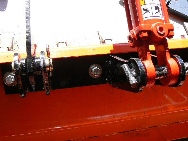

My problem is that there is a 11" gap between my toothbar and the grapple-see attached pictures.
Obviously this won't do so, as I see it, my options are as follows:
1-replace the 6" cylinder with a 12"+? cylinder
2-cut further pieces out of the bucket lip so I can get the grapple base plate flush up to the inside edge of the bucket lip. This would require the drilling of new holes into the bucket. If I do this the grapple base plate would move forward 3/4" to the inside lip of the bucket and give further reach.
Any advice would be much appreciated as I don't want to make any further mistakes

Humm, Interesting problem.
Don't cut the bucket any further, the top ridge gets its strength from the formed edge you are cutting.
The grapple is not made to mount on that type/angle of surface.
Consider this:
See the angle iron welded to the bucket on the ends. You will need to fab somethng like that for the grapple base.
Extend the cylinder all the way and hold the grapple front in touch w/the bucket cutting edge and this will be the geomety the base must be mounted at in order for it to function.

Here are a few ideas.
Disconnect the existing cylinder, with the grapple in the closed position, measure center to center cylinder mount. This will give you extended lenght needed. (You probably already figured this out.) Next open the grapple up and measure the distance of the retracted lenght of the grapple to make sure that the opening will be a useable opening and that it does not open beyond center. (not a problem if you are careful.)
I would personally try either of the following:
Try to create a different mounting point to change the angles associated with the grapple. How do the angles look if you set the grapple an angle simular to the mounting of the hooks?
Do you have access to a welder? A change in the cylinder mounting at the bucket might be all you need. (Could be checked by creating a templete and changing the angle of the bucket end mount and start measuring distances.)
I am in the middle of creating my own grapple and I found that a small change in 1 angle creates a lot of difference elsewhere. I was trying to be able to use 1 cylinder for 2 different applications and found that a slight angle change and small distance change could add up to inches elsewhere. (I won't be posting about my grapple until it is completed, sorry.)

northland I agree with shaley. Take the grapple off and start over weld a heavy piece of angle across the top lip just like where the chain hooks are and mount the grapple there. also as Shaley stated do not cut the bucket lip it will weaken it. Good luck Frenchie.

Looks like you guys were right about adding a strip of angle iron to the top of the bucket.
Today I placed a 1/2" piece of wood under the grapple base mounting plate to give it some additional height but it didn't help the geometry enough as the base was still behind the bucket lip. So, I still had a 11" gap between the grapple and bucket's bottom lip.
I don't have a welder but I am sure I can find someone to weld some the angle iron onto the top lip of the bucket. I figure a piece twice as deep as the angle iron holding my bucket hooks on should do the job nicely.

Just saw your thread tonight. If you read my grapple install thread, you saw where I added a square tube to the top of my bucket. Then mounted the grapple base to that.
Shaley is on the right track, IMO.
First, extend the grapple cylinder all the way out and place the grapple assembly so that the tips of the jaws are where you want them. That might be at your bucket teeth or at the bucket lip. Either way, when you get the jaw tips where you want them, you will see what the base needs to look like. If the base sits too far behind the top of the bucket, shim it up with a 2 x 4 or a 1 x 4 until the base of the grapple is above the top of the bucket lip. Note the angle of the base too. That is what your "shim" needs to look like. Make one out of plate steel or tubing and weld it to the top lip of your bucket. Then drill and tap it to mount your grapple base on. With the "shim" the right shape, it should work perfectly with the 6" cylinder.
If the grapple base is too far forward of the top bucket lip, move it back and do the same thing. But I don't think that will be the case. Either way, moving it (the grapple base) up from the top lip and tilting the grapple base will let you put the jaw tips where you want them. You just need to make the shim the correct shape. The correct shape is what the gap between the bucket top lip and the grapple base looks like.
In my case I used a 2-1/2 x 2-1/2 steel tube and it came out pretty good. If I had it to do over again, I would have shimmed up the back of the tube more than the front, that would have been perfect for me. It would have pushed the jaw tips out more towards the bucket lip. But I like it like this anyway and it works fine. You can see one advantage is that it closes pretty deep into my bucket and really holds loose stuff tight.

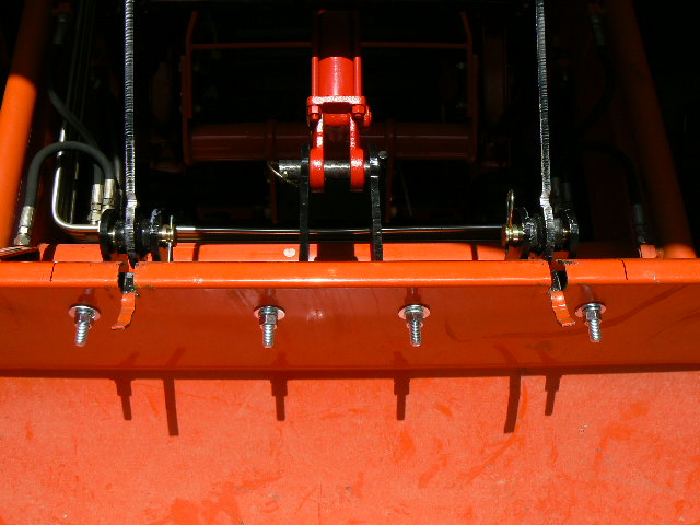

I did as suggested and experimented last night. It seems that a 31" long piece of angle iron (like the pieces tat hold my bucket hooks in place) that is 3" wide as well as 3" deep (3/8" or 10 mm thick) welded in place along the top lip of my bucket would brace the grapple plate very well. The grapple mounting base plate it self is 3" deep so it will fit very evenly on the angle iron. Also, since the angle iron is 31" long the grapple mounting base plate's 24" should get more evenly distributed over the lenght of angle iron.
Once I had that base plate welded in I can drill holes in it and mount my grapple plate.
With this set-up my grapple teeth would recah right down to the lip of my bucket allowing me to pick up and hold fairly small pieces of wood/rock etc.,
I am not sure why using a tube as a mounting platform would be better then the angle iron?

A tube mount is not necessarily better...
In your case, as I understand it, you don't need to elevate the grapple upwards. It seems the angle iron gives you the correct platform to mount the grapple on and that's most important. In my case, I wanted the elevation up from the bucket to make the grapple go inside it, instead of hitting the bottom or the lip. I needed to raise it up off the bucket lip in order for that to happen. Glad the new location works out for you. Now we need some pictures of it open and closed.

update-I had the piece of 3x3"x31" angle iron welded to my bucket and installed the grapple/electric valve kit.
Everything worked OK (I picked up a few very large maple trees and some large pieces of slate) until I noticed a slight oil leak from one of the quick disconnect hoses. I have to replace the coupling going into the cylinder. It was either defective or it got damaged when the hoses stretched a bit when I curled the bucket all the way forwards.
The sales manager at Carver Equipment recommended not buying the QD plate that WR LONG sells as an option. He suggested that most people use industrial twist ties. That was bad advice as we installed the QD hoses with twist ties and the hoses had way too much movement and rub their couples along the loader tube. Now I have to either order that QD plate from Carver/Long or have something fabricated locally. That and I have to have the hose coupling fixed.
Regardless, the grapple/valve kit works beautifully and was a very worthwhile purchase
I will post pictures as soon as I have the hose repaired and have the new addition painted orange
