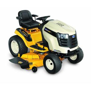

Here's a pic(I hope)

Good deal and congrats to you! It's a nice machine for $2999. They're big and comfy. It will also have the Hydro-Gear G730 trans which is great. It's got it's own spin-on filter and is serviceable : Hydro-Gear - Products
Set the deck up so it doesn't bang around on the ground and you'll get years of service out of it. FWIW, I had a Courage 20hp V-twin on my last machine and liked the engine very much.

Looks like good solid GT also fair price..like the arm rest.
Keep us updated on unit handles.

Congrats on the purchase, looks like a nice rig for a good price. Great advice from JT. Follow the owners manual closely with required maintenance and you should be good!

You did good brother. To be honest, if I was in the market for a comfortable, large capacity mower with some GT capability, I'd get exactly what you got. You got a real good transaxle on there, nice large tires/wheels and a decent frame.
The only somewhat weak point I can see is the deck 'suspension' (if that's what you want to call it). The reason why I stress making sure you don't let that deck beat itself against the ground. The hangers aren't as robust as what you'd see on a 2K series or Z-Force.
