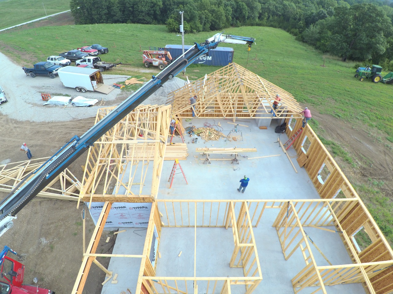

Seeing the pics of setting the trusses with a truck boom is an example.
A good friend of mine is building a new house. I took this pic with my Drone. The person running the boom is the guy with the blue shirt standing in the middle of the pad. He even unhooked the chain by wiggling the boom. Amazing.
I love the 'great' space in the center of the home!
/ New garage time! #882
I hate the no attic space with trusses . As carpenter it makes no sense to me to loose all the storage space up there . Stick frame :thumbsup: My attic is packed with xmas decoratins etc. Small price to pay for another 1000 sq ft of storage. Talking about the picture not j's .:drink:
/ New garage time! #883
Most all the new truck cranes are remote. The lumber yard my buddy works at is getting a new 65 foot reach truck crane all remote control...
/ New garage time! #884
The guy who brought my 6 pallets of block used a remote control to opperate the crane, it was pretty slick.
Yep. This guy was faster than the carpenters. He'd be there with the next truss and have to wait a few seconds or a minute for them to have the last one fastened in place. He had a chain hooker at the truss pile.
