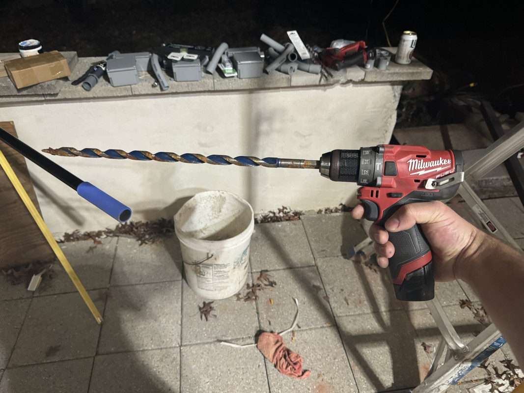

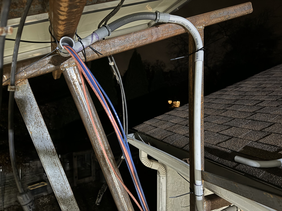

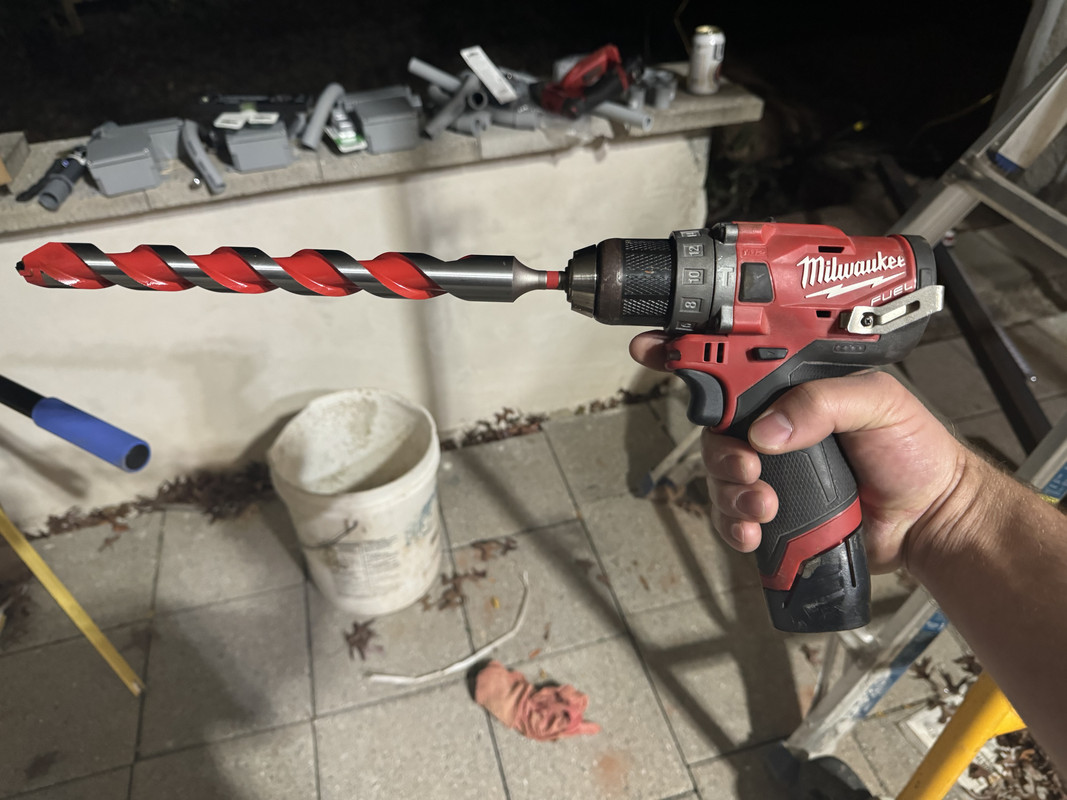

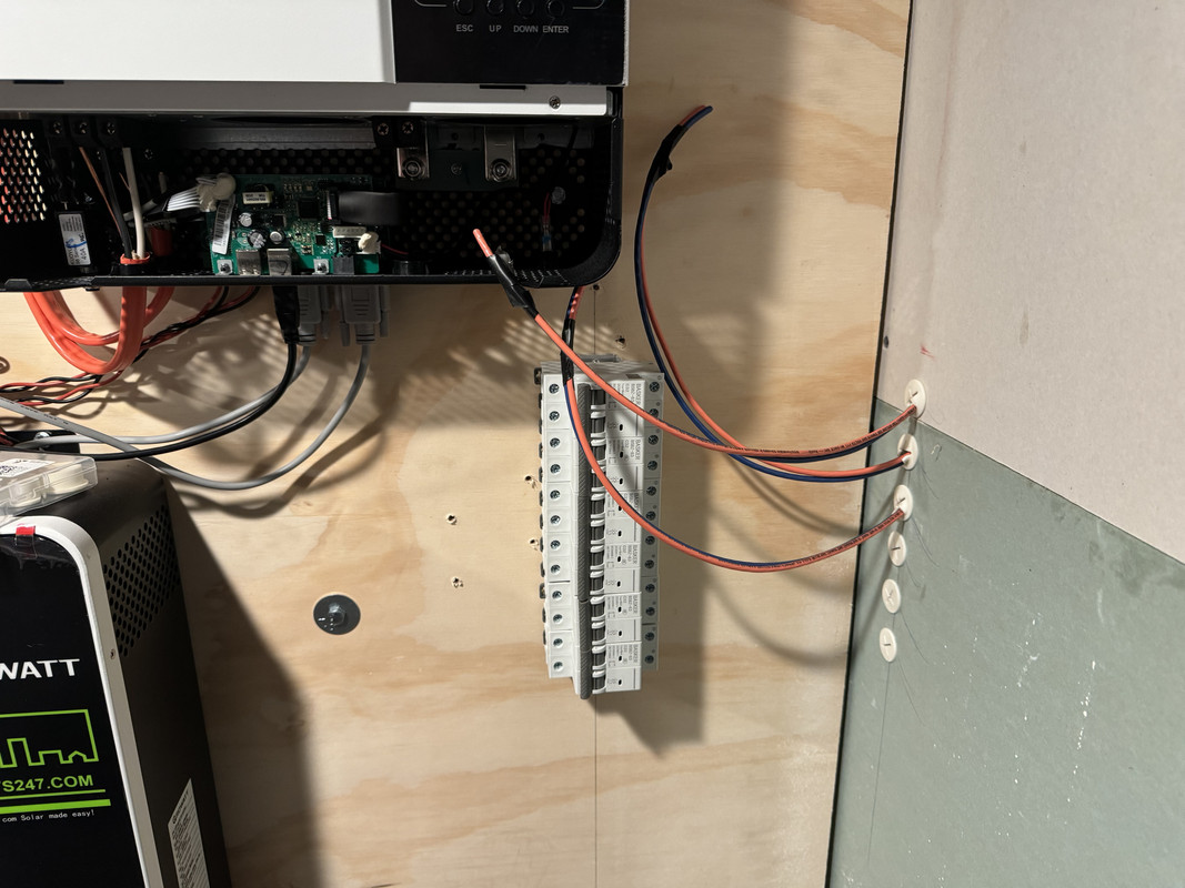

Had to punch through the wall to run electric. 1" wasn't big enough, I had to overbore it a bit. But the bit was to short, so I had to punch through and ruin a wood bit because it was the only thing long enough.

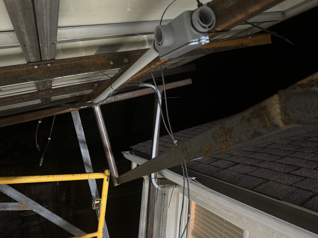

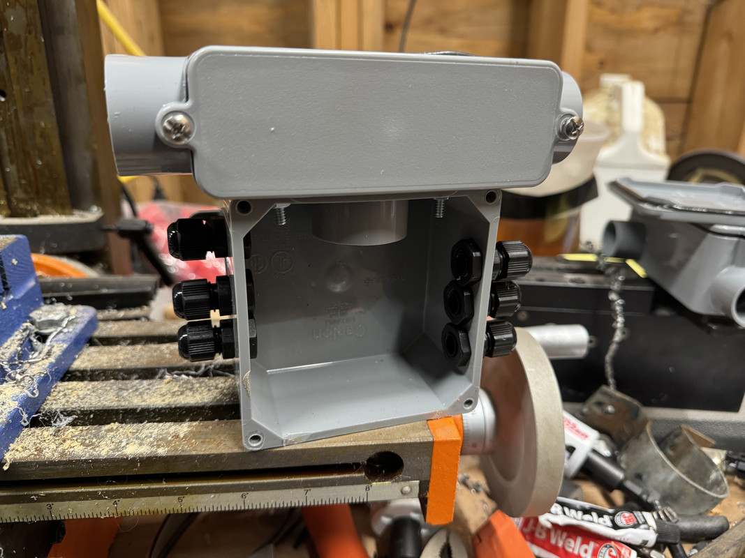

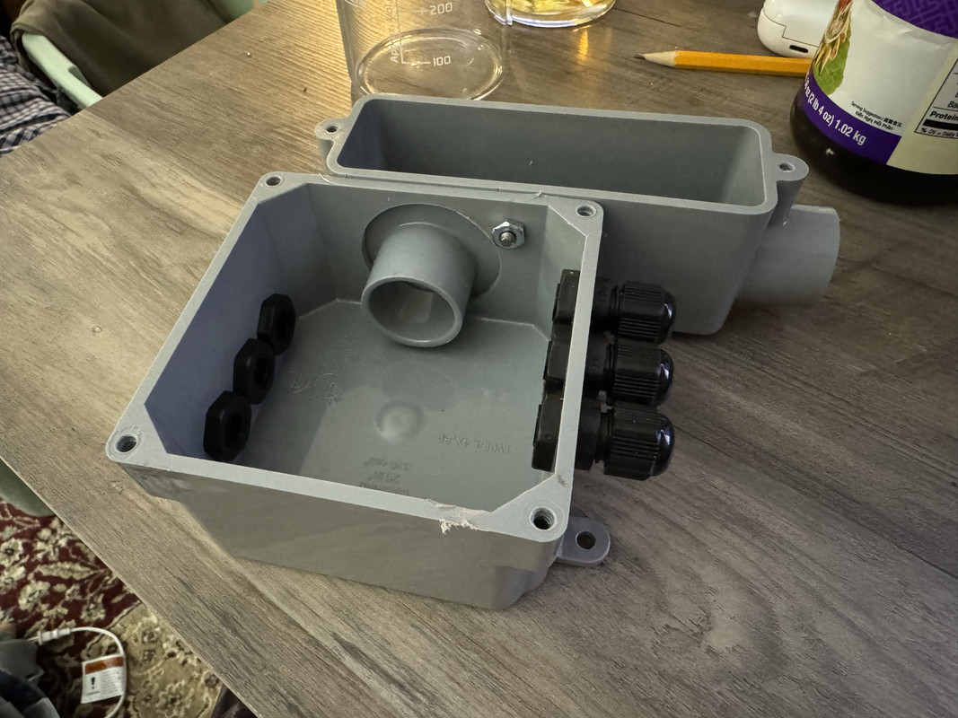

Got a good amount of conduit up zip tied and one of the combiner boxes made.

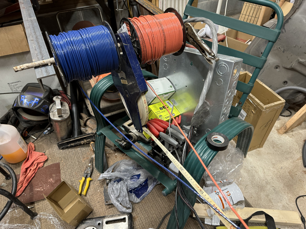

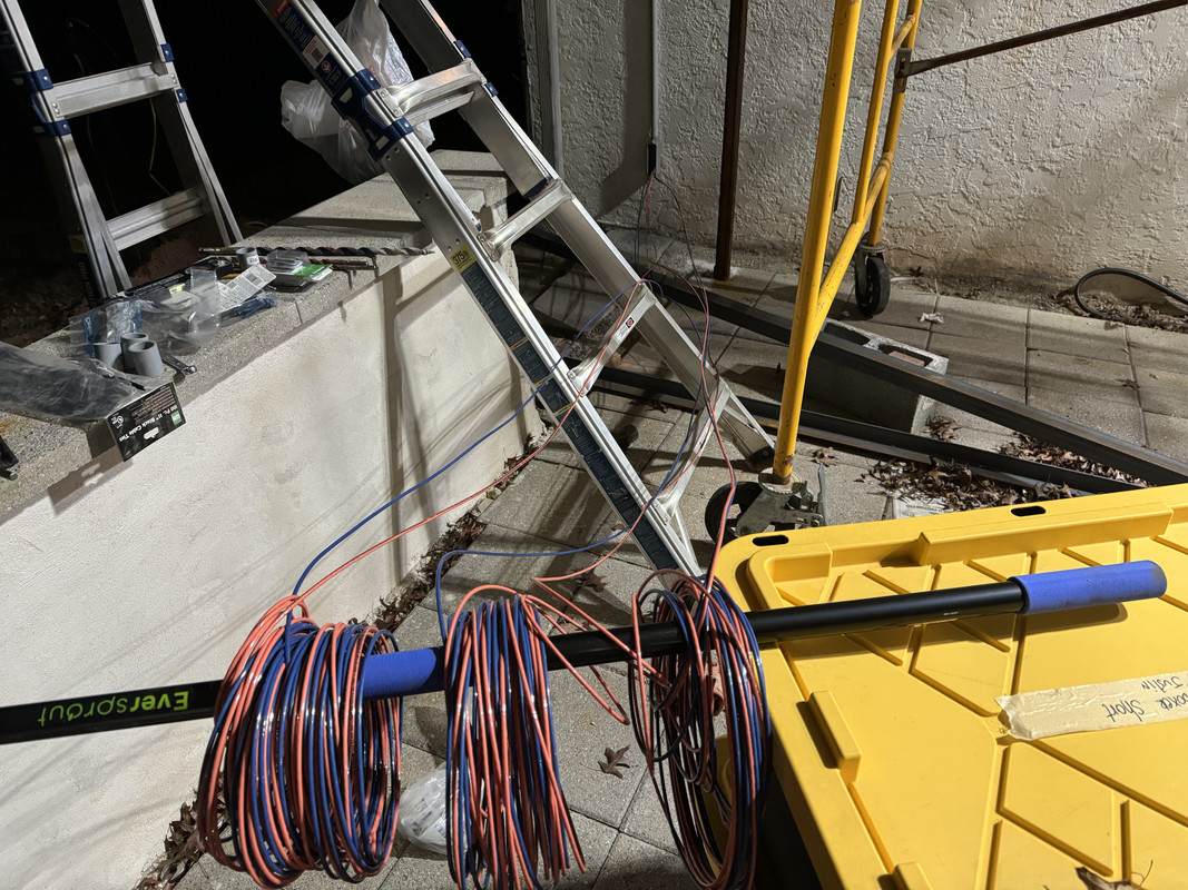

Installed breakers, finished a combiner box, got some wire, made a wire dispenser with a 300' tape measure so I can pull lengths. Ran a 40', 55', and 70'. Pushed inside, and then pulled up the first length.

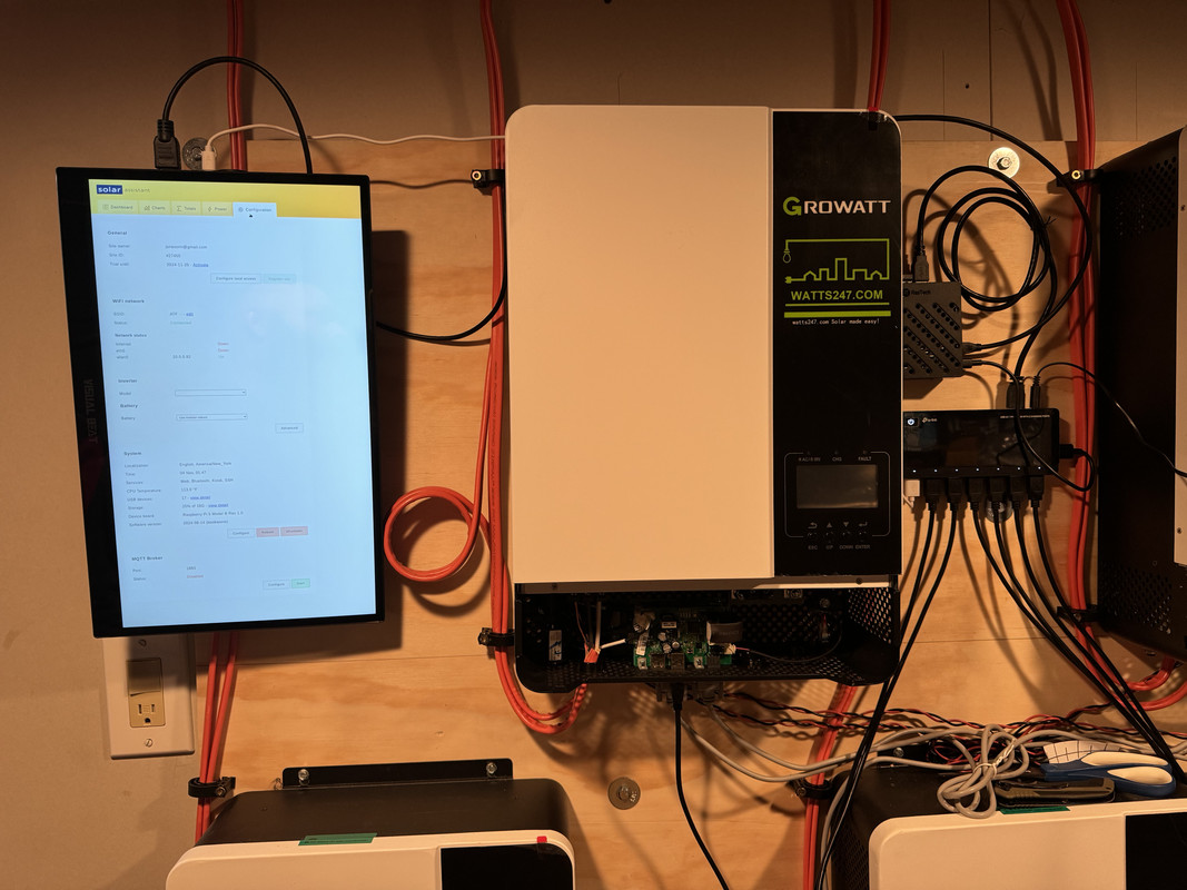

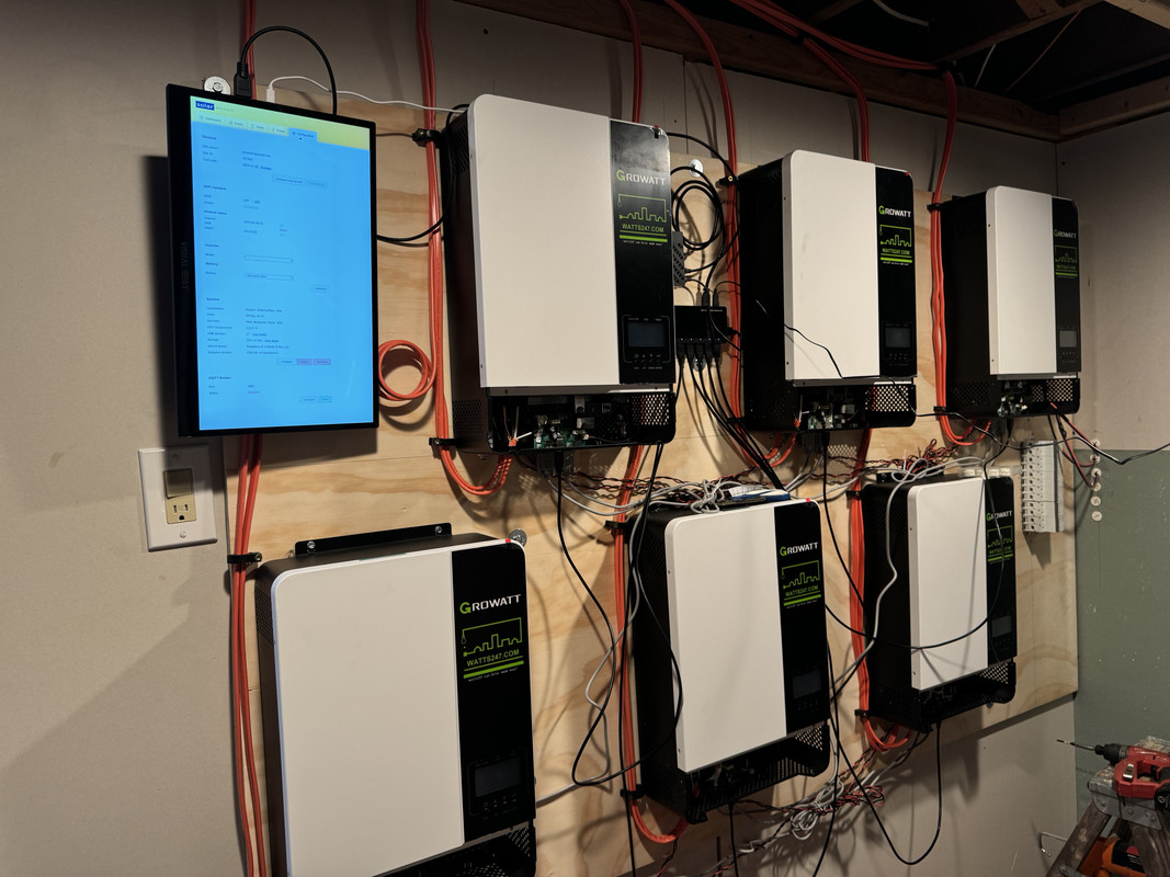

Got the rpi, hub, and monitor hooked up properly. It's running off an extension cord, but that shouldn't be for to long.
One more thing off the list, one day closer.

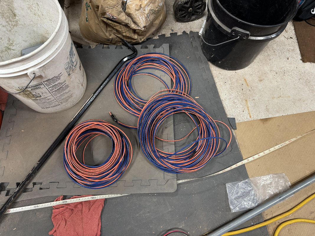

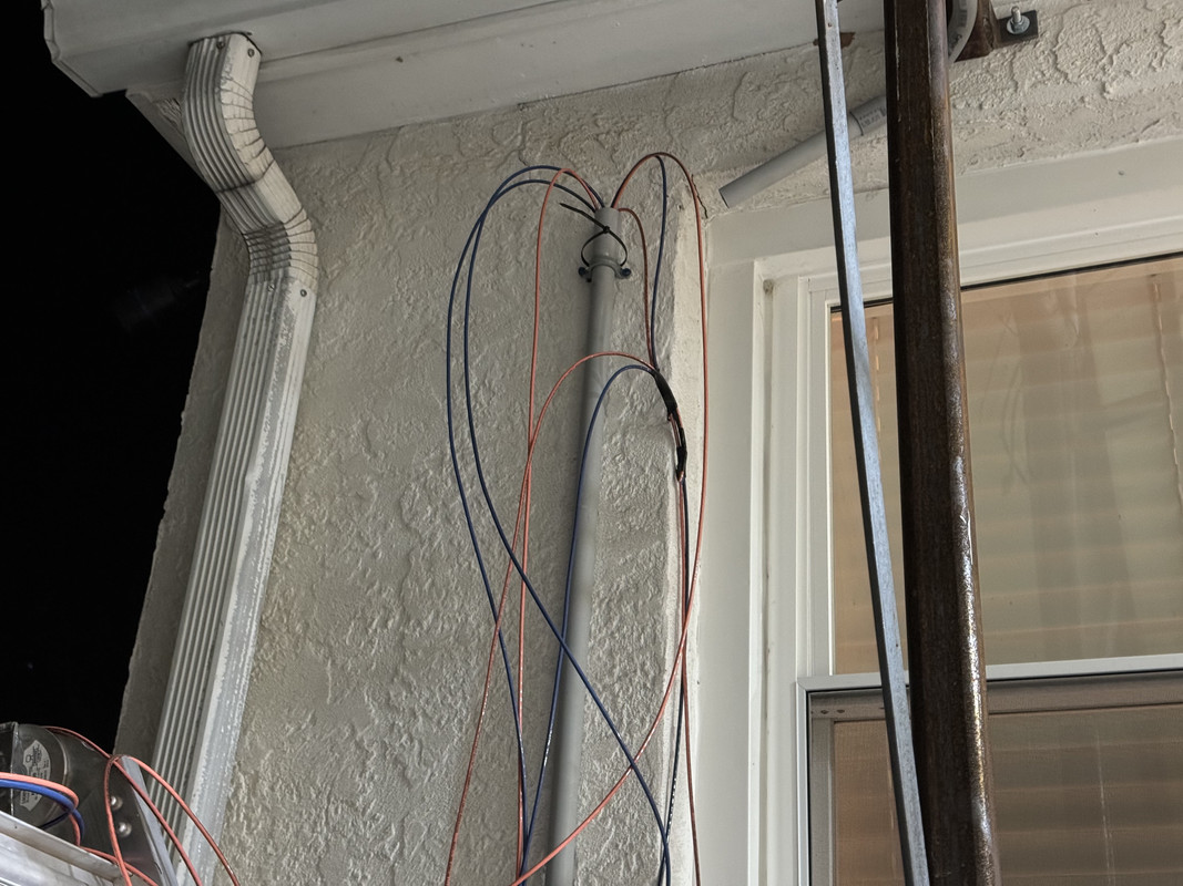

Pulled all the wire.
I used a copper deburring tool that I use for water lines on the grey pvc, to get rid of those hard angles to avoid damaging the insulation when I pulled the wire through.
I pulled the wire into the yard to avoid knots and kinks, then took each piece and slid it on and glued it in place. It was a bit annoying to do but there were to many angles to try and hope to push it all the way through.

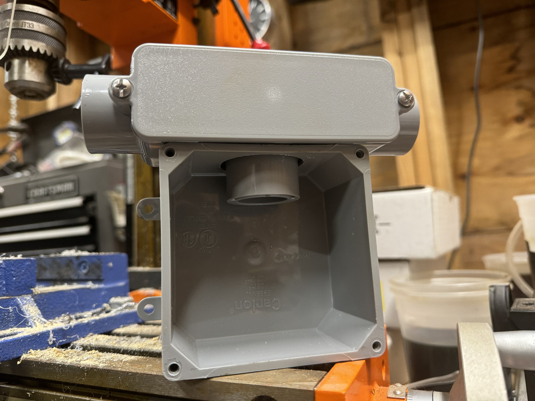

Made 2 more joiner boxes, so I'll have 3 strings in total feeding 3 the inverters.
