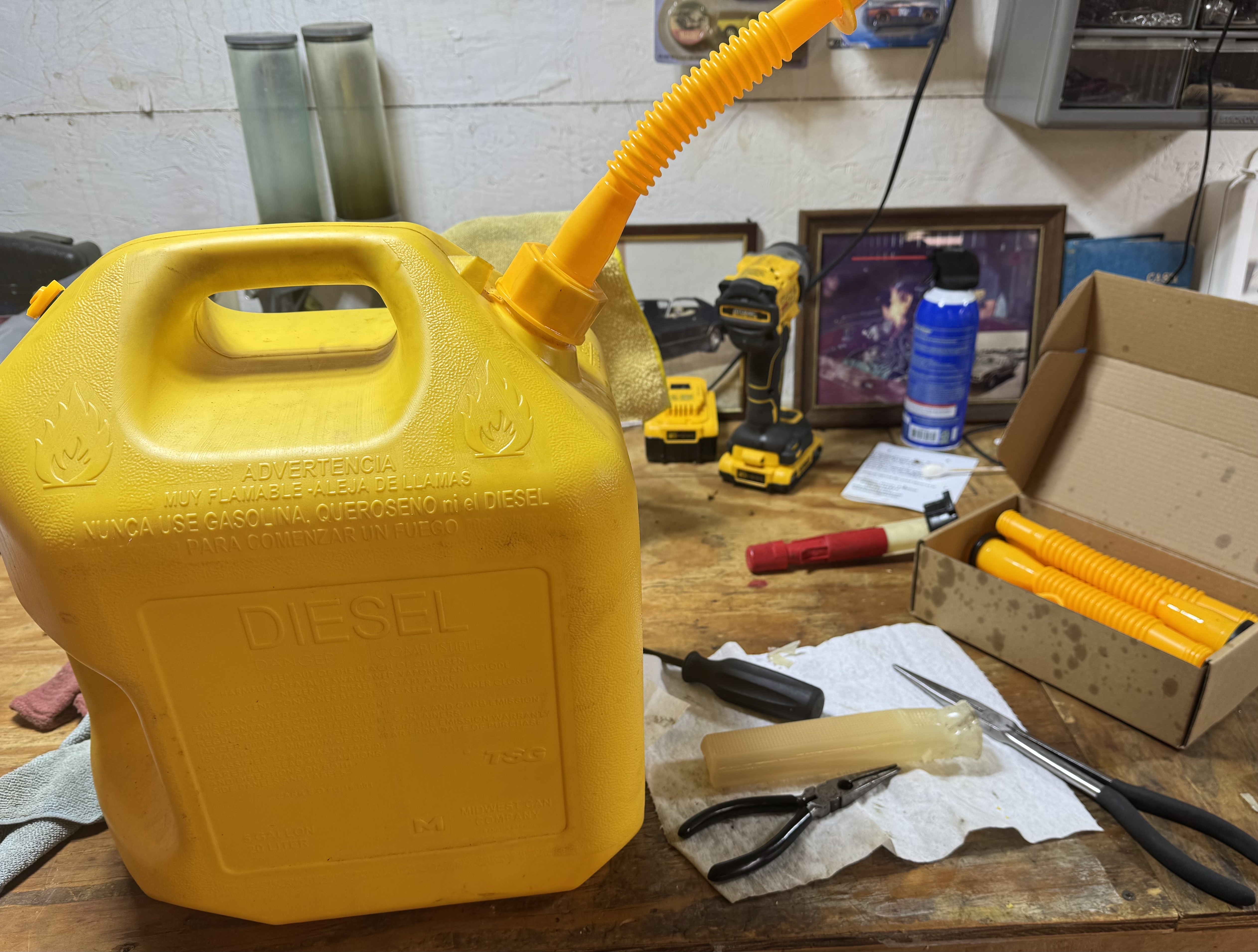

I installed one of the old fashioned nozzles in one of my new fuel cans. It also had the hard plastic hard plastic screens that extended several inches into the can. I spent less than 10 minutes installing the new vent and nozzle and 45 minutes getting that plastic screen out of the can. It kept falling all the way into the can and I had to mangle it up to get it out. I did rinse the can out with a little diesel to get any plastic bits out. The plastic screen is to the right of the can in my picture.

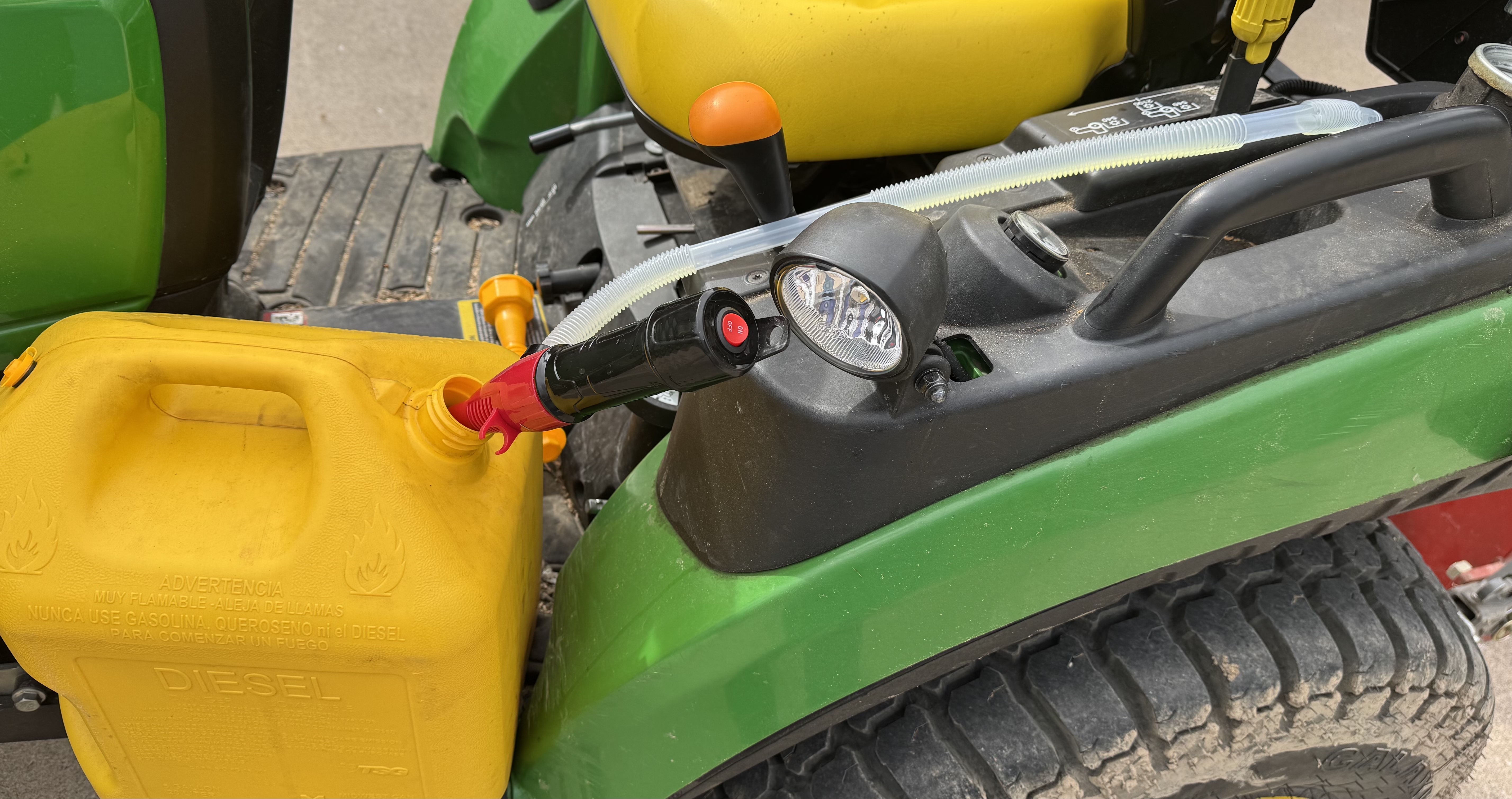

Il revisit this thread one more time. I used the can I have pictured above that is modified with the old fashioned nozzle and vent. That didn’t go well, it’s heavy and hard to get the nozzle in the filler, I spilled maybe a pint of diesel. The filler on my tractor is on the fender but is a little above waist height. Just about all my cans want to spill fuel when full be it the new mandated cans or the old style. I remember someone posting in the past “you don’t have to fill them up”.
Not filling them up to 5 gallons is an option, 2 or 3 gallons is much easier to pour without spilling but it goes against my grain to not use something to capacity. I bought one of those little battery operated transfer pumps at Walmart today, about $17, an 8 pack of D batteries was nearly as much. It works surprisingly well, for now. I read reviews on various websites with mixed reviews, I’m hoping to use it for just the first couple of gallons out of the can and then pour the rest.
I've been using one of those little pumps for several years. I've found that if I place the gas can up high, above the level of the tank into which I want to add fuel, all I have to do is turn the pump on for a couple seconds. That starts a siphoning action and the rest of the fuel will flow without using the pump.
I looked long and hard at the 2R's before buying the 3R, and nearly went home with a 2038R they had on the lot. I really liked many things better about the 2R's, and one of those things was that their filler neck is accessible from the ground. I love the location in the fender, so easy to reach, that I'm surprised you're bothering with a pump for that tractor.
The 3R's have it in the top of the hood, just forward of the instrument cluster, meaning you have to haul your gas can up onto the tractor, and stand on the footboard to fill while either holding the can in the air or balancing it on the steering wheel. It really sucks.

I’m 6 feet tall and the filler opening is above waist height for me. 5 gallons of diesel weighs 40 pounds and lifting a full can up a trying to use a free hand to get the nozzle in the opening is difficult.
I’ve found the new cans are easy to get up to the opening but then take a long time to fill the tractor. The new cans are fast but when full it’s easy to spill the fuel.
That makes sense. I have to admit that my admiration of that fuel filler location was purely from on-the-lot browsing, I never actually had to use it!
Re: 3033R, it always bothered me that, for something you're going to use so frequently, tractor manufacturers sure seem to put very little thought into the ergonomics associated with their fuel filler neck location. Maybe they just assume most buyers won't notice until after purchase, which might be true for first-time shoppers. But anyone who has owned a few tractors knows how much this can affect your love/hate relationship with the machine.

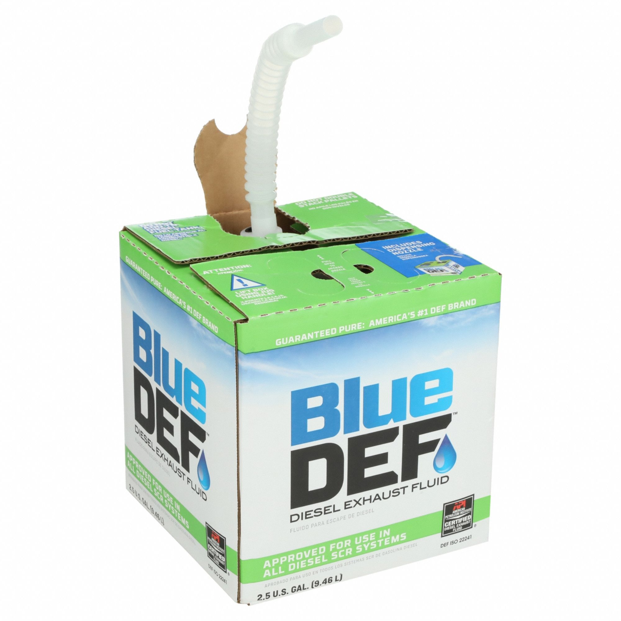

thats why i bought this, (man did it go up) Amazon.com i put it on the steering wheel and don't need to hold it
Dodge man, Where did you find those old fashioned spouts? I see the box of 4 -5 right there, I could sure use some of those but can't seem to find them anywhere. Course, then my caps probably wouldn't fit them anyhow, but I'd still try some if I could find them.
About all I have available is like the red ended one you have lying on the shelf - they work but tend to chug and wheeze letting air get past and don't seem to really last long at all before they fail.
Thanks for a link?

I got them from Amazon. Just search for fuel can spouts. As I recall the entire box of them was about $12.

Okay, Thanks for the answer. I'll try some and hope for the best.
It's tricky buying spouts on Amazon. I'm still looking for a good one, and I have several that have been horrible. The flex ones are the worse, but the real issue is finding one with the same threads that I have that will tighten enough not to leak.
The ones that I've been able to tighten and not leak always end up breaking and then leaking. The crack were the threads meet the top of the cap. They usually last a few times, and one lasted all summer, but they always end up cracking.

As I recall the set I ordered on Amazon had 5 or 6 spouts. There was two threaded bases for each one though with different threads to “fit most cans”. That claim seemed true for my cans.
+1; mine came from tractor supply and lasted about 3 months.
