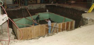

This is after the first forms are removed.

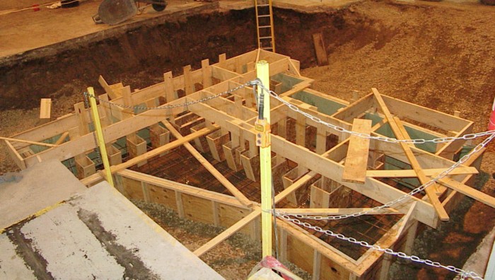

Lower floor formed and ready to pour.

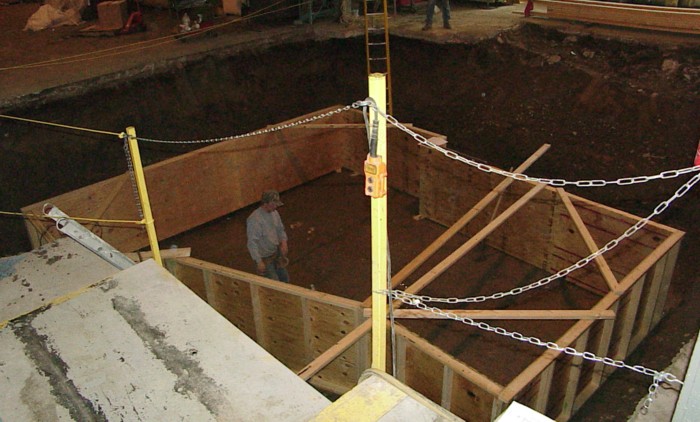

Walls formed and partially braced.
