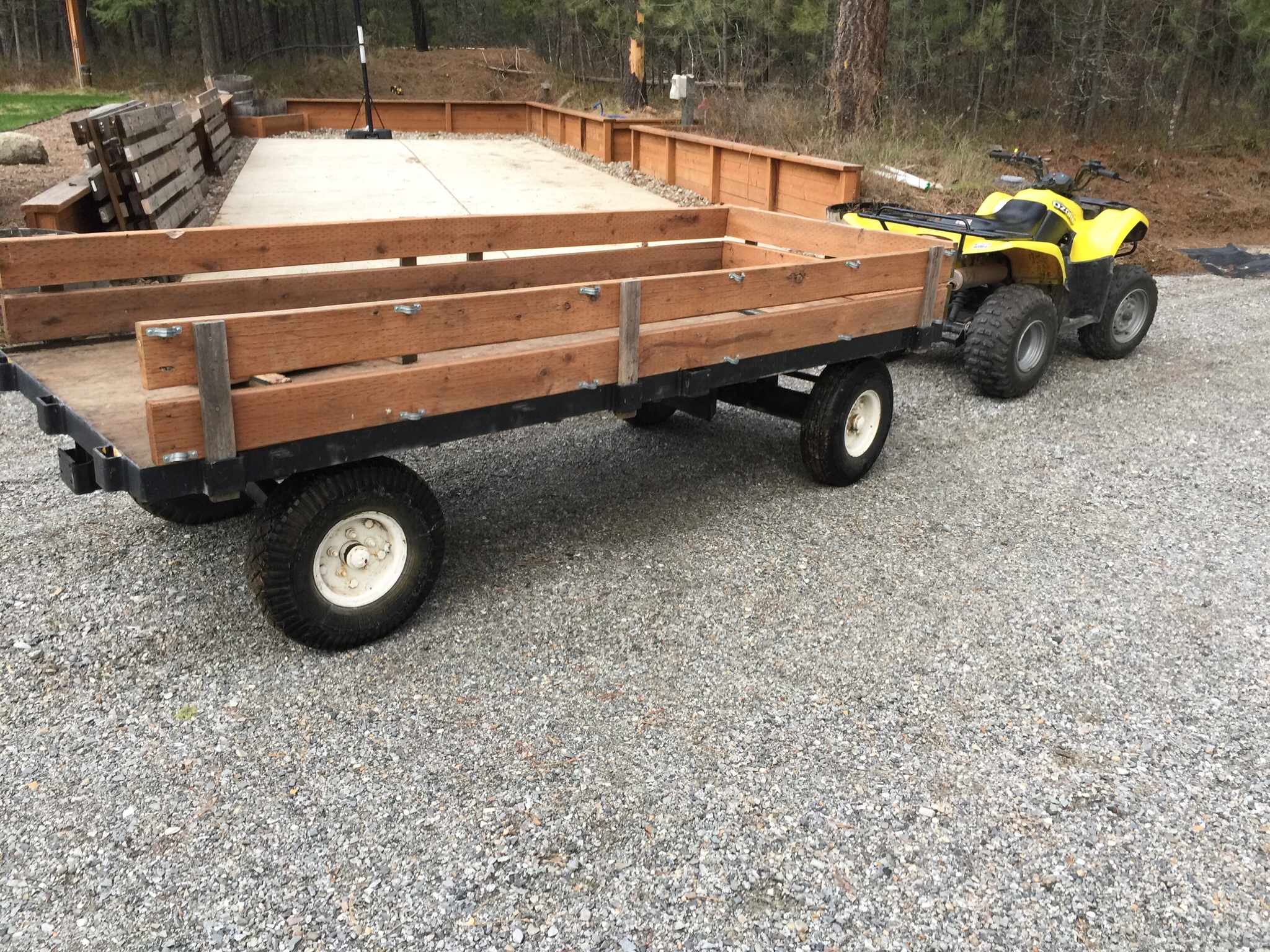

Found this on CL and brought it home today. It was obvious that this wasn't home made and I barely got information from a placard on it. Built for the military in 1953, measures 10' x 4', gross capacity, 6,000 pounds!!! Makes me wonder what it's used for in the past?
Anyway, gonna find cheap 10-ply tires and make a few modification to serve as a logging trailer. I've always wanted something like this so I can just make fewer trips with the logs to the bucking / splitting station. I could load 'em up and haul a lot in one trip instead of what I can carry in my grapple with multiple trip.
Anyone have one of these and what did you use it for? I thought about making a dump trailer as well?

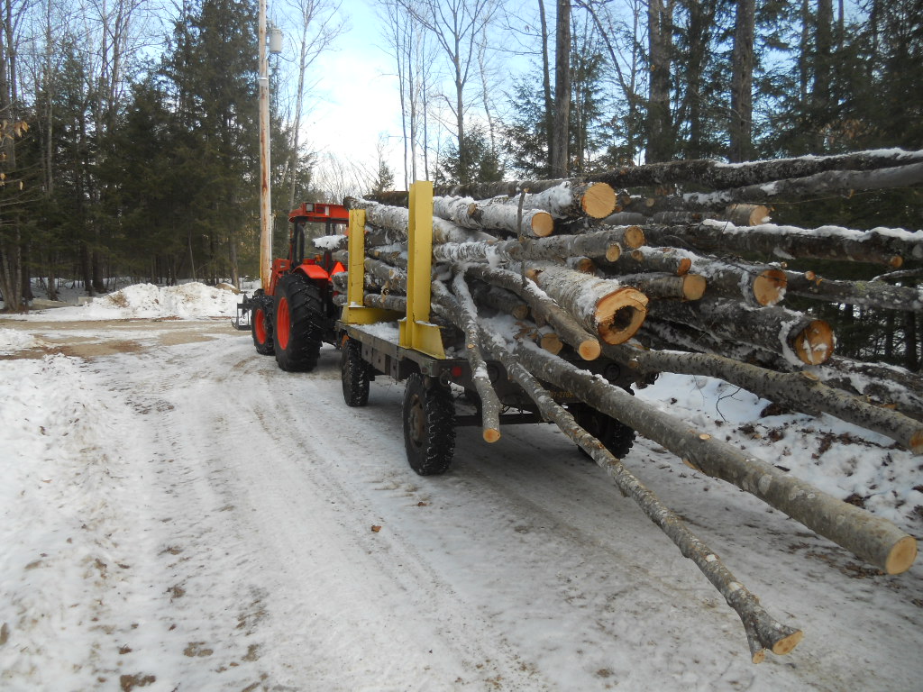

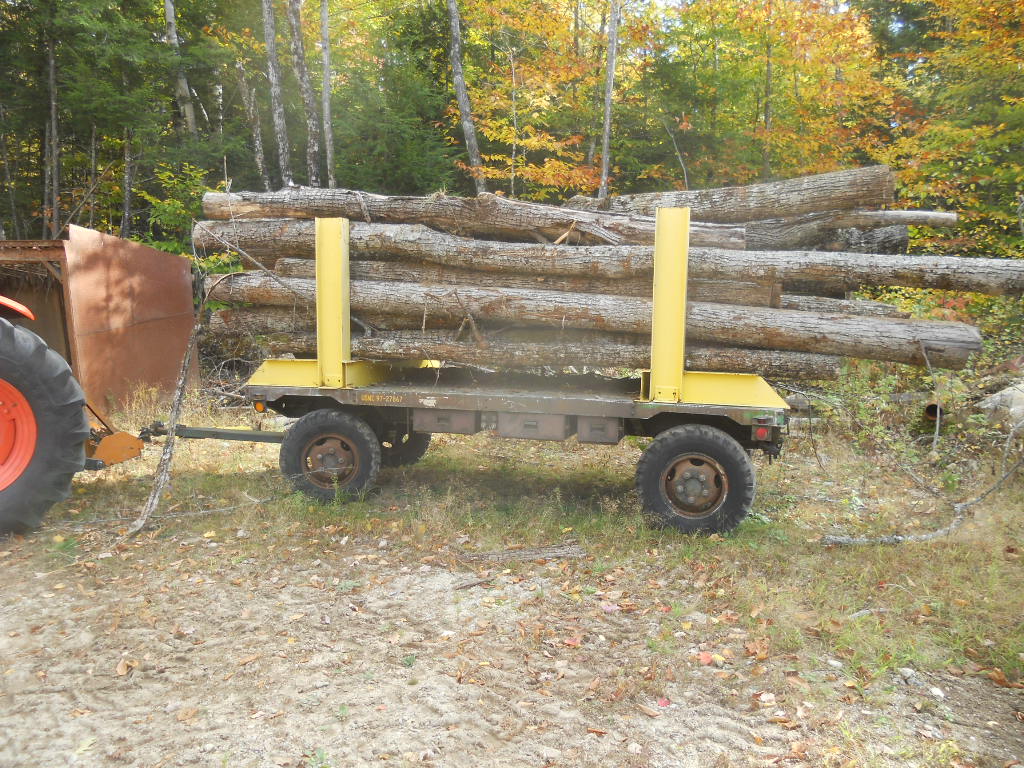

I've got a little bigger version. Ex military that I saw for sale ($300) on the roadside a long time ago. I built the "bunks" and it's great for logs.

Nice! Looks like an old F2 trailer. We used those in the Air Force to haul bomb racks and missile launchers out to the jets for installation. Very stout little trailers. Just service the wheel bearings every couple of years and it will last forever.

3LFarms, glad to know at least a little history on them! When I get the tires replaced, I'll try to do the bearings. Have you done them?

As I recall, they are pretty standard wheel bearings and a seal. The max towing speed was limited to 15 MPH, so they lasted forever. Just repack every couple of years.

Yup, the placard did say 15mph top speed! Thanks, I'll try to repack when the new tires are put on. Look forward to putting it to work!

I just ordered replacement tires and look forward to getting it back in shape. I greased the broad pivot point Bet it has been years since it was greased because it pushed water out! Now it turns very easily & quietly.
