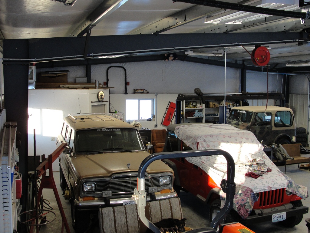

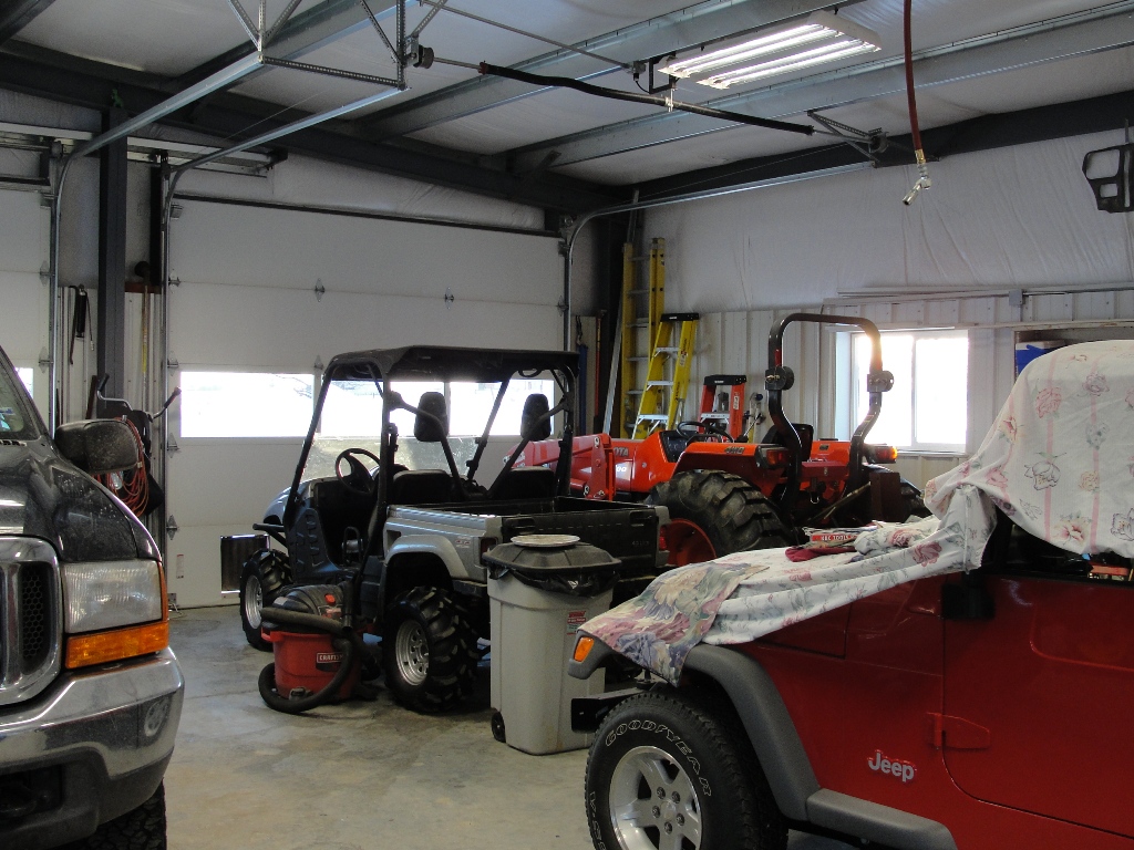

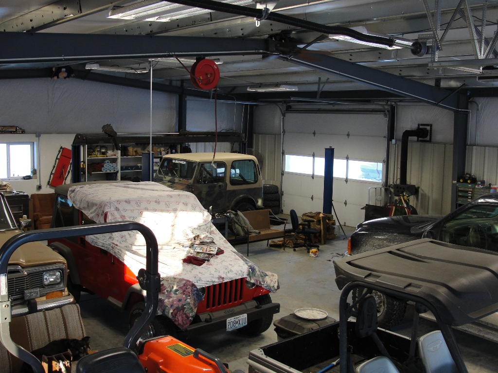

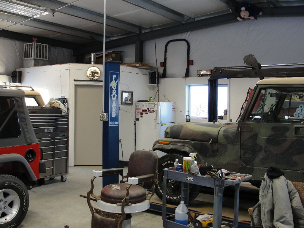

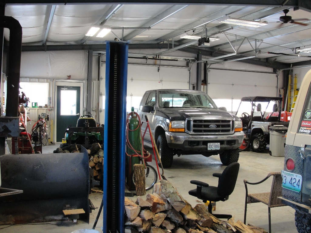

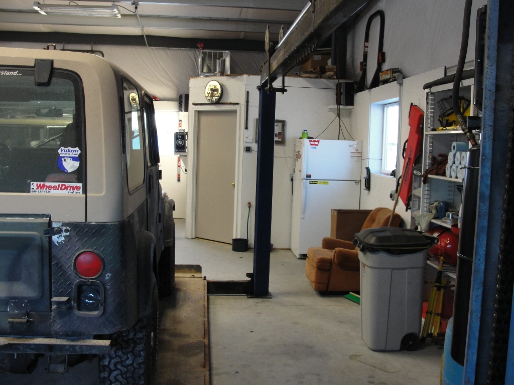

We lost our shop in a fire 2 1/2 years ago and this is what we built back. When my Sons and I were standing on the spot of the old shop after we'd cleared it off they said "Dad you should build the shop of your dreams to replace the old one". So I did
So here's some pics of what my wife affectionately named the "Man Cave". I am so truly blessed. When we were standing in the yard watching our old shop burn down my wife hugged me and said "Honey, why couldn't it have been the house". I am so blessed.
