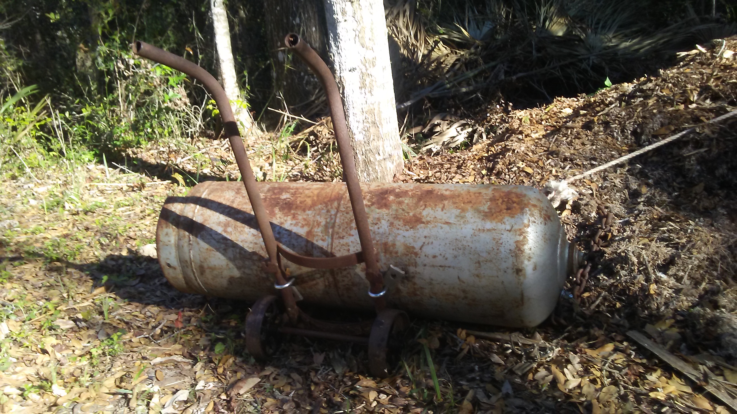

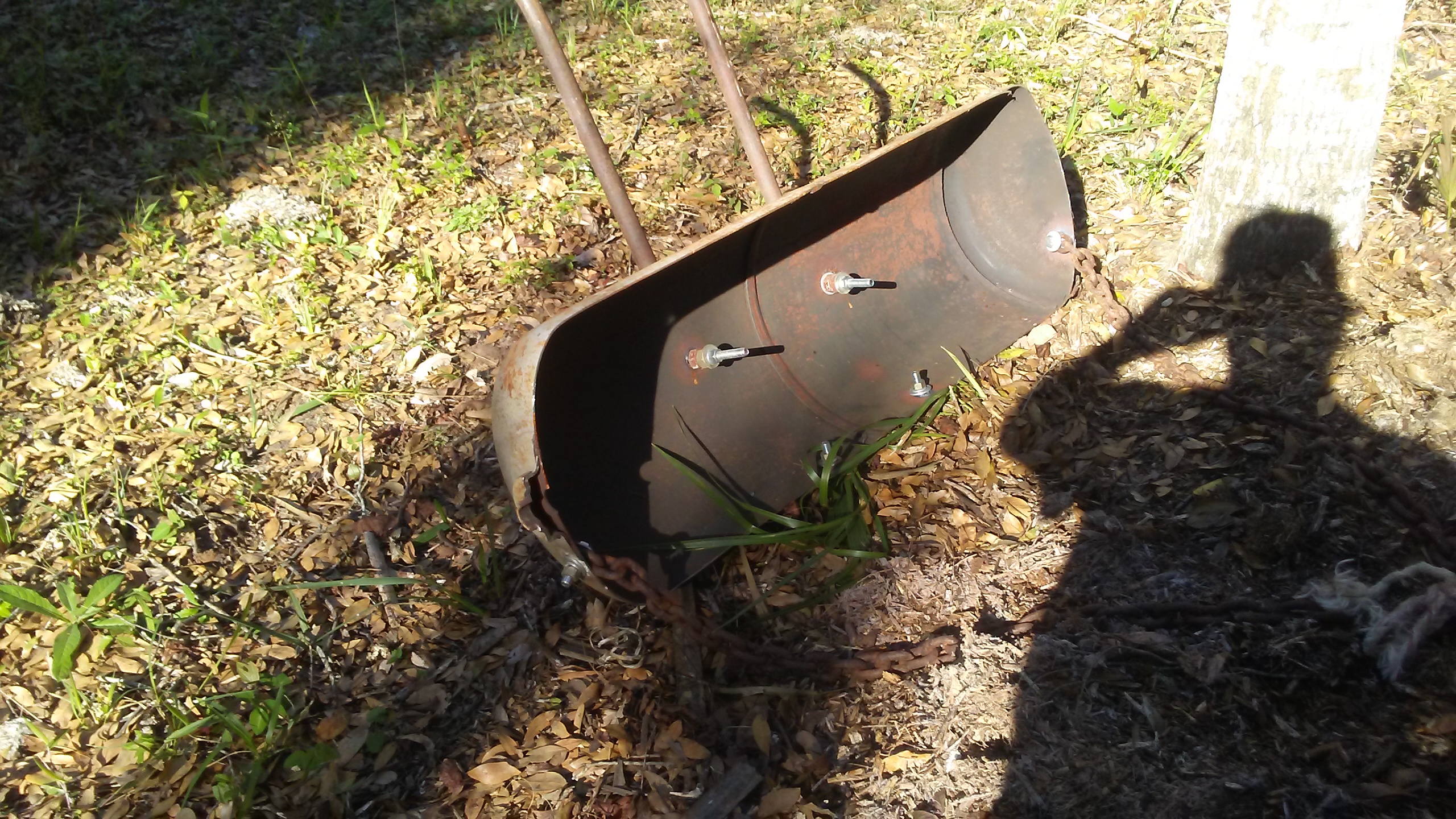

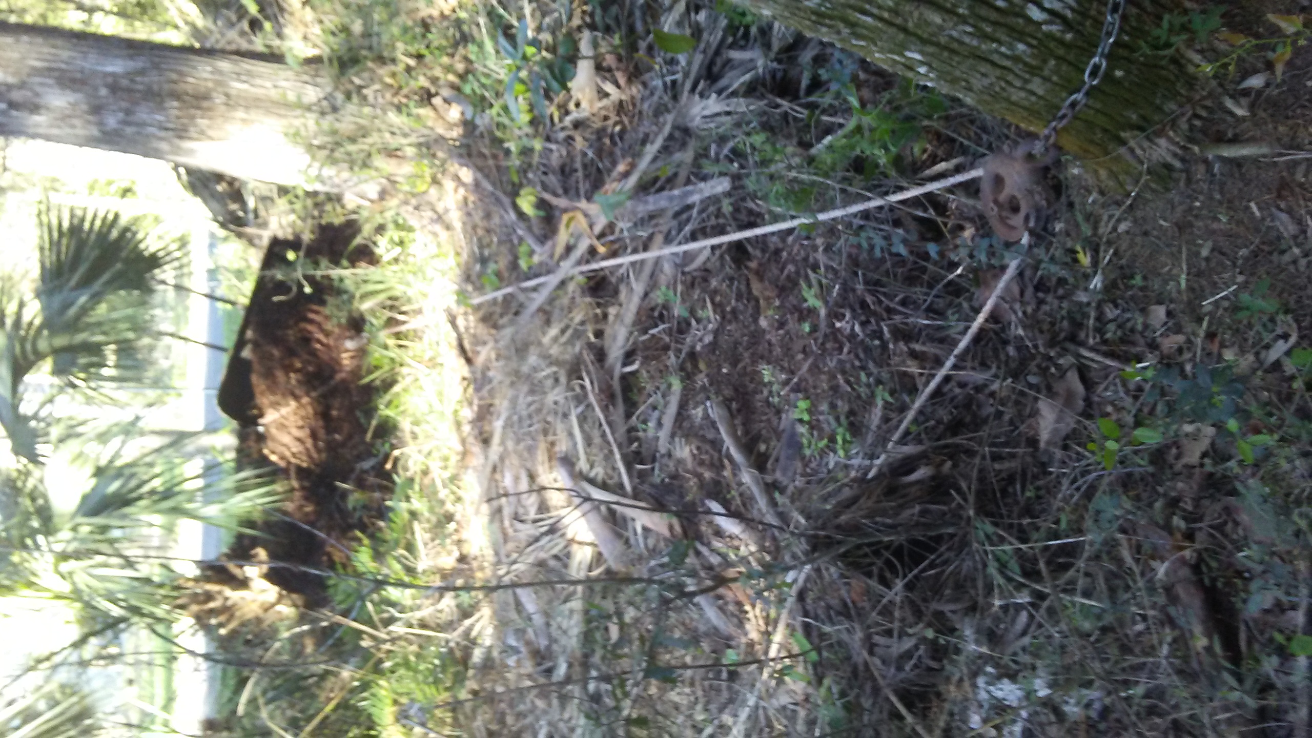

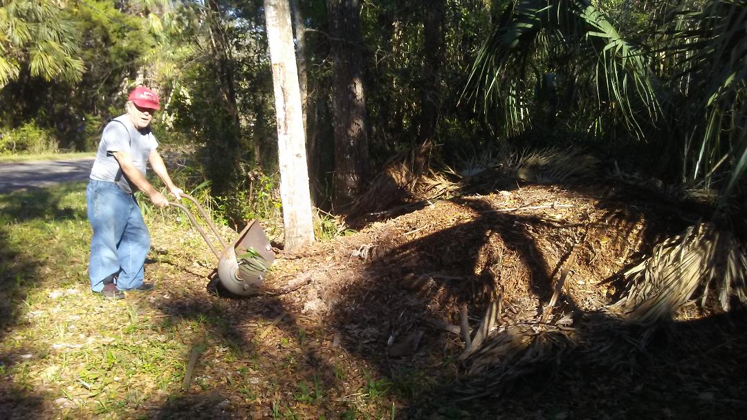

I'm sure that many of the younger and non farm folks won't know what a slip scraper is, but it is the way dirt was moved with horses before tractors, scrapers, loaders, dozers etc. were invented. You can google it and see more of the real thing. I have a real one at home in NY that I used behind a tractor years ago. We also made one from a 55 gal drum cut in half lengthwise to dig a 33 x 16 foot swimming pool (in pure sand) at our first house in Fla in 1972.
I have a couple piles of shredded trees/compost that I wanted to spread and that's a lot of shoveling and wheel-barrowing so thought, without a tractor or anything here in Fla., what could I use to spread it. I had an old 100 lb propane tank out back and an old hand truck meant to move 30 gal drums around the garage. No monetary investment involved so what do I have to lose. You can see the results in the photos. It works ok but would be better with a bridle and longer flat bottom to carry more like the real ones. One photo shows the scraper is in the background and a rope and pulley attached to a palm tree, to move the compost into a blind corner. Hooked the wife up to the other end of the rope and hollered giddy-up but she couldn't move it so I had to let her use the car.
So, if you've got some loose material to move go for it. If you want to dig a pond, get ready to sweat. scprme.jpegscrpr3.jpgscrpr4.jpgscrpr5.jpgscrpr6.jpeg

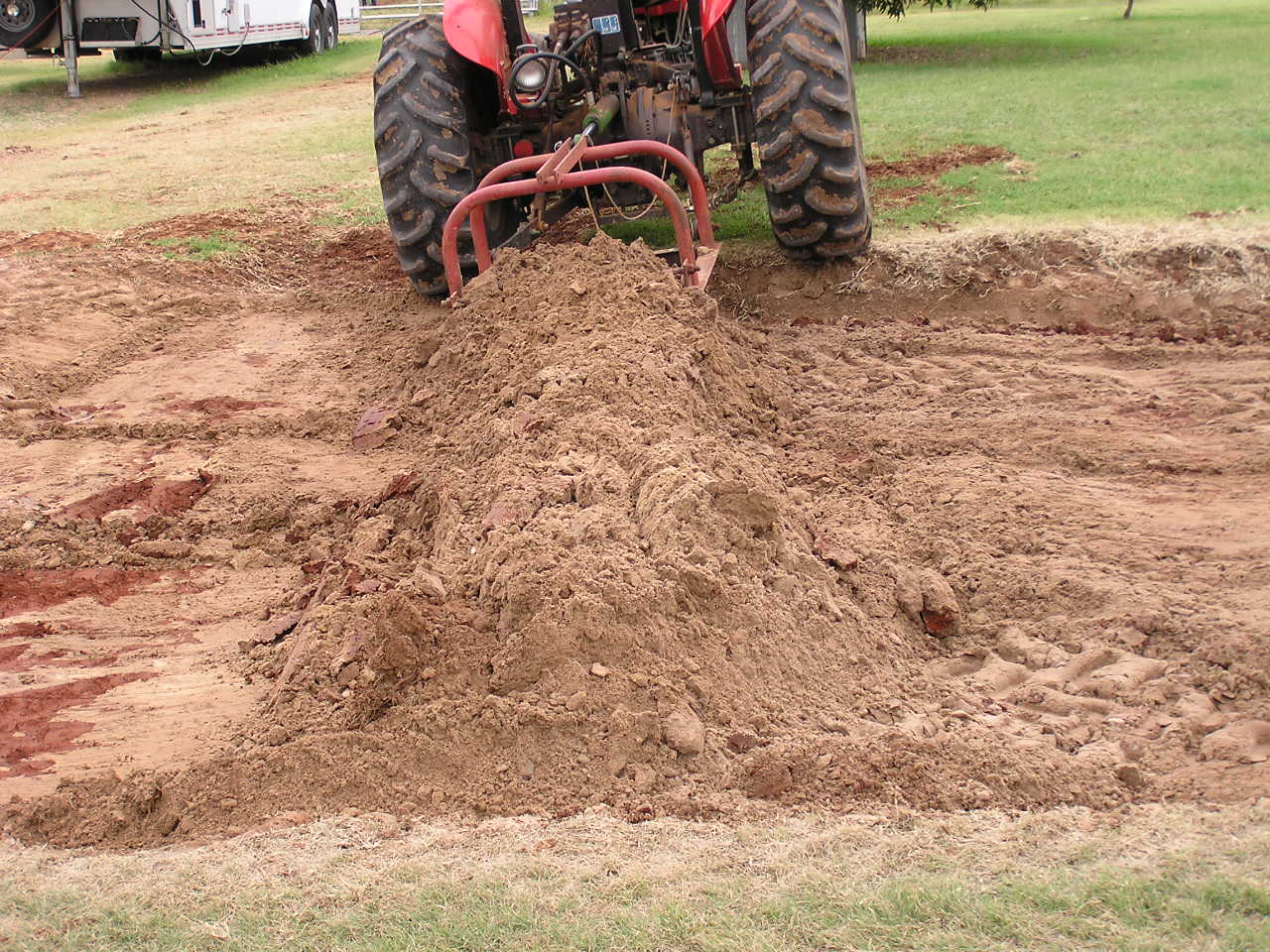

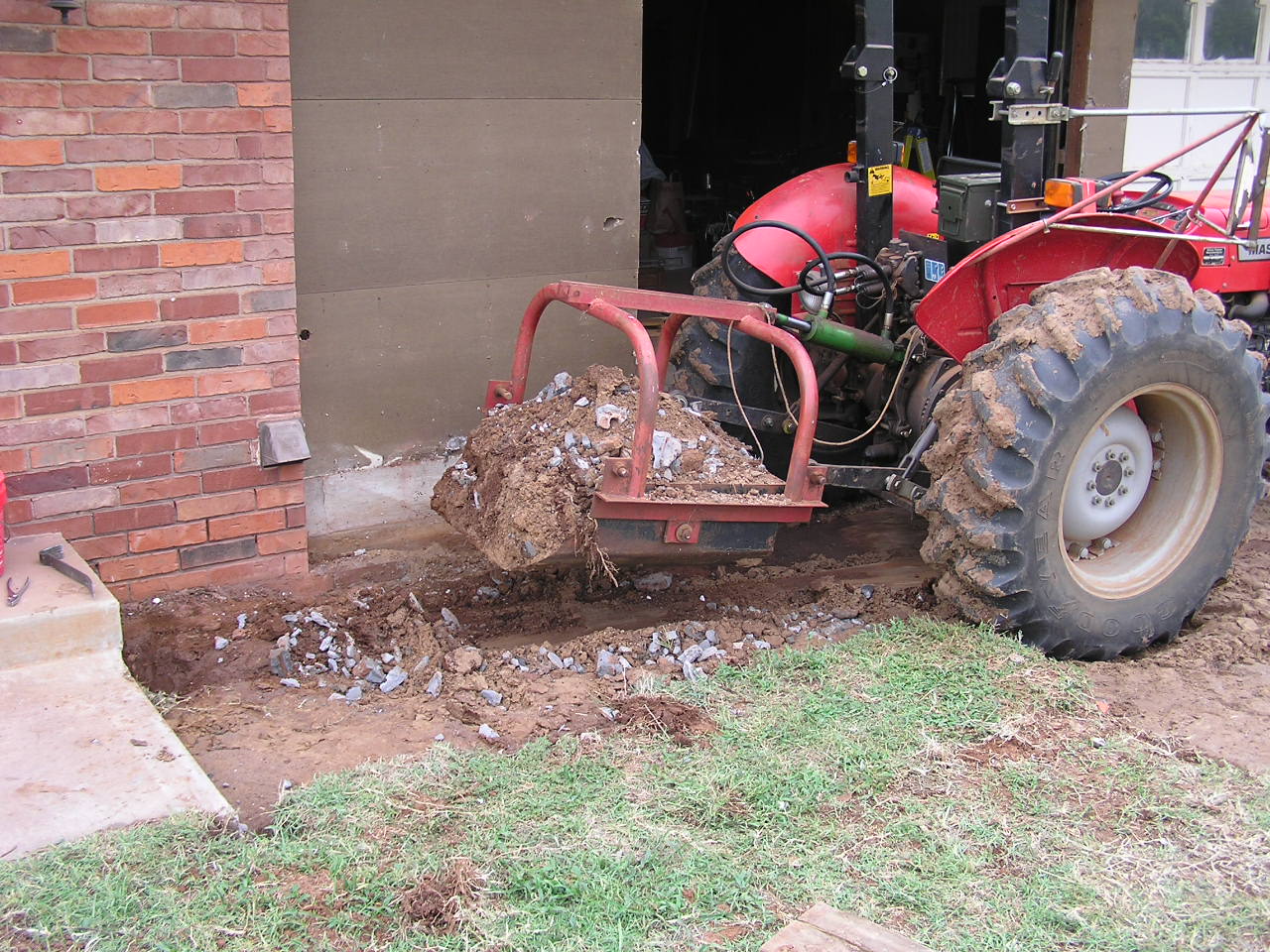

Here is a TPH mounted unit in action - this is a Fargo brand I picked up at auction - not so much for the scoop as for the TPH assembly that I thought might come in handy if I needed to build a TPH attachment of some sort. Fargo 1.JPGFargo 2.JPG
Much easier on a tractor than by hand.

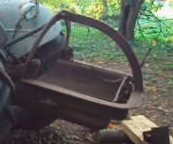

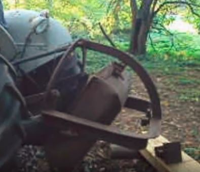

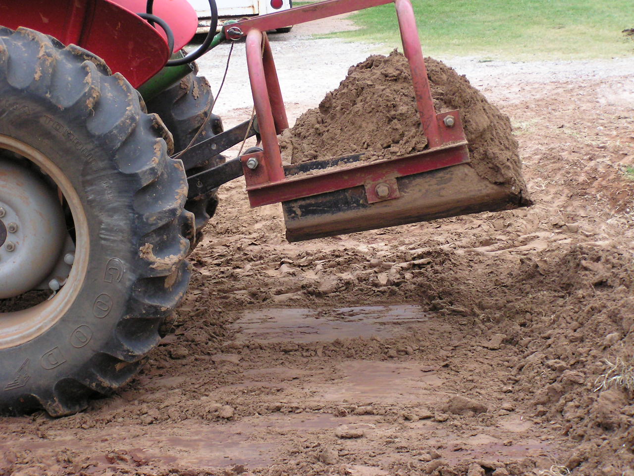

Yep, then they were adapted to the tractor 3 point.
I had one that was reversible and 36" wide:
Moved a lot of dirt with it back in the good old days, since the tractor didn't have a loader.

A 30" reversible pan was the first tractor implement I bought. Still have it and when I am moving dirt any distance, I will put it on and take a FEL bucket and a rear scoop full each trip. A full scoop makes a decent counter weight for the FEL and increases what I can move each trip by about 50%. I have actually never pulled it, I always set it up to push it like your pics have it.
/ New-fangled Old-timey slip scraper #12
I've noticed while watching videos of the rear scoops is that the operator has to yank fairly hard on the rope to release the trip lever and dump the load. I suppose the difficulty is determined somewhat by the balance of the load. I later noticed that some (or most) of the operators will set the load on the ground before tripping the release and then raise the 3PH to dump either stationary or on the go. Makes sense I guess.
View attachment 542404 View attachment 542405 View attachment 542406
I've seen a lot of these scrapers over the years but I'm thinking this may be the first picture of one with a load. I'll bet the cylinder top link is quite useful for setting the cutting pitch while loading as well as dump assist?
Yep, very useful. Made the dirt scoop work better, also the box blade, the brush hog and everything else on the 3 point.
The hydraulic top link came with a 3 point forklift that I bought a several years after using everything with a standard toplink, so I really noticed the difference.
