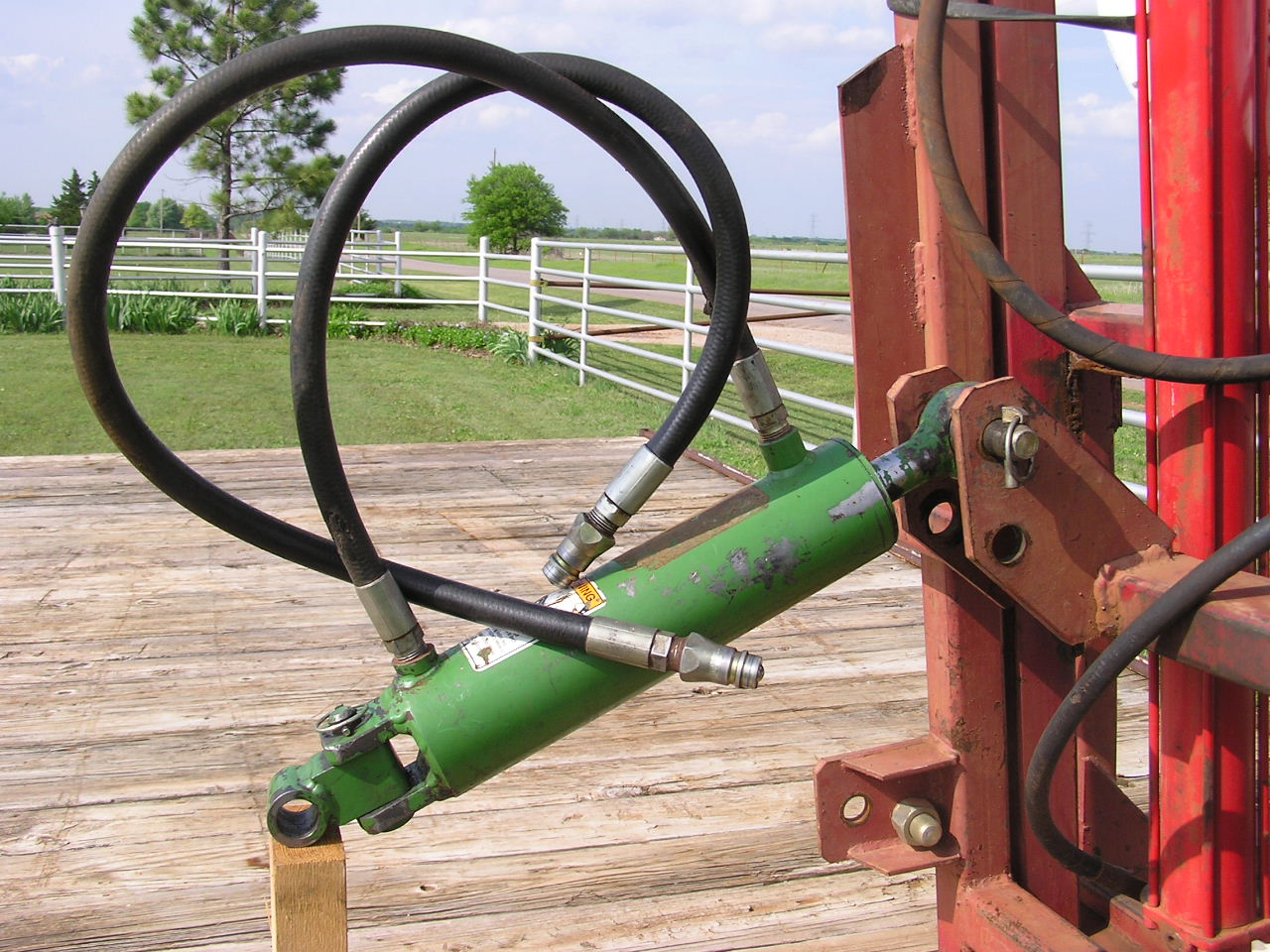

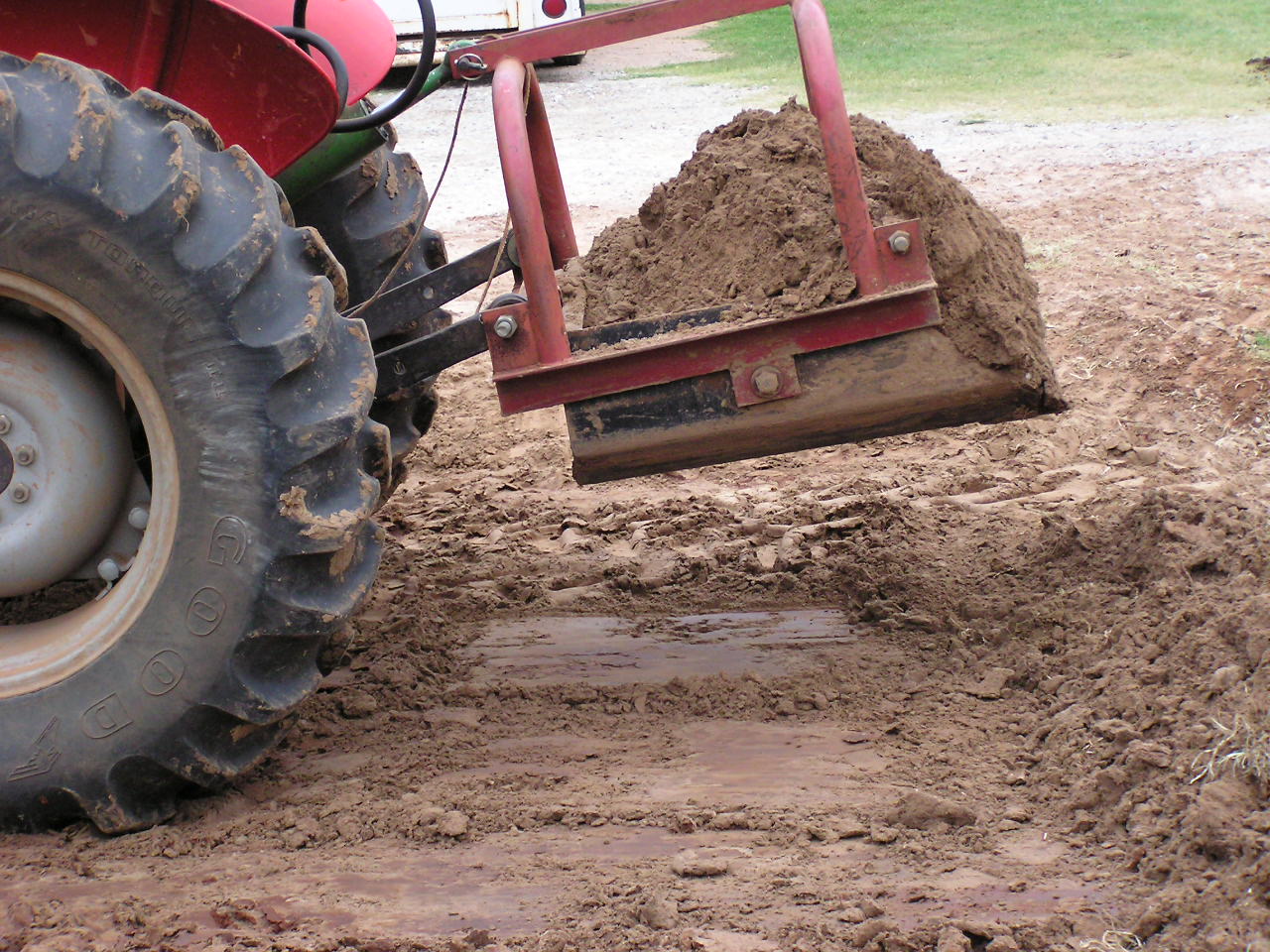

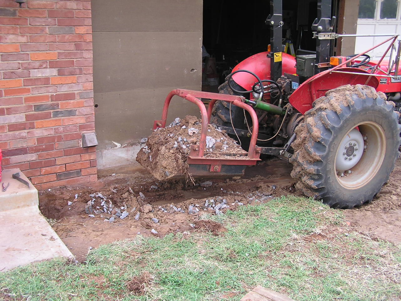

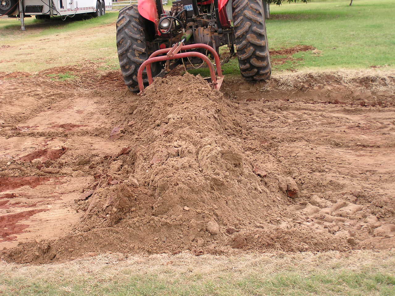

Yep, then they were adapted to the tractor 3 point.
I had one that was reversible and 36" wide:
View attachment 542404 View attachment 542405 View attachment 542406
Moved a lot of dirt with it back in the good old days, since the tractor didn't have a loader.
I've seen a lot of these scrapers over the years but I'm thinking this may be the first picture of one with a load. I'll bet the cylinder top link is quite useful for setting the cutting pitch while loading as well as dump assist?
Yep, very useful. Made the dirt scoop work better, also the box blade, the brush hog and everything else on the 3 point.
The hydraulic top link came with a 3 point forklift that I bought a several years after using everything with a standard toplink, so I really noticed the difference.
