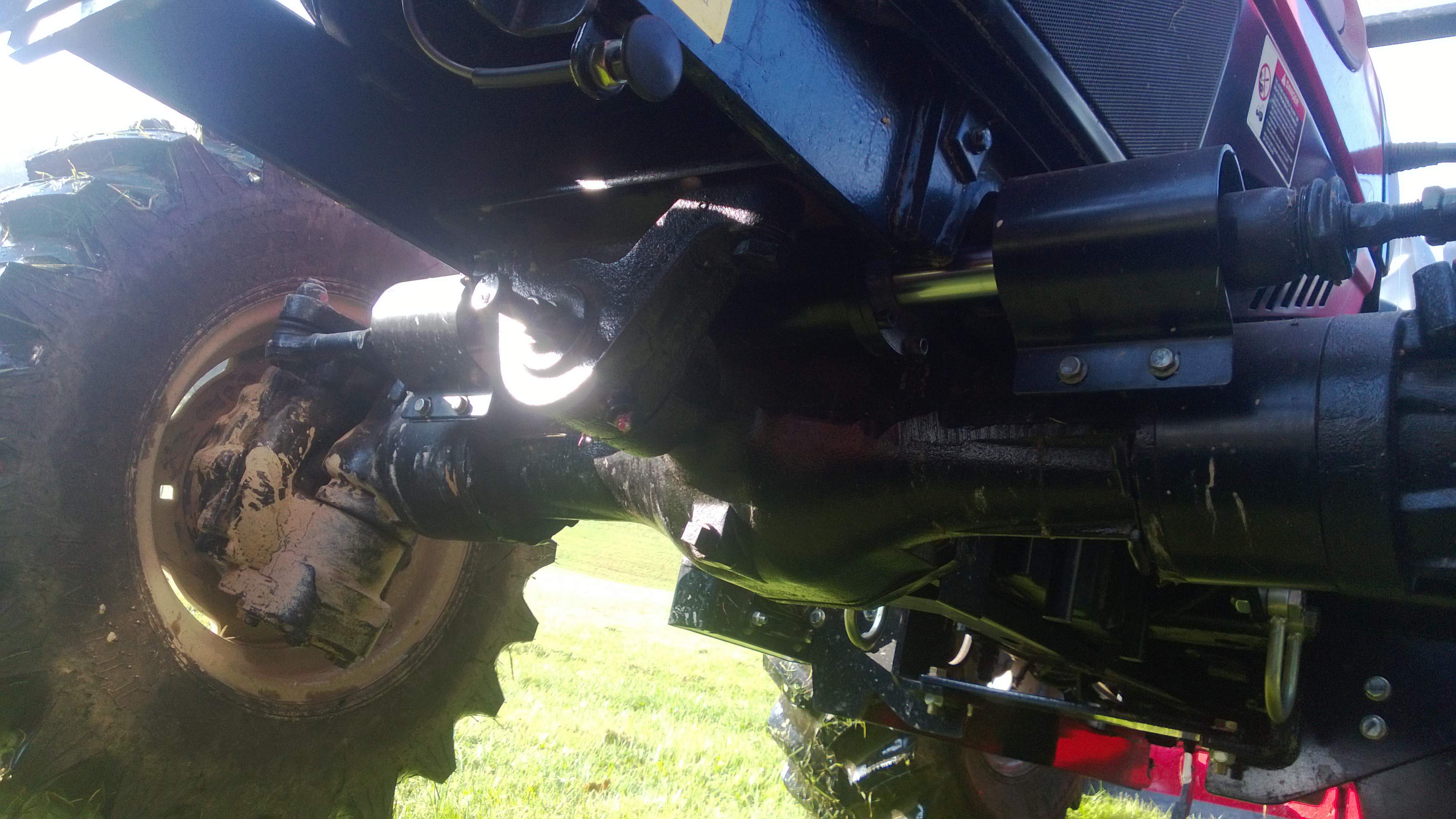

I'm new to the world of owning a tractor in the sense I've never had to maintain one before. I have done certain things other tractor owners have told me to do on their machines exactly as they've explained and never had reason to question much of anything. I've had grease fittings that were hard to take grease, and even some that would ooze a bit back out the zerk fitting due to the pressures they would hold. I've also had failed fittings, and I know the difference. My front fitting on my axle pivot has been one of these types, hard to take grease from pressures in the assembly...
Today when greasing it, I got the bright idea to lift the lift the front axle off the ground with the FEL. Honestly I was feeling tired and just wanted to make it easier to reach, but as I was raising it up I thought to myself "maybe that front fitting will take grease easier with the weight off :thumbsup:" (yes I gave myself a thumbsup in my thoughts :D). After getting everything ready, I was about to get down and do the greasing and laid my hand on the front wheel and the axle tilted at the pivot reminding me it wasn't something to lean on when it's not on the ground :laughing: I played with it for a moment pivoting the axle back and forth noting how smooth and fluid it moved, no noise or play or anything in the pivot, exactly how a new machine should be... So I get on to the task and it didn't take grease much easier than normal, if at all. A little oozed back out the fitting still too, but nowhere near as much as I pumped in, so I call that "task complete". Here's where things got "weird" enough I felt it worth posting thread to see if I can get a couple answers questioned or questions answered or whatever... Once it was greased, I could no longer pivot the axle by hand... I could jump on either wheel and it wouldn't budge at all... Before greasing I could literally pivot it both ways with a single pinky finger.
Ok, once I couldn't pivot it by hand, I let the tractor back down and traversed some small ditches to articulate the axle pivot fully and it operated flawlessly. I lifted it back up, I could pivot it by hand again, everything smooth and friction-free.
What I would like to learn is:
1: Why is the front pivot zerk fitting under so much more pressure than the rear?
2: Should that be the case and should I be concerned about it?
3: Why would the pressure of the grease I pumped in prevent me from pivoting the axle by hand until flexing it across some ditches when no additional grease made an apparent exit from the joint or zerk?
If this is something better suited for the Mahindra forums so be it, I figured the axle pivot could be similar enough to some others that the questions might be valid and get better responses here.
Thank you all for your time in reading, and many thanks to anyone with any helpful input.

G'day is your grease fitting on the end of the pivot? If so then as you pump grease in you are forcing the axle back and it tightens up against the thrust washer, thus making it hard to move if you had let it sit for 10 min or so then you would prob find it easy to move again as the grease would have worked it's way along the pin and taken the pressure off the thrust. Nothing unusual just means your pin and bush must be in good shape.

There are two. They are located on the bottom of the pivot joint, one at the front of the joint and one at the rear of the joint. The one at the front of the joint is located at about 8 o'clock and the one at the rear is at about 4 o'clock (when seated on the tractor). The rear one (pointed to the right side of the tractor) takes grease much easier than the front fitting (although I did it first). I'm sure everything would still be in good shape beyond anything that might have been assembled improperly, the machine is just over 50 hours and is only a few months old. I'll try to add some pictures in the next couple days. Thanks for the reply!

This is the answer and it happens on lots of grease applications. Close tolerances and the grease is being forced in under tons of pump pressure. Use it for 5 seconds and it's back to normal.

Here's the pics of the pivot joint and the location of the fittings as promised.
Front
Rear
(the fittings have a bit of red/pink/purple colored grease on them)
I also spoke with the service guy at the dealer, his explanation was the same as banjodunn and sixdogs explained. This is apparently a common thing, I just never experienced it on anything I've worked with cause I just put grease in it and move on.
