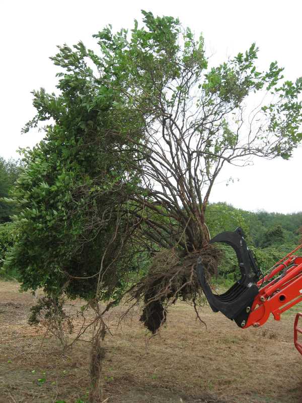

The main use I have for a loader is tearing out brush and popping out tree stumps or trees. So long as I have a heavy implement on the rear of the tractor, it is loader break out and lift capacity (and roll back force) that determine how long it takes me to get a stump or bush out of the ground.
The KL1450 has lift to full height at pivot pins of 1350lbs and breakout force of 2100lbs per Kioti's website.
The KL351 (DK35se) numbers are 1400 and 2600 plus a rollback force 500mm ahead of the pivot pins of 2750lbs.
The KL401 (DK40se and DK45se) numbers are 2700 and 3700 plus rollback of 4600lbs.
The KL401 is therefore has about 70-90% more lift, breakout and rollback force than the KL351. That's a pretty healthy difference considering the cost of the loaders (and tractors) is not that much different (I forget exactly how much).
I can still trip the relief valve on my KL401 while digging at a stump if I have the BH for counterweight. That means that I really am able to put either about 2700lbs in lift down low or even better 4600lbs of curl force on the stump. That seems to me quite an advantage over the KL351.
I would certainly agree that for moving dirt it would not make much difference as either would do the job but for digging with a grapple it is nice to be able to pop out a tree in a single manuver rather than work at it from different angles etc.
I don't move or stack bales of hay but that is also a task that can easily max out your loader lift, especially at full height.
