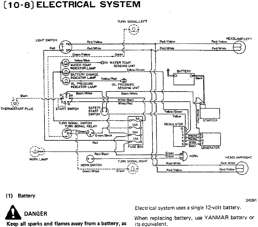

Thanks guys. It looks like I do have the TS system. I assume you fill the little pot with diesel? Do I fill it everytime, just enough for one start, or fill it up and it just takes a little each time?
/ New discovery on cold start #26
Check it each time you re-fuel the tractor.
I use a plastic turkey baster (giant eyedropper) to fill it since it's impossible to be that precise from a 5 gallon jug.
Some people replace the original reservoir with the self-fueling model used on later Yanmars. The injector return hose goes through the TS reservoir on that version.
The TS element burns out eventually so test it once in a while. Turning the key to TS position should dim the dash lights slightly when it is working properly.

Well I filled the little pot, followed all the instructions, and it fired right up at minus 8C. Don't know if it was working or not, but it started well considering the temperature.
