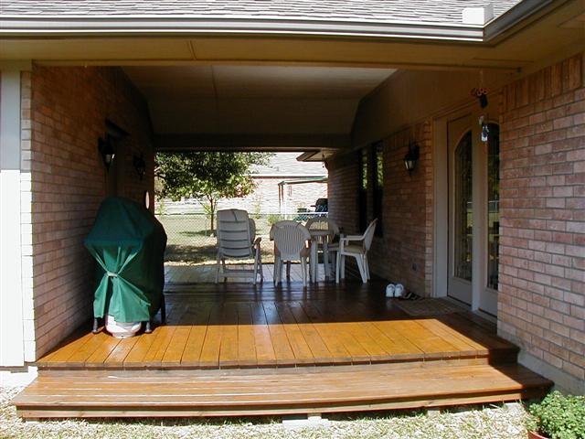

Here's an old picture of the breezeway from the living part of the house on the right to the shop on the left, and if that deck isn't on the same level, it won't be a quarter inch lower thant the indoor floors.
/ New Deck, Question #8
That old picture was made before we moved in, and now I've found a little better picture of the breezeway.
