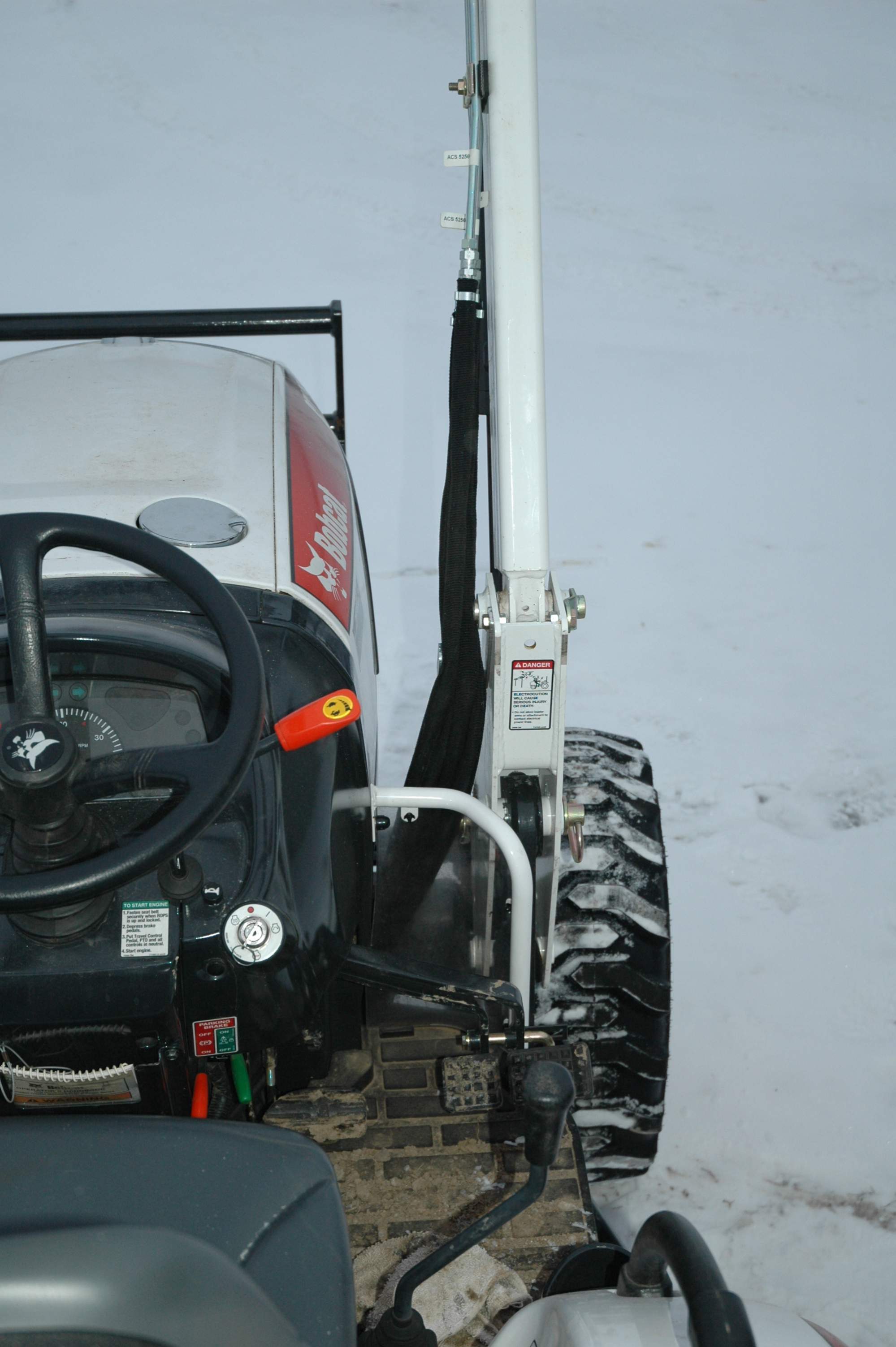

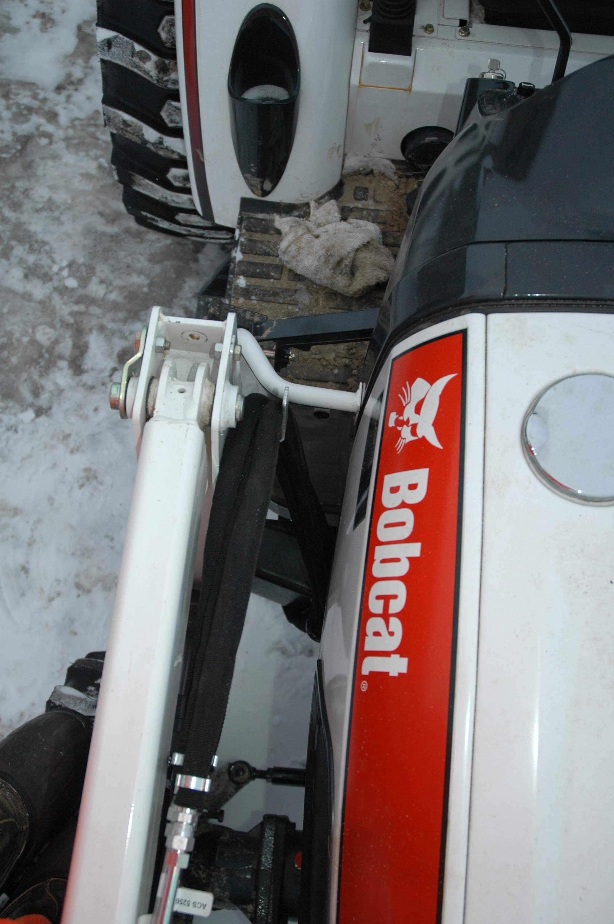

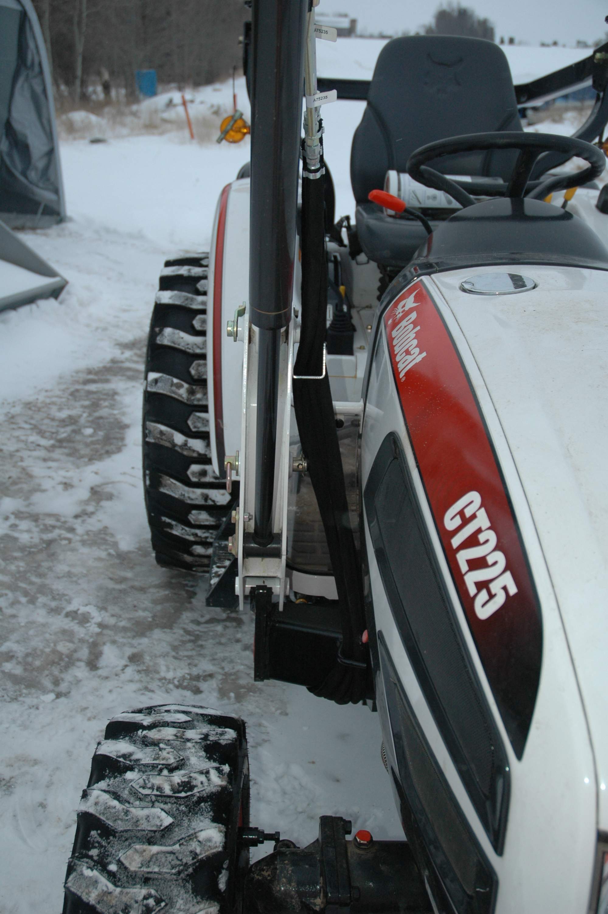

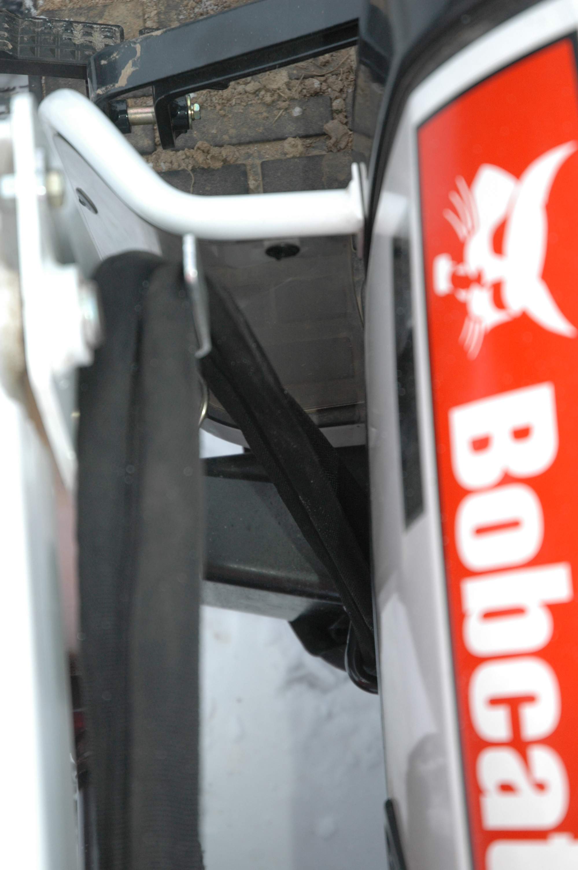

Took some pictures of my CT225 (basically a 230 with a smaller engine) to show how my hoses are restrained. In addition to the J-hook welded at the bottom near the valve, there is a J-hook bolted to the loader tower. The hoses are just long enough to route this way without being overstressed or being too loose where they pop out of the J-hooks.
A few different shots, so at least one of these angles should make sense :)

   / New CT230 Delivered with Pics #12
Those HYD lines don't look right. I don't recall every seeing a problem like that with my CT230. Tomorrow when its light out I will go look at mine and snap a picture.
   / New CT230 Delivered with Pics #13
I was just looking at some general photos of my machine. Confirmed the same as Rus_Geek. They are tidier and pose no problems with the front wheel.

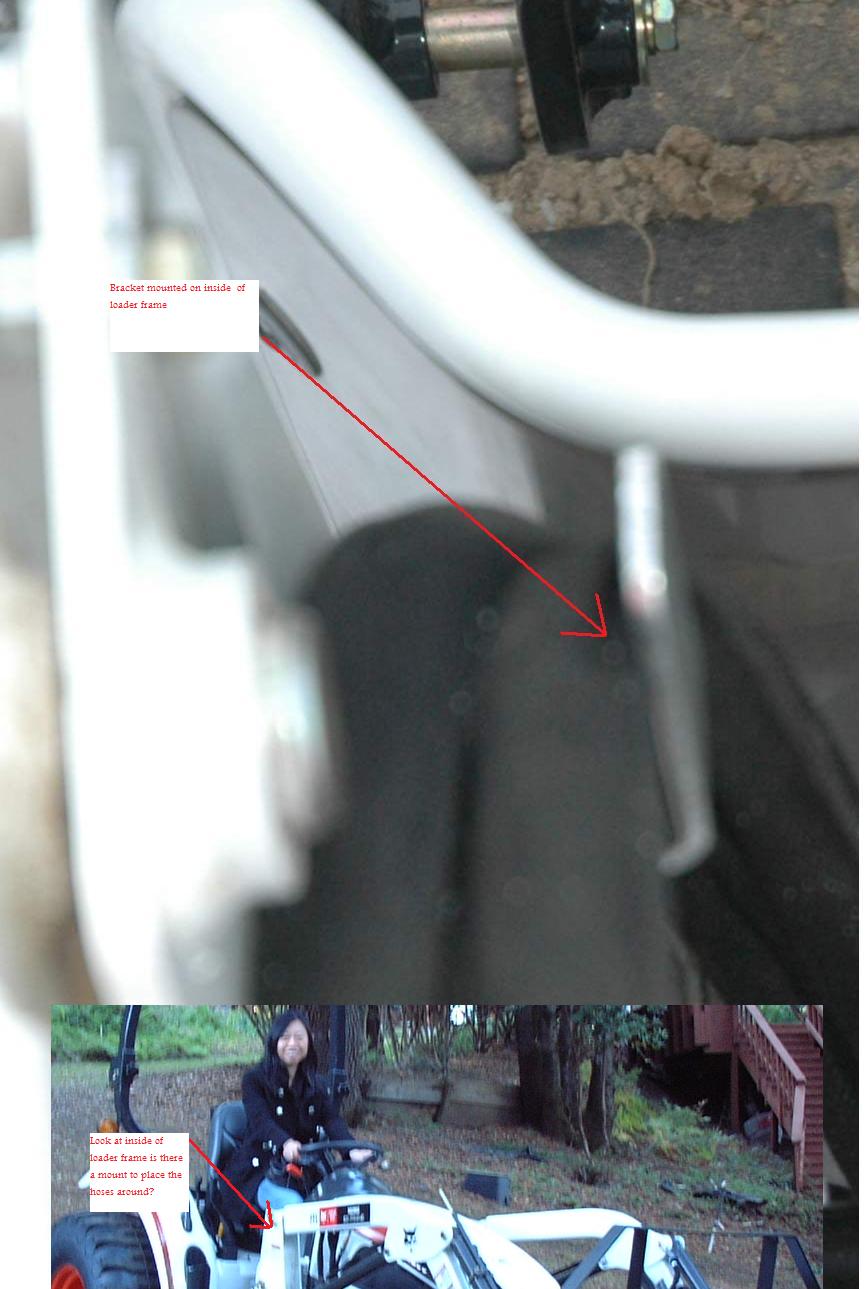

   / New CT230 Delivered with Pics #14
Take a look does this match yours it does not look like they routed the hoses around it from the picture with your wife on it and thanks to rus_geek for your pictures. I think what happened is it is a tight fit and were having trouble getting the lines hooked up when routed correctly so they just did it like.

If you see my thread in the safety section, I used it to pull my truck out of a snowdrift after it rolled. I set the bucket tip down into a cornfield, lowered the back blade, and tried a single line pull of the 8000lb winch and stalled the winch motor, then I snatched blocked it back around to the bucket, and pulled it out, no problems on the loader frame, but surely that has to do with having the bucket planted down. I raised the front wheels off the ground to make sure I had the max weight on the bucket. I would feel fine pulling the tractor up a hill straight with the loader frame and winch on the bucket. YRMV.
Also, I check my loader hoses, they run over the top of the loader mount instead of under by the jhook as showed in your and rusgeek's photos.

#19
Thanks Rus_Geek and Sabretooth...
My machine is MISSING :( the J hook pictured here on the loader. That would explain the issues with the hydraulic lines.
