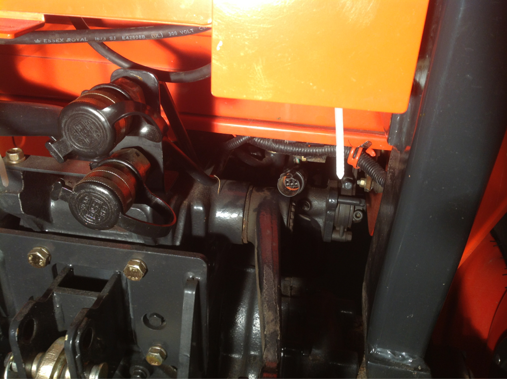

I have a ck35 hst question. I'm about to buy one from a dealership and I wanted 2 sets of remotes on the back. He said you can't put 2 sets of remotes on the back of a ck35, one is all you can get. Does that sound right?
/ New CK 35 HST #6
Literature all says you can have a 2nd valve on the Ck35hst. I believe you can only get one on the CK20S.
I would only buy one, and put the electric/hydraulic valves like what Brian sells on the back so i could have up to 4 valves on the back all controlled by the one OEM valve control . Take a look here. This is a stackable expandable solution for up to 4 valves.

James, I don't understand how you control 4 values with one controller. How do you tell it which hose to send the fluid through.
/ New CK 35 HST #8
You have an electrical switch to control the electrical solenoid you select with the switch, it will re-direct the fluid out of the correct valve port. The control of the flow rate is done by your original OEM valve. This valve bank is hooked up to your original valve in series.

You can absolutely put 2 valves on the CK35. The manual says so, there are slots on the operator station for 2, and room and mounts on the back for 2. Your dealer is wrong.

Kurt, I have an A and B remote on my ck35hst. I think the dealer is calling this one set. There is an A-N-B lever right side of seat. I love the idea of those stackable valve blocks. Looks like a simple install, not much hydro plumbing and only an electrical switch to run.

Agreed, I have 2 remotes on my CK35. I wanted 3 sets but the dealer said, can't do 3 but 2 is no problem. 1 runs the snowblower rotation, #2 runs the front blade angle.

Correct, anyone could install it, if they can wire up an electrical switch. The rest is just some screws to mount the valve stack, and plug in the input hoses to your existing OEM remote. With no solenoids activated the flow goes right thru the stack out to the set of quick couplers on the right hand side of the stack. The input from the OEM remote quick couplers goes in on the left hand side, and when any solenoid is activated electrically, the face of that section's quick couplers has the flow path. You can have one valve for a total of 2 remotes, or 2 valves for a total of 3 remotes or 3 valves for a total of 4 remote outputs. You will need the proper stacking bolts for either a 2 or 3 valve stack.. If I ever get any money, I intend to get at least 2 valves for a total of 3 remotes.
