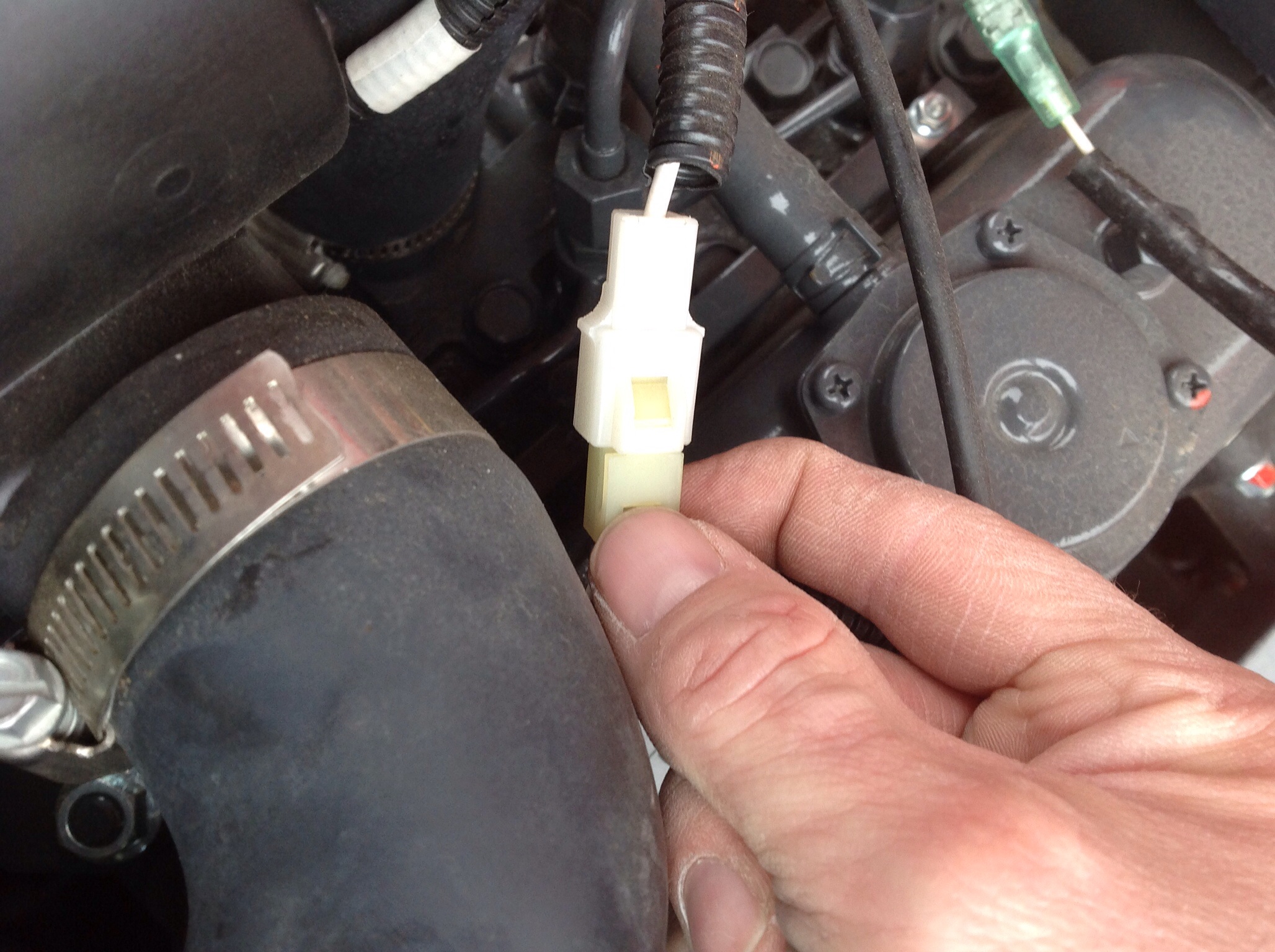

This BX2660 came home new a month ago. Last week a seal failed at 18 hours and all the hydraulic fluid ended up in my driveway - I spent 4 hours last Monday at the dealer waiting to get that fixed.
Yesterday, at 29 hours, I turned the ignition switch off - and the tractor kept running. The Temp and Fuel Gage's drop down and the Tach goes off as if it shut off, but the engine keeps running. The safety kills don't work (they did before this happened). If I engage the PTO, and step out of the seat, the MMM engages and continues to run. The the HST forward and reverse will engage if I'm out of the seat.
I shut it down by putting the HST in high, setting the parking brake, and stalling it. I've started it twice since but the the same situation recurs.
So first thing Monday it is back onto the trailer and 50 miles back to the dealer - and another day lost from work.
I'm beginning to wonder if this thing came off the assembly line on a Friday afternoon.

next time you want to shut it off and key doesnt work -- open the hood and look for solenoid on top of engine and push on the plunger. This is the shutoff for fuel which is how the tractor is shut off when fuse is not blown. After shutoff - you should be able to find your blown fuse behind the screen under the dash on right side.

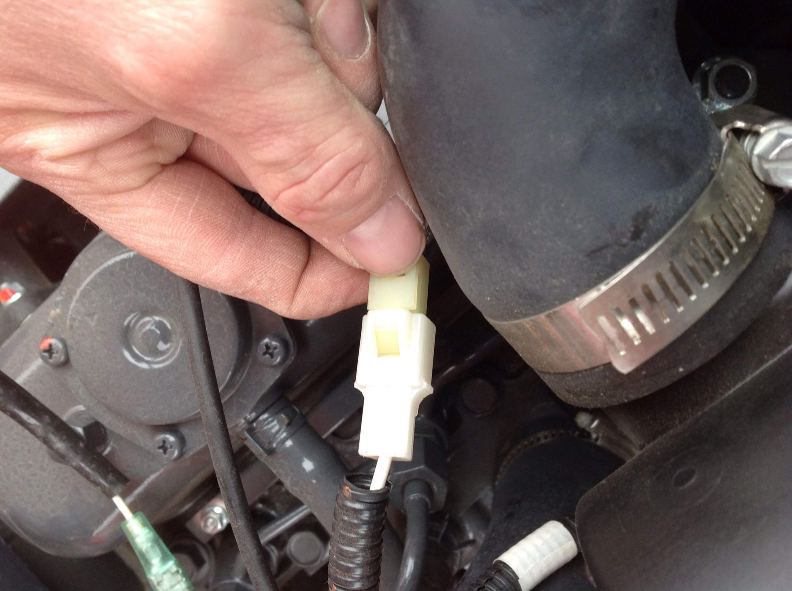

Got it figured out.
After reading Dave's (volfandt) 2010 post on the MTT Kubota SCUT forum, and not seeing any fuses blown, I started thinking (finally) that perhaps some other electrical issus akin to a blown fuse might be causing it. I started tracing the wiring harness and connections and found a seperated plug (see photo). That was all it was. I assume that when it was assembled, the plug lock had not fully engaged and while it was shaking away at idle, it finally shook lose.
The BX is working again!
Interesting that when it is under warranty, I don't engage my brain, thinking first that it must be some fatal flaw - get it back to the dealer and let them fix it. Obviously I need to settle into ownig this thing and get used to working with it, instead of just sitting on it, driving it around, and expecting it to take care of itself.
Thanks to all of you who responded. I'd have wasted a day if it wasn't for the information available and advice offered on these forums. Nice to know that you are not alone with your BX, and that folks are so willing to give of their time to help.

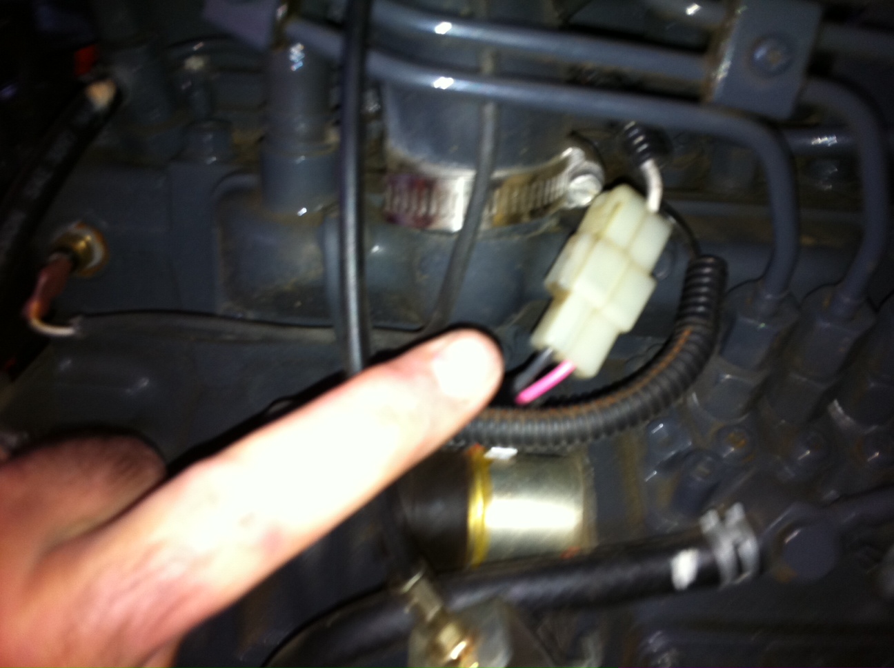

Man, you guys are the BEST!!! My 2670 just did this today. I thought "great I know what this is!! Ill fix it in a jiffy." I was worried when all the fuses were fine. I went on here and Presto!! I found the clip but it was on top of my engine. image.jpg
