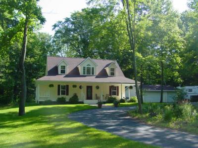

Also, here is a pic of the side yard of the new house.

I just looked at the picture of the house. Nice looking and the grounds are well kept. You must have gotten a heck of a deal on it, since the builder didn't own a level. /forums/images/graemlins/grin.gif /forums/images/graemlins/grin.gif /forums/images/graemlins/grin.gif

Yeah, I think the house is so slanted in that shot I will be afraid to set anything down on a table for fear it will wind up in the ravine! Went to the dealer today and found out that the box scraper is $377, so not bad at all for taking care of the driveway! I'm having serious thoughts about the 23, just have to pinch the pennies and see what I can come up with. He has one in stock, and can deliver the day we move in! Although, I think I had better wait until the day after. I don't think the wife will like it if I am mowing the lawn while there are still boxes to be unpacked. He also had some fancy mower blades that he says all the guys are using around here instead of the mulching kit. He said they cut the grass pretty fine and do a good job with the leaves to, so I think I'll start with those. So right now to recap the standing order is the 23 (maybe 2230), 60"MMM, front blower, 48" box scraper, tiller and the free air conditioning! Now all I need is a delivery and some seat time! I can't wait, haven't been on a tractor since my aunt and uncle literally "sold the farm" 15 years ago!

I keep forgetting that I can add files, here's the front view of the house, and the little bit of drive that is actually blacktopped. I notice the house is crooked the other way in this one!
