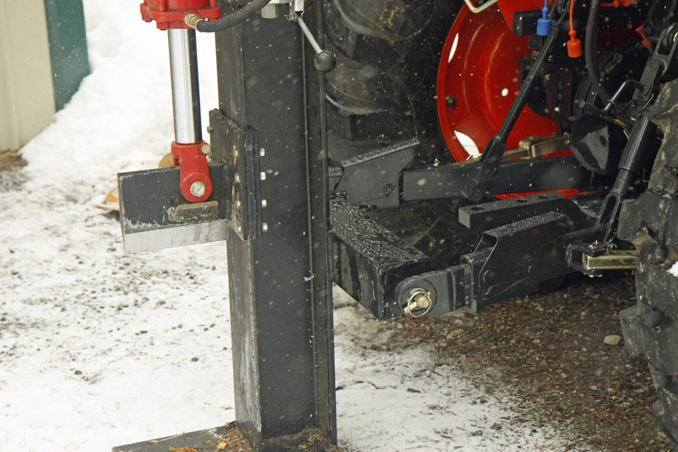

GRSThegreat- the rails get a little stuff in them but I left about a 1.5 inch gap between the rails and the end plate so that it just gets pushed out. I have found more of a problem with some wood getting wedged under the wings of the wedge. It doesn't seem to bother anything so I just leave that little bit of wood in there.
JJ- Thanks for the info. Looks like I am ok using the 1/2" hose. I think I am going to use one size larger elbows however and adapt it back down as needed. If only they made 5/8" hydraulic hose. seems silly to do all this and then use three 1/2" poppet quick couplers. but since it is for such a sort space in the line it probably makes little diffrence.

There is some logic about QD's, that say that QD size should be one size higher that the hose size to compensate for the reduction in flow through the QD itself.
For example, the 1/2 hose may pass 12 GPM, but the 1/2 in QD may only pass 10 GPM, so a 3/4 in QD would be call for in this example.

That's exactly what I'm saying....
As I sit here at work I'm measuring a new Gates #8 hose end at the inside diameter where it slips in the hose and it's .390".....and that's before crimping
#6 hose end is .270" ID
#4 hose end is .157" ID
these measurements are BEFORE crimping.....so they'll shrink a little
the #8 (1/2") hose is measured .500" ID
No way of getting around it, it's a fact of life, that's why the gpm ratings at 20 fps of velocity is lower than the same pipe sizes.....

Can I get a little advice. I have a MF 165 for which I am building a 3pt log splitter. Today I bench tested my cylinder and it worked both ways a little slower than I had hoped(17sec out 14sec in) but perhaps that is being caused by my plumbing. Here is how I did that and I would like to know if this is correct and if not what do I need to do to correct it. I first tied back the control handle on my remote control valve. I then attached a line to the pressure side of the remote QD and attached that to the in port of my valve. I then plumbed the out port of the valve to the other QD line.I am using 1/2 line on all and a 2 spool valve(only using one spool keeping the other in reserve for a log loader later) cylinder is 3.5in x 24in with 1.5in shaft. My tractor has a small valve on top of the lift cover plate that simply says 3pt-aux when placed in aux the remotes work. That is how I am thinking of running the splitter. What say yea.
/ New built 3pt log splitter #36
165massy : that seems reasonable. I have done something similar when I did not have power beyond available. I am going to guess that all the resistance of two valves in series and the plumbing and quick connects all adds up to slow down your cylinder.
Here is what I say.
3.5 in cyl bore
1.5 in shaft
4.5 GPM
Extend speed should be 13.33 sec
Retract speed should be 10.9 sec
Was your tractor running at max? 4.5 GPM is the hyd pump GPM flow at max engine speed.

No that was at flat idle my RPM\PTO gauge is working but missing the needle I need to order a new one just haven't had the extra cash so I didn't want to rev the engine and not know what RPM I was at. I think that speed will work for me if it will give me enough pressure. I can stand a little slower speed and use a 4 way wedge if it will push the wood through. I am going to try pushing the piece first and then the wedge to see which works best but I am betting a stationary wedge will be much better. After i find out for sure then i will know where and what design of work table and log stabilizers I will need.
