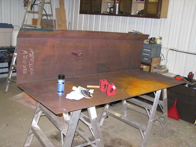

Just starting this project so far I am into it for about $500CDN for steel and some breaking / shearing.
I will post more pics as I go along

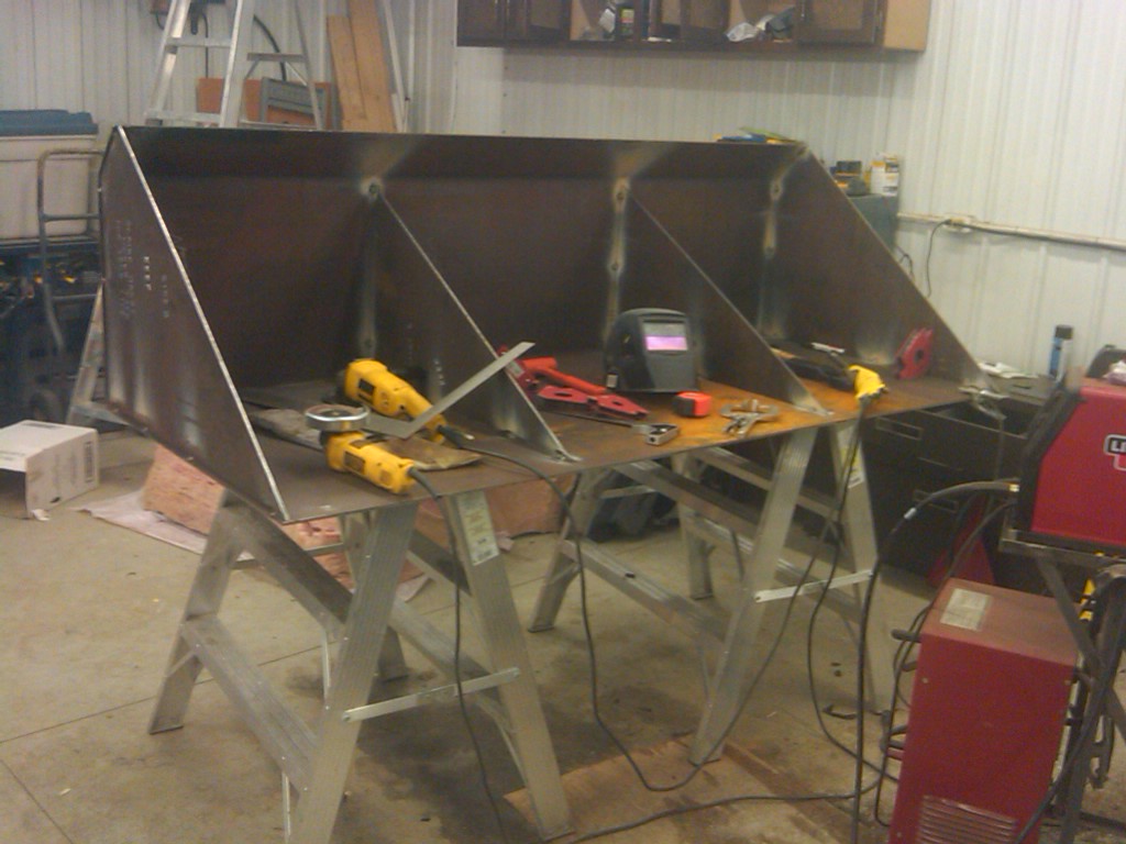

Well I have the basic shell tacked together today, now its time to burn lots and lots of wire.
Once this part is fully welded I will put an 8 inch wide back plate at 45 degrees over top of the 90 to prevent twisting.
Then I can do the mounts

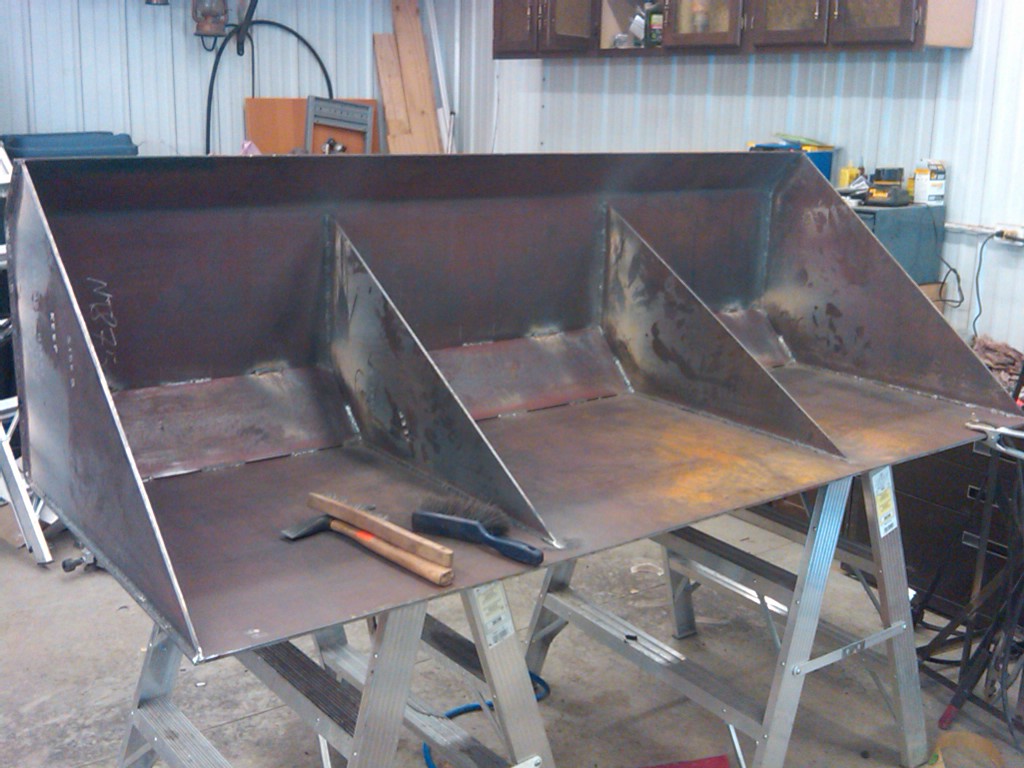

Well all the base welding is now done so the next steps are:
1. Re-inforce front edges
2. Install loader brackets
3. Drill for cutting edge
4. Weld on waer skids
5. Bit of grinding and touch up
6 Prime and Paint

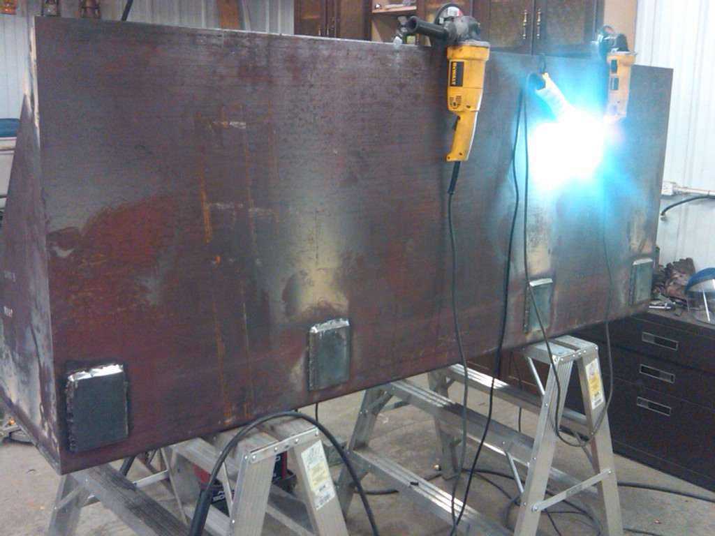

Cut and tacked on the front corner stiffeners and four wear plates on the bottom of the bucket tonight.
Start the brackets tomorrow

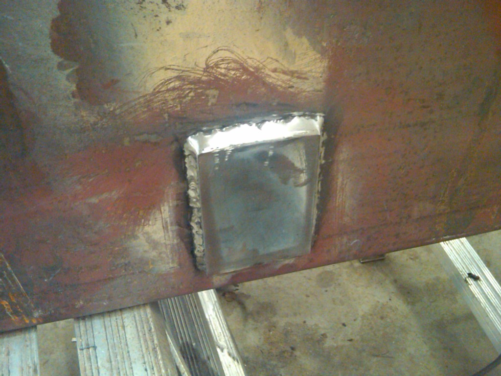

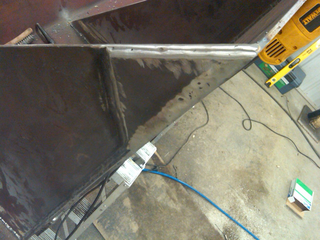

Finished welding on the wear pads on the bottom of the bucket today and then finished welding and grinding one of the front corner stiffeners.
Will throw some pics up.
Tomorrow I will finish the other stiffener and start marking out the brackets. Need to go buy a 1-1/8 drill on my way home from work tomorrow too.

Yeah I know my vertical welds leave something to be desired....Sorry to all the real welders
