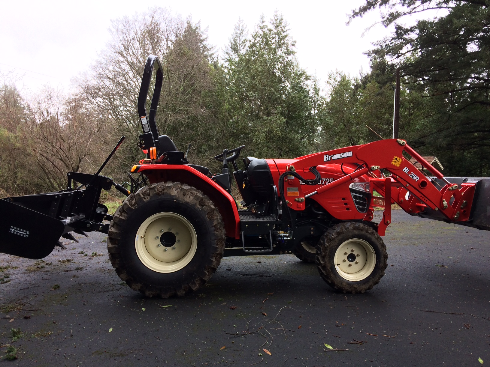

Went over to the dealer where I bought my 4020R to buy a canopy for it and he say's "come here, let me show you the new series Branson just came out with". There it sat, a new 3725. He started showing me all the "upgrades" on this new one. Pretty darn nice :licking:. Told him that figures, you sell me a new tractor a couple months before the "new, improved" model shows up...(seems like I'm always "that guy") Well at least he gave me a really good deal on the canopy. :thumbsup:

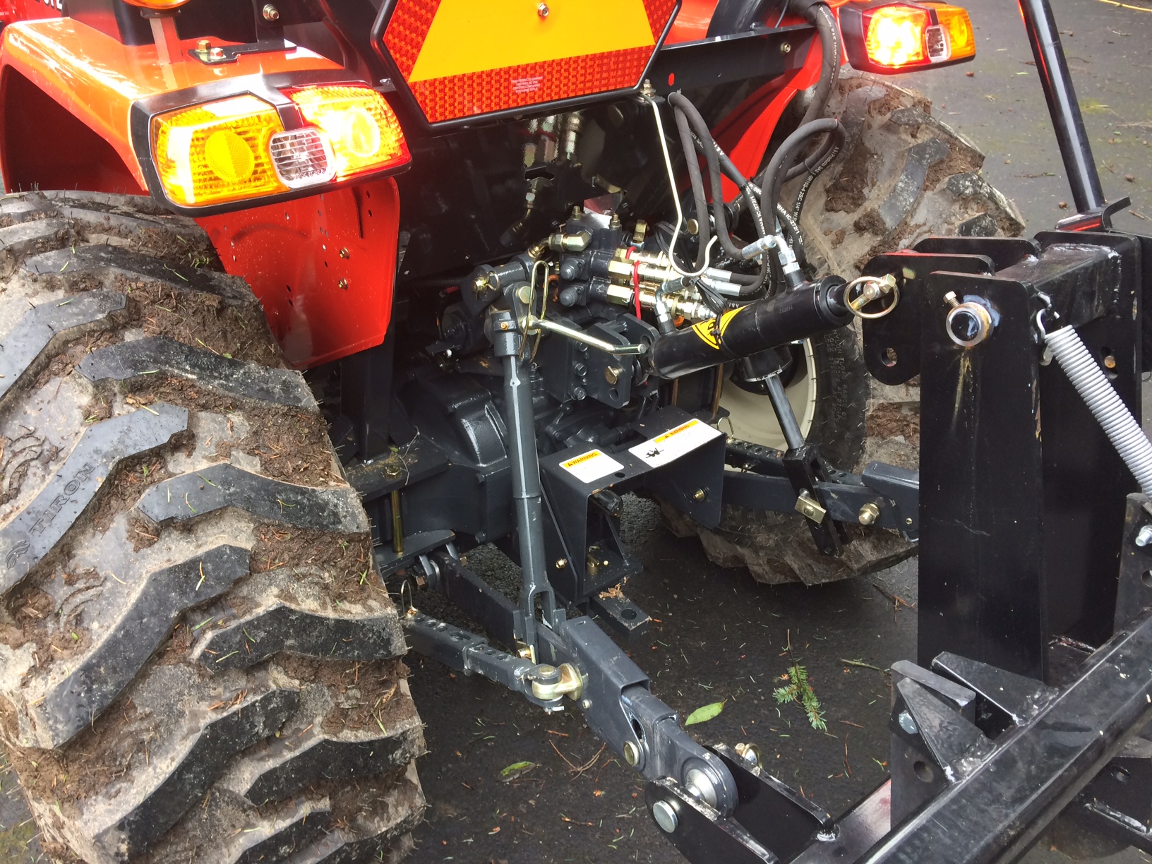

Nice setup you have there. I need to do that top & tilt to mine. While we were talking about the rear remotes on the new tractor, (your setup) I asked about doing mine and he recommended to me to go from the banjo bolt underneath (behind yours) and take that line to the valve body set on the fender instead of from where yours (and every other Branson he had there with rear remotes came from). Not sure why that would be. More investigating to be done. Good luck with your new tractor, it looks great.

The Branson factory remotes have a complicated Rube Goldberg mechanical linkage from the levers to the valve bodies above the PTO. Each joint in the mechanisim has a bit of play or friction. So the feel at the lever is not as crisp as with a lever directly bolted on a valve. Also the two levers have completely different linkages and thus different travel and feel. The levers themselves are buried down beside the seat and the position control lever interferes with them. I think they made the position control lever short and farther back so it doesn't interfere with the shift lever on a gear drive tractor. I keep getting a remote lever up my sleeve when reaching for the position control when it's fully raised. I can deal with it but I want to make extensions for the position control and factory hydraulic levers to make them easier to use, and see if I can shim some of the pivots in the linkages to reduce play. It's not a big deal but an aftermarket setup on the fender, with levers bolted directly to the valves (like my dealer installed 3rd remote) would be better.
I got to use the top 'n tilt with the box blade the other day. It's so cool! The tilt let me level out a sloped section easily.
I already caught the top of the loader bucket indicator rod on some brush. Fortunately I noticed before I damaged it, and more fortunately it wasn't poison oak (I was ripping up a bunch of it and I'm terribly allergic). Maybe I can make a guard of some sort.

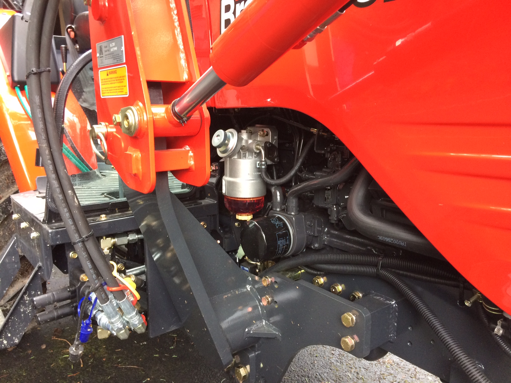

From what I'm seeing now in the new 20 series they are the same frame as the 25 series, if you look at the 2016 20 series models they are much thinner. So I'm guessing they are going to be the same from her on out. If you look at the rear 3pt links both sides are adjustable, the 3rd link is larger, much larger fuel filter water separator system. On the cab models the cabs are quite different. Much more head room.

Is it just me, or are the Branson rear remotes extremely difficult to fine adjust. If I try to extend the ram a bit, it requires an extremely fine touch to find neutral again without over-positioning and going back the other way. I don't dare position the rear remotes on the fly because of this. I stop and do it very carefully.
/ New Branson 25 series #34
Same here. Would love some solution to move it slower.
/ New Branson 25 series #35
Mine seem to have two positions- slow and fast. There's more in between that but there's not much lever motion between them.
I'm thinking of adding restrictors to the top cylinder. It's much smaller diameter than the tilt cylinder so it responds faster. Sometimes too fast- I've accidentally slammed my wood chipper into the ground a couple times.
/ New Branson 25 series #36
Eric, good idea on the restrictor to slow down a smaller cylinder. I bet you could buy a restrictor, even an adjustable one, via Surplus Center for not much. I've also seen guys just braze or weld a fitting closed and then drill it and test until they get a good speed. I think they make restrictors that only restrict in one direction, or both directions. For not much money, you can really fine tune your hydraulics. Restrictors build a ton of heat, but since these cylinders aren't moved much I do not think it becomes an issue. Another idea is a 5000 psi needle valve. That allows fine tuning, but it is probably an unnecessary adjustment.

Future mods include adding a pyrometer to monitor EGT. I've heard that running at 800 degrees EGT is what is necessary to maintain a clean unplugged DPF. So I would like to actually monitor the EGT and see what is happening to adjust the way it is operated as necessary. At first I was thinking that drilling and tapping the manifold was in the cards, but upon inspection there is already a tapped hole with npt plug in the middle of the manifold, ready to go.
