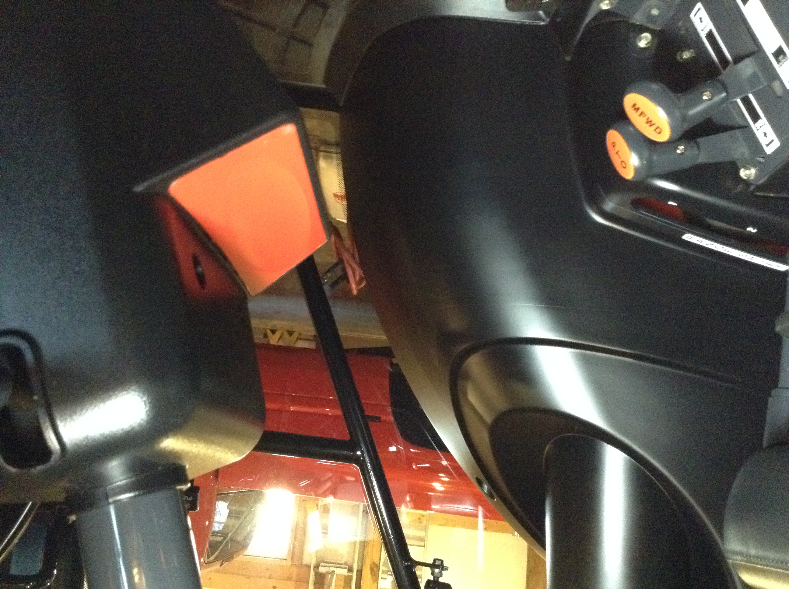

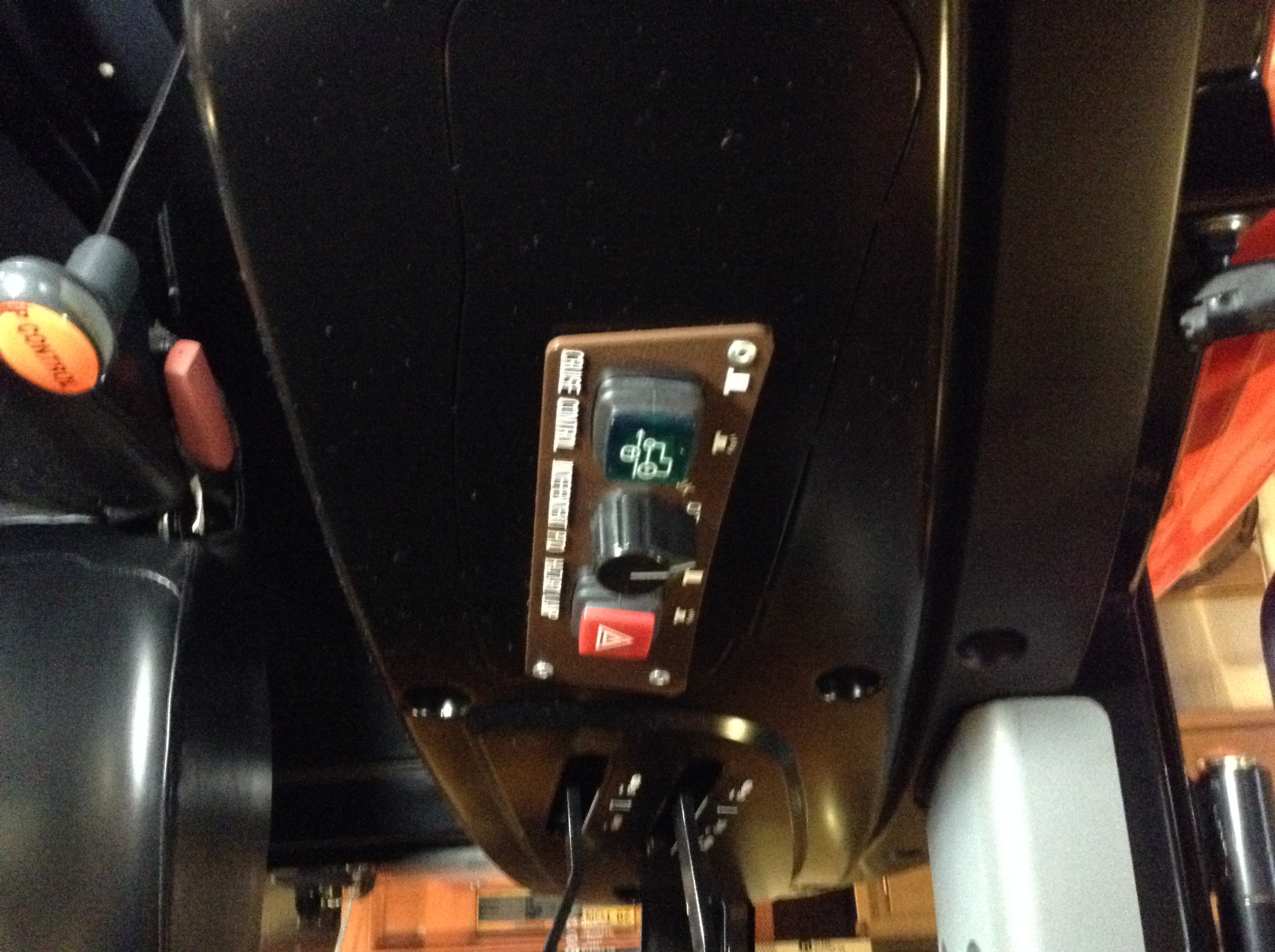

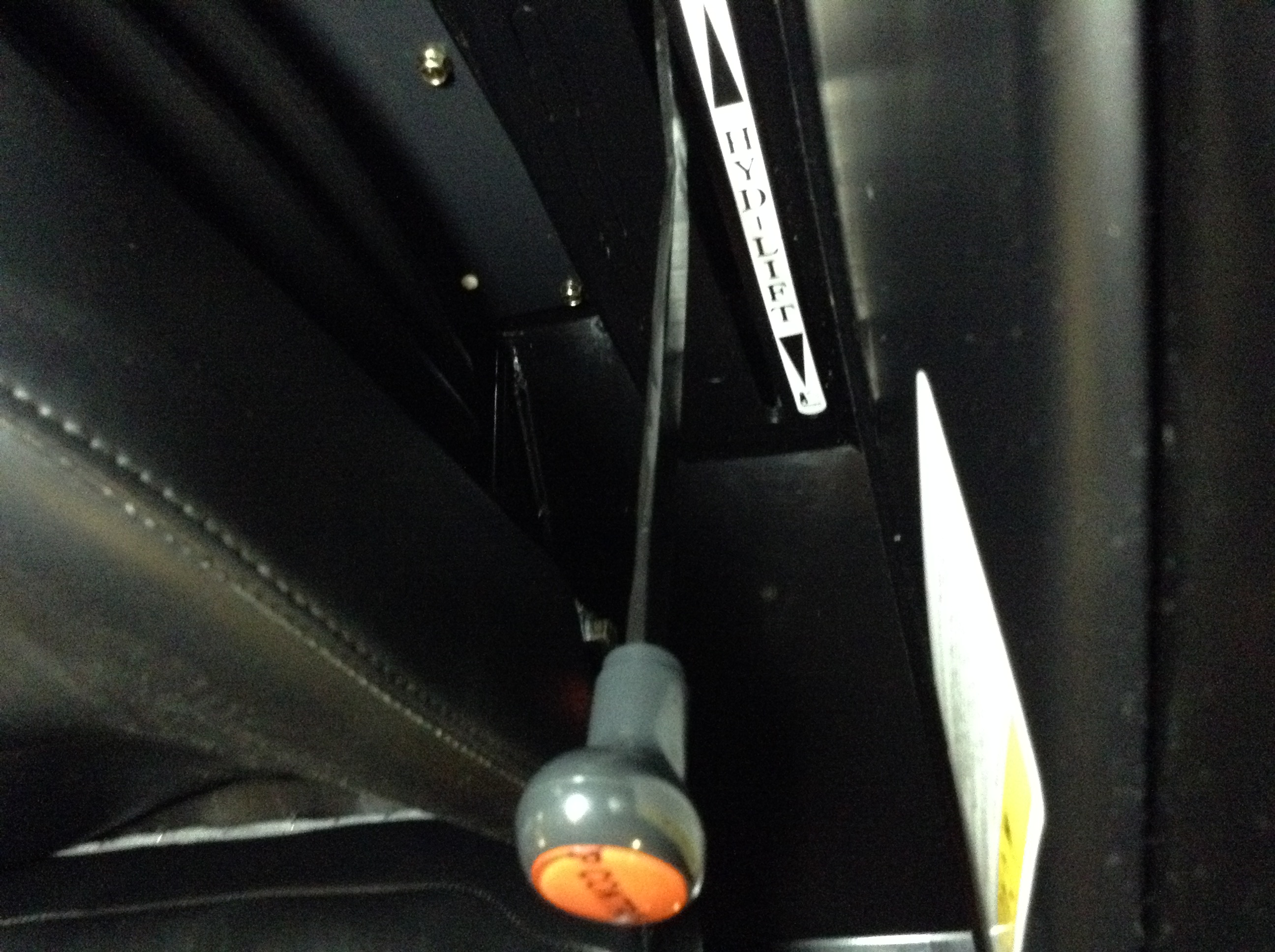

I got tired of the pto and cruise button being below the steering wheel. I moved it over to the right side where the knockout in the plastic by the rear hydro controls are. Got tired of bending down and pushing the button when I was bush hogging a 22 acre field I have. Have several draining ditches I have to drive thru and got tired of leaning over and picking up the three point to keep the hog from scalping the ground so I took the three point control lever off and extended it so it comes to the top of the seat. Just little things could have been done to make it more comfortable to operate these tractors. Glad to see they are making the changes.
During my test drives I noticed that it's a bit of a reach to get to the 3pt lever. It's no different on the 25s. When I'm brush hogging I often keep a hand on the 3pt lever so I can lift the mower quickly if I hit a rock. I'd be interested to see your extension.

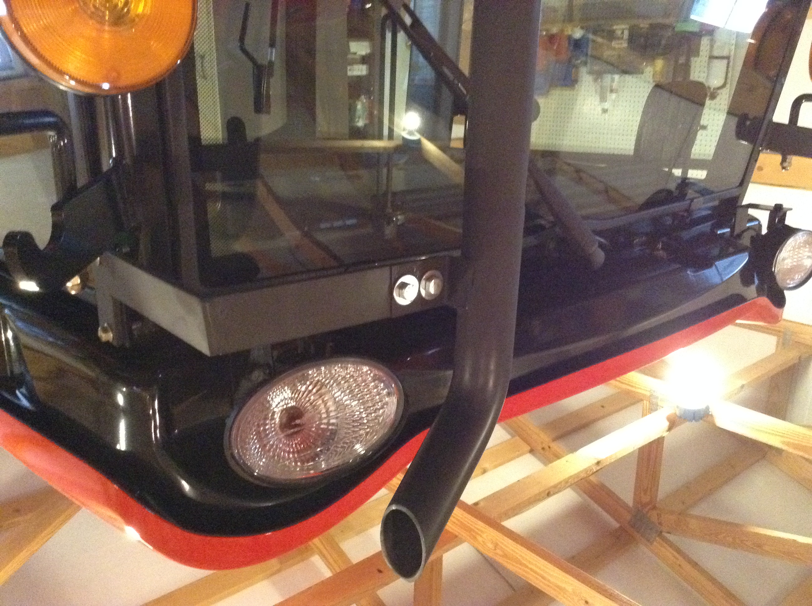

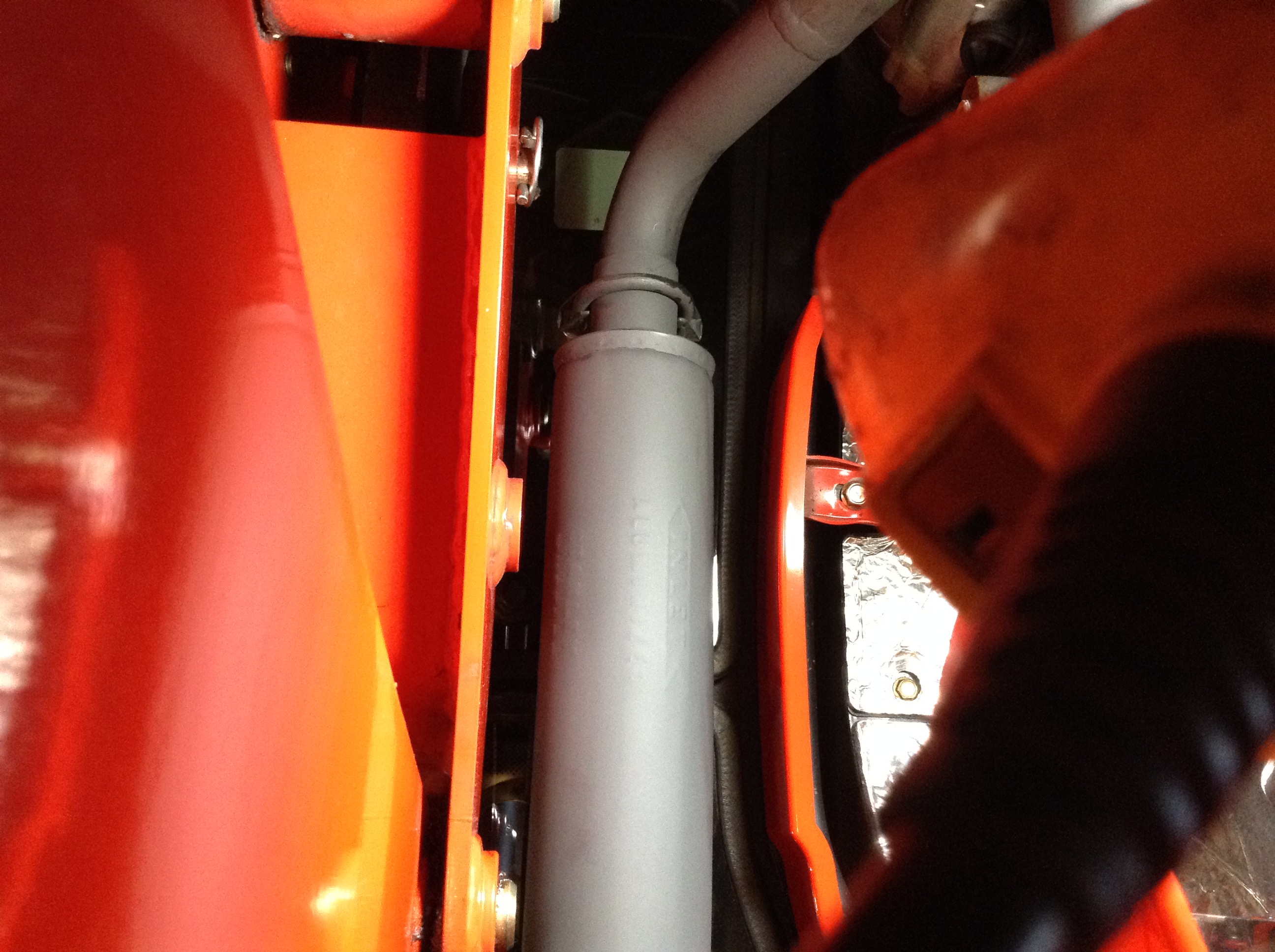

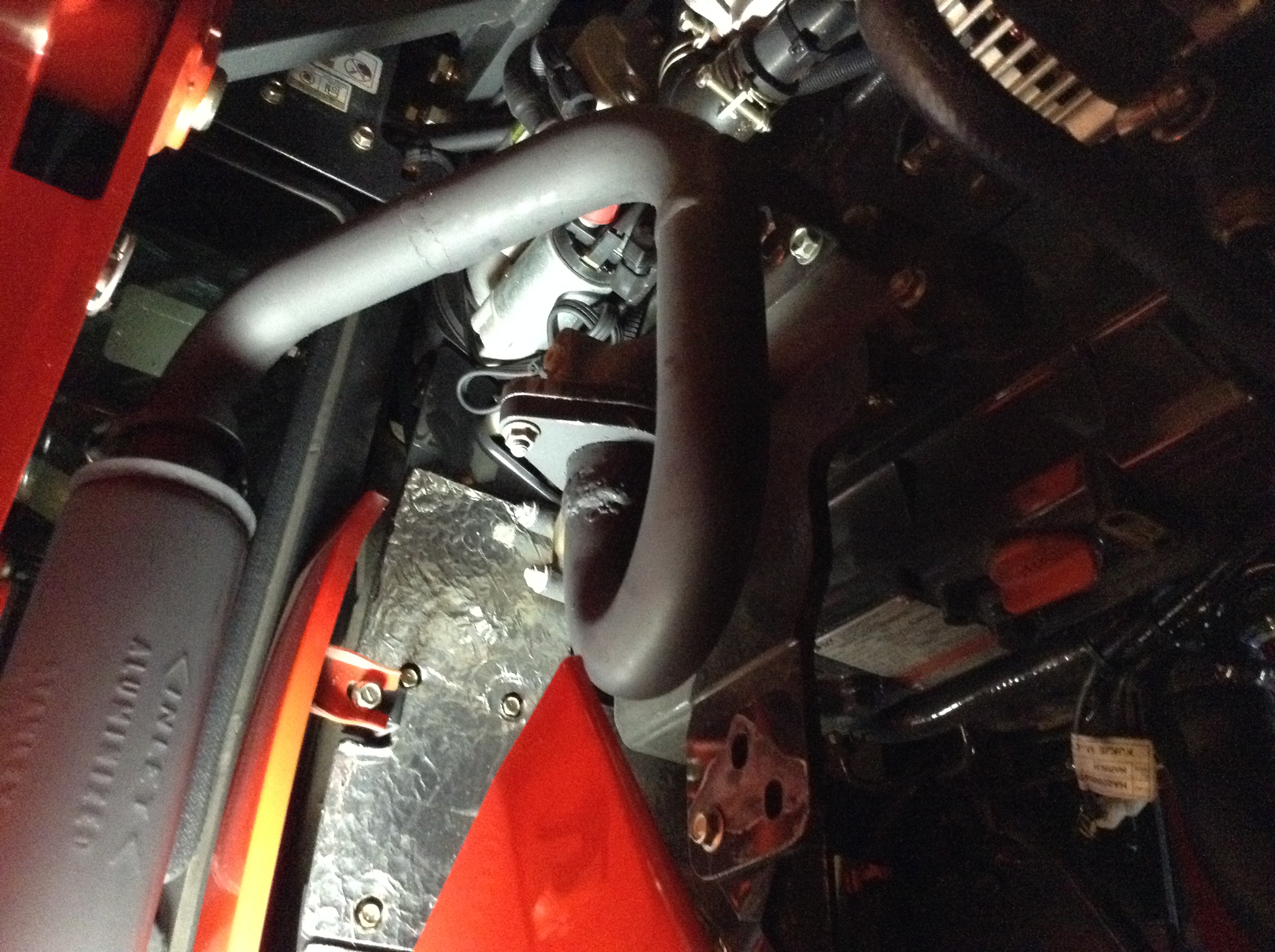

Don't know if you can make it out very good took photo with a iPad.

The 3pt and switch mods look iike they could have come from the factory. Is it quieter with the external muffler and no DPF?

Sorry about the pictures being twice but was first time posting pictures and really don't know what I'm doing.
It really not that much louder. You can hear it for sure. Wouldn't be as noisy if it had a turbo. I'm use to noise with those old tractors I spent so much time on. But it's not as bad as those old ones for sure.

Nicely done.

Yes, nice work. The direction the stock exhaust blows, it is always blowing chaff into the radiator. Don't know what Branson was thinking when they designed that. I am almost waiting anxiously for my DPF to plug so I have an excuse to re-route things:) What prompted you to relocate the PTO Speed switch, cruise control, and hazard flasher switches?

When bushing pasture or fields, disking, raking hay whatever the fields are long and every time I would have to set the cruise or disengage it I would have to lean down to do it. Same as 3pt was way down on the side of the seat had to reach down beside the seat to let it down or raise it. Made it so everything was in reach while sitting normally in the seat and all within reach. Makes it all the more enjoyable to operate the machine. Someone said the new 25 series have the controls for pto and others relocated now too.

Kentuckyfarmer I'm going to have to do your 3pt lever mod. It's too low and the travel is short.
Is there an adjustment that limits the 3pt travel? It doesn't go very high.

I didn't see any type of a height adjustment. Maybe some one else knows of something I don't. More knowledgeable people on here than me. Yes makes a world of difference with that 3pt extended and more travel in the handle. We need some pictures of the tractor to wee what we are missing out on. Good luck with your new purchase.

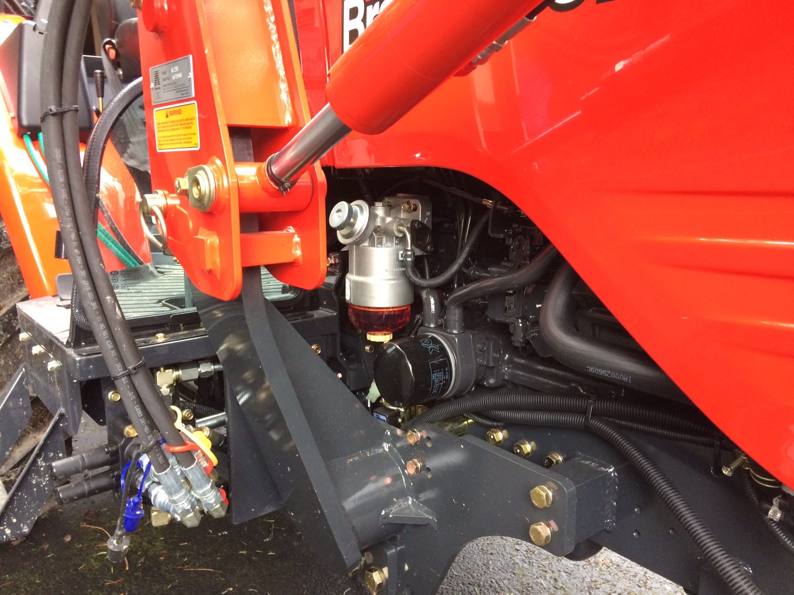

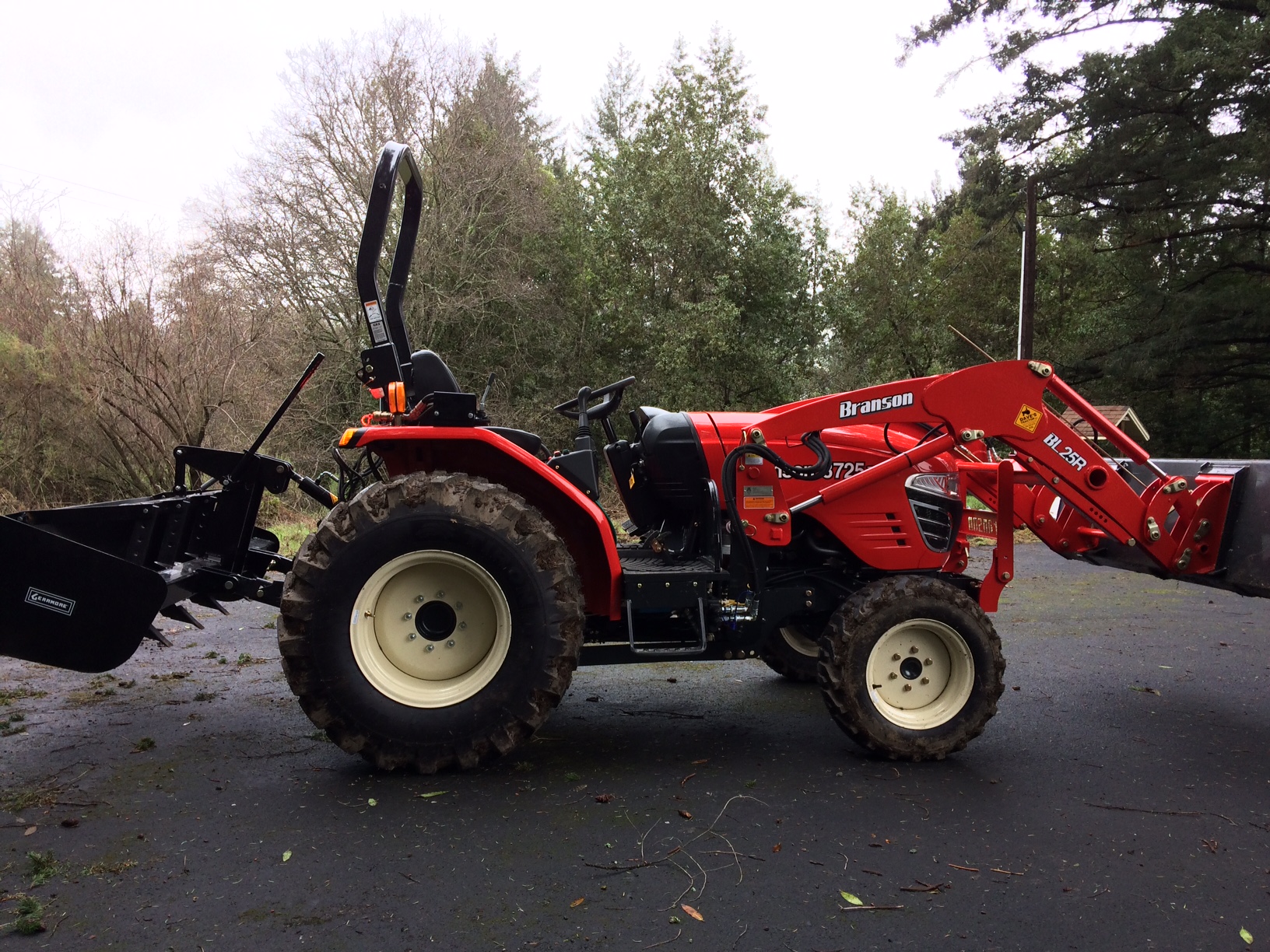

Finally got a day when I was home and the light wasn't too bad. It's been raining a lot here. Pictures show the 25 series' left side adjustable 3pt link (I see I left the handle lock unlocked) and two factory remotes. I got a dealer added top and tilt. There's a larger fuel filter, dashboard that I think is a little different from the 20 series, and the moved PTO, cruise and 4-way flasher switches.

Nice tractor Eric... congratulations.
