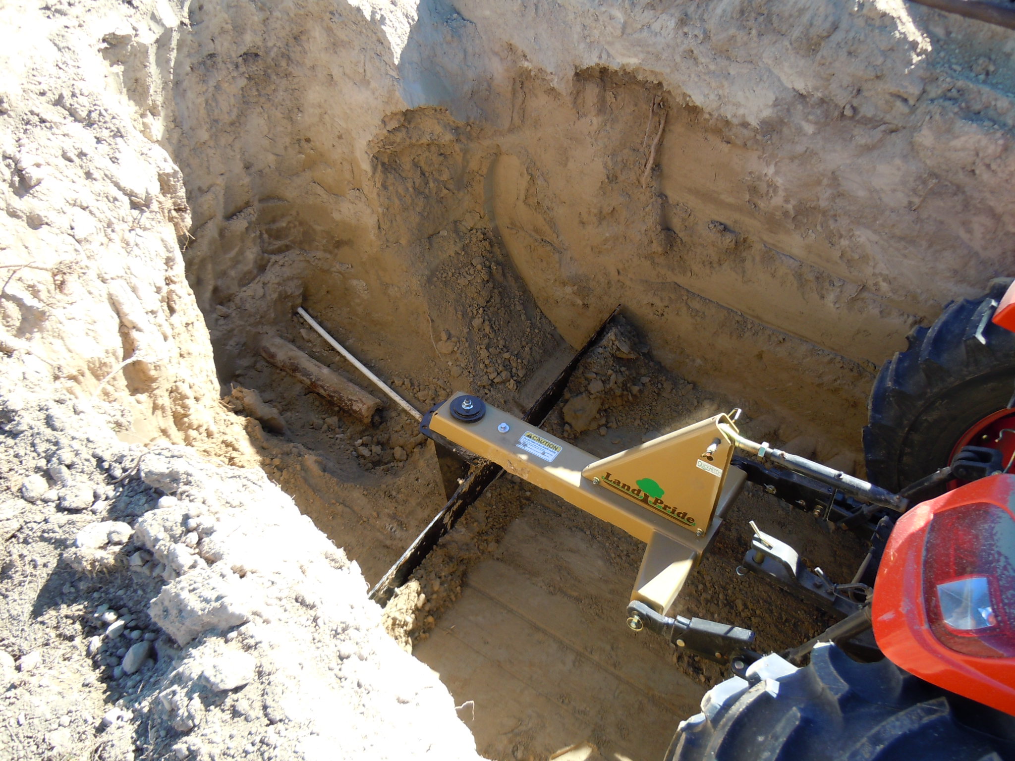

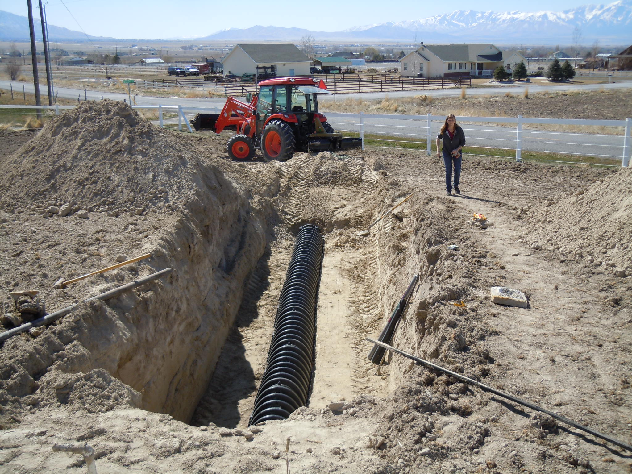

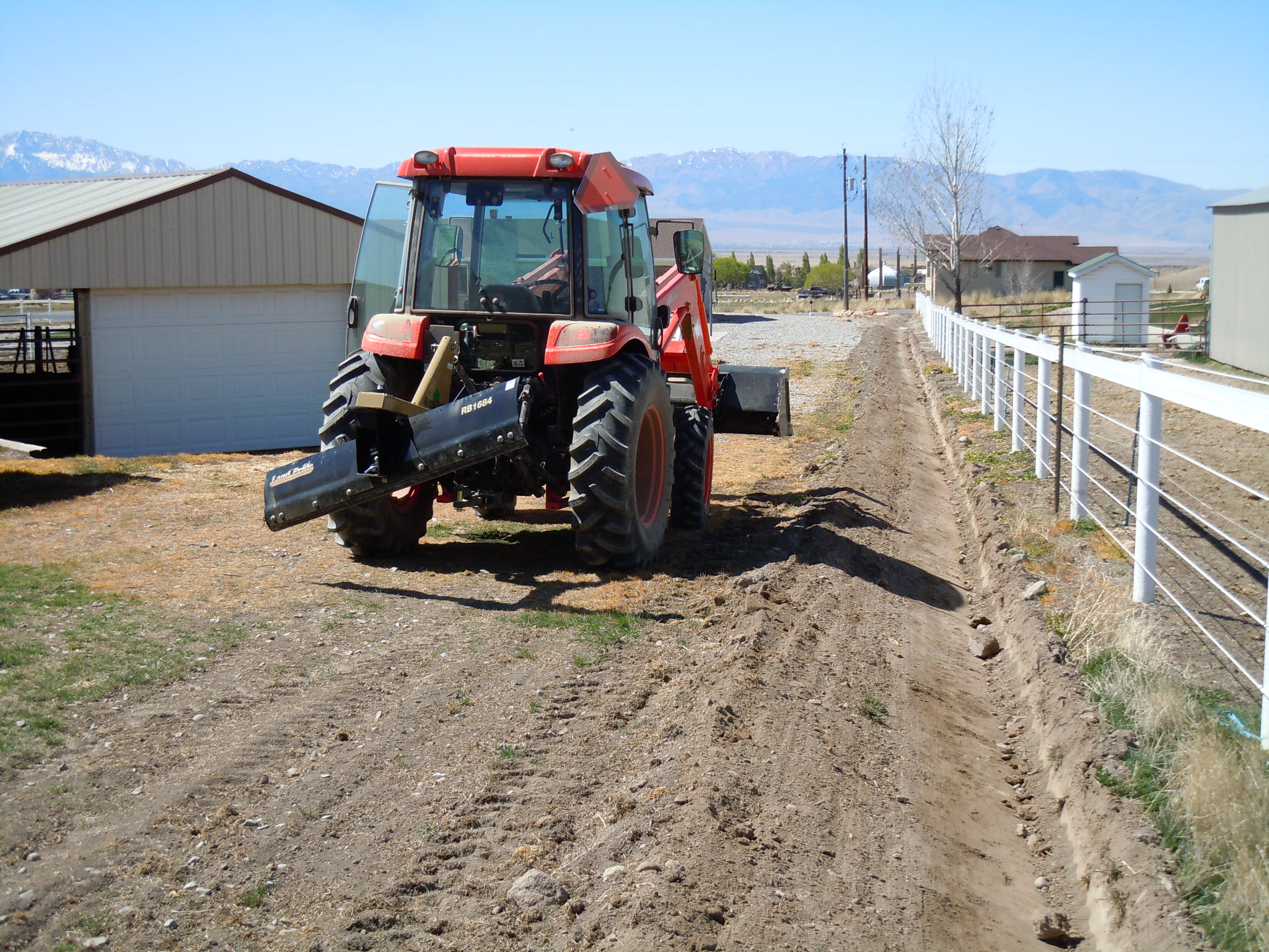

I have a Land Pride rear scrapper and have been happy with it. It is the lighter model but does what I need it to do.
I have not needed it for snow removal yet, but as you can see from the picture it keeps my little run off ditch clear.
I used it to level off my leach line area, worked great.
View attachment 453772View attachment 453774
I would be really careful with that blade. Your tractor is probably 8000# + loaded tires if you have them loaded. And big R1's, you have the ability to destroy that blade.
Lucky its a light 300 pounder and dont dig in much at all. But if you snag something.....
It would be great for snow, but if I were you, I'd either sell it while its still in good shape and get something bigger, or keep it for snow only and get something bigger. You should be in at least a 35 series blade. Or similar from another MFG.
