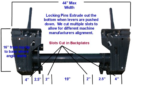

When I measure across the bottom end of the loader arms on the LA504 on my tractor - I come up with (approximately) 31.5 inches
I have the Kubota pin-on style QA on the loader, if I measure across that (outside edge to outside edge) - I get approximately 32.5 inches.
Looking at the image of the dimensions on an SSQA (from this page: Will it Fit My Machine)
It basically goes like this for the dimensions on the SSQA: 44 inch max overall width.
Then the spacing for the lockdown holes is: | - 4" -| 2.5" |-2"-| ...........19" .............|-2"-| 2.5" |- 4" -| (totals up to 36")
Kubota LA504 FEL arms position (approx): ........| -- |.........................................................| -- |
There are slots at the 4" interval and the 2" interval. The standard lockdown position is at the 4" spot - the 2" spot is for older Case skidsteers if I understand correctly.
So the problem is that basically the LA504 loader arms - come down right in the middle (sort of off to one side actually) - on where the slot is for the lockdown
pin on the SSQA. Looking at the pics from the B50 series brochure:
http://www.toplinetrailers.com/documents/B2650B3350.PDF
It's sort of hard to tell where the lockdown pins are physically located - but it sort of looks like they're actually located right in front of the loader arms. Which means the Kubota might have lined up their lockdown pins - on the standard location. Hard to tell from the pictures. This is all just speculation - hopefully the parts come in soon and I will know exactly what's going on here.

Thanks - just looked at that. It's hard to tell - because the video is shot from the side , but it does look as though the lock-down pins on the QA - are pretty much in line with the FEL arms . That is what Kubota would have to do - to get the lockdown pins to lineup with the spec'ed position of the slots
along the lower edge.
I edited my response #124 - my attempt at using text to illustrate the line-up between the LA504 loader arms and the SSQA lockdown slots - was not successful on the first try. Hopefully this is better.

That's awesome. So it looks like the lock-down pins are located just outside the FEL arms. Which means (if you go back to the alignment picture I put in post #124) - that the lock-down pins should align with the standard location of the 4 inch slots from the SSQA standard.
looking at the video a few times and then going back to the SSQA measurements and trying to compare and I can't see anything that stands out that looks like it might not be standard.

Uh... they are wrong. To someone with an untrained eye, its very easy to look at it and assume but its too narrow.
We'll probably look at building blank for the coupler or a filler plate to see if we can make it work... that will be a winter time project.

That was my thought too after seeing some of the pics - it looks like the lockdown pins actually line up with the spec on where the slots are - but the coupler itself (the part that's on the FEL) - is narrower than the SSQA standard - so it would be "floating" if you tried to hook it up to an attachment that met the SSQA standard.
Of all the potential problems - at least that is an easy one to fix. If Kubota had no met the standard in some other dimension - that would have been a harder problem to adapt to.
